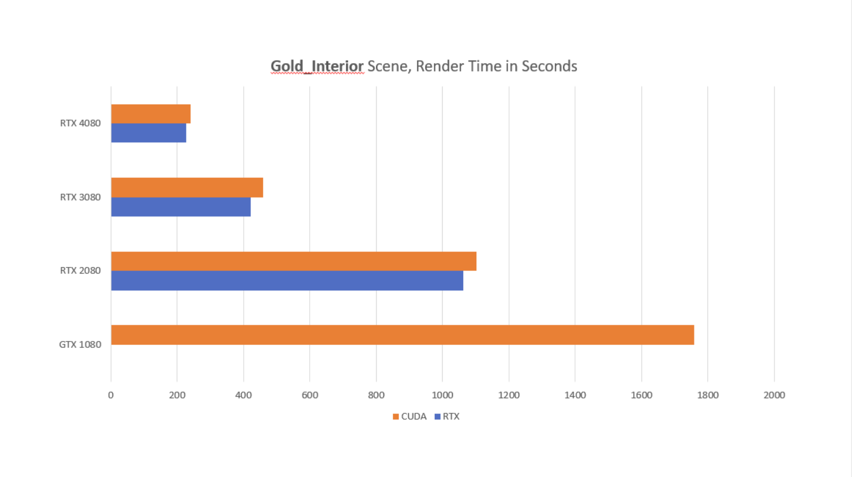

Test 1:
Test 1 scene preview
Test 1 performance results

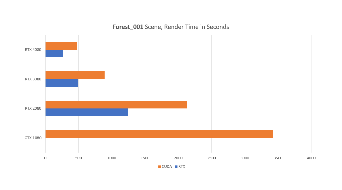

Test 4:
Note: this scene includes thousands of leaves and grass objects, and has all shading baked to textures, hence showing a big boost for RTX mode. In most cases, CUDA mode should be close to RTX mode in performance.
Test 4 scene preview
Test 4 performance results
