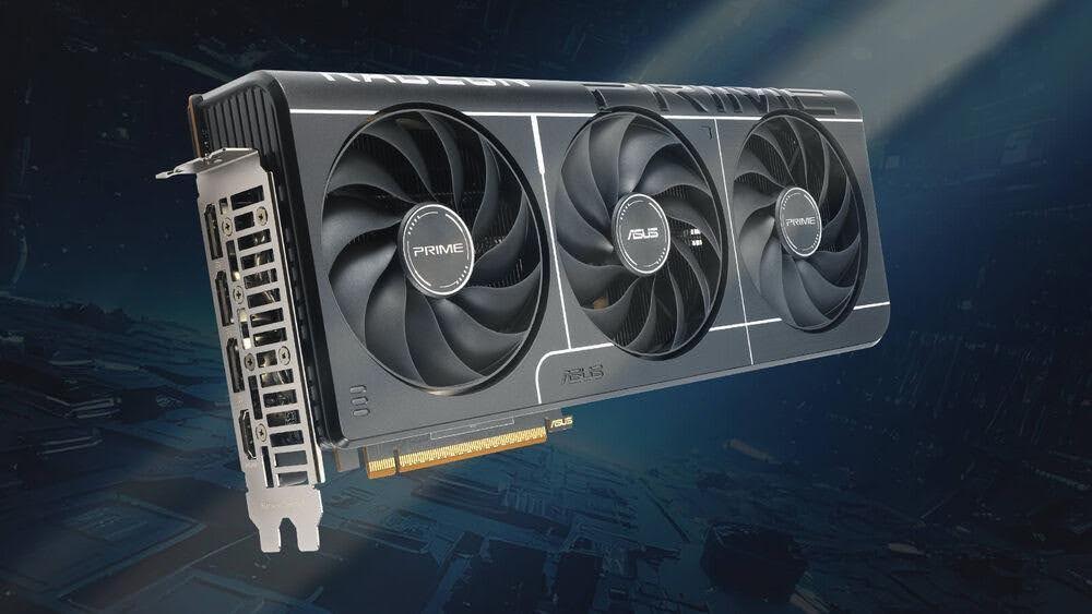

Meet the Radeon RX 9070 XT
For this round of testing, we have focused on the AMD Radeon RX 9070 XT, a recent consumer GPU that sits in a particularly interesting place for GPU rendering. AMD lists it with 16 GB of GDDR6 memory, a 256-bit memory interface, and up to 640 GB/s of memory bandwidth. AMD announced the card at a $599 SEP, although retail pricing varies by board partner and region.

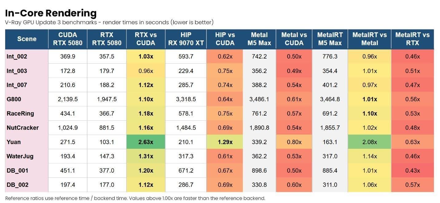

Across the current scene set, AMD performance is solid overall. Most scenes rendered without issues, output matched expected results, and the RX 9070 XT delivered competitive performance for a 16 GB consumer GPU.
For in-core scenes, the RTX 5080 remains ahead in most cases, followed by the AMD RX 9070 XT with very respectable performance.
A few key observations from the broader comparison set:
  • On AMD, HIP delivered the strongest results in the current dataset, while HIPRT remains under active evaluation.
  • On NVIDIA, RTX is consistently faster than CUDA in the tested scenes.
  • On Apple, MetalRT is sometimes faster and sometimes slower than Metal, which suggests that more tuning and evaluation are still needed there.

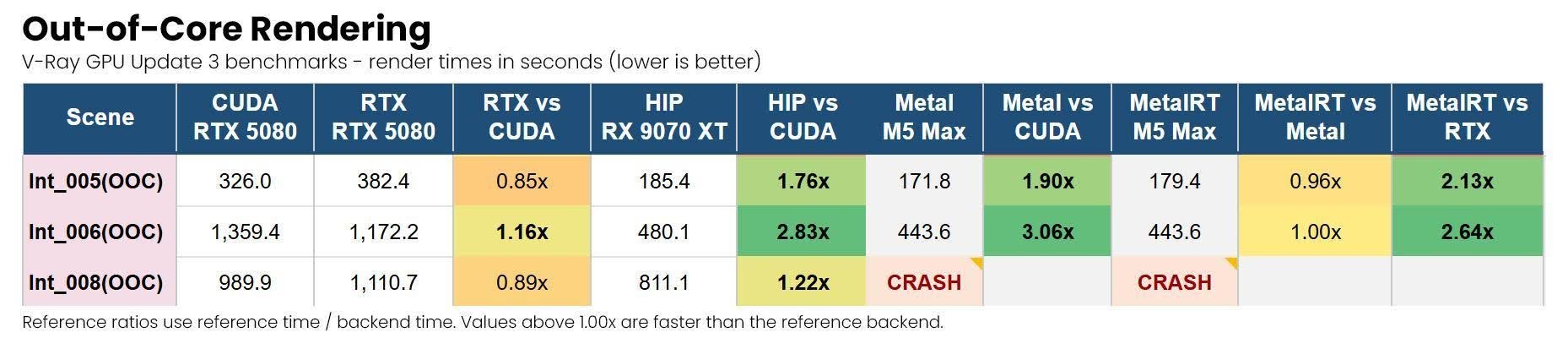

Why Out-of-Core Rendering Matters

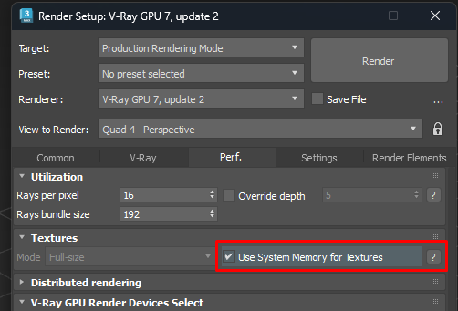

Out-of-core rendering is where the AMD story becomes especially interesting. In V-Ray GPU, the Use System Memory for Textures option moves texture memory pressure into system memory, freeing up VRAM and allowing larger scenes to render even on GPUs with limited local memory. This matters because many real-world production scenes are not neatly constrained to the GPU's onboard memory budget.
And this is exactly where the RX 9070 XT stood out.
In the out-of-core scenes tested here, the RX 9070 XT was not just competitive. In several cases, it clearly outperformed the RTX 5080, with the largest gaps reaching multiple times faster in the current dataset. For artists working with heavier scenes, large texture sets, or limited VRAM budgets, that is a very practical advantage.
For the Metal tests, the 16-inch MacBook Pro, that was tested, did not have enough shared memory to render the scene.
