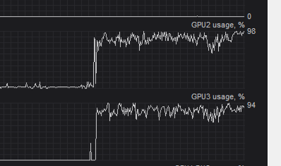

Windows Task Manager’s Performance graphs can misreport compute workloads and may default to showing 3D engine activity instead of compute usage.
As a result, it can appear that additional GPUs are idle (for example, showing 0% on GPU 2 and GPU 3) even while V-Ray GPU is actively rendering on them:
Windows Task Manager may show 0% on GPUs even when V-Ray GPU is rendering
MSI AfterBurner GPU usage graph. It accurately shows the usage of GPU 2 and GPU 3
Monitor GPU usage accurately with GPU-Z or MSI Afterburner
We recommend using an external tool like GPU-Z or MSI AfterBurner for monitoring GPU resources especially GPU usage.

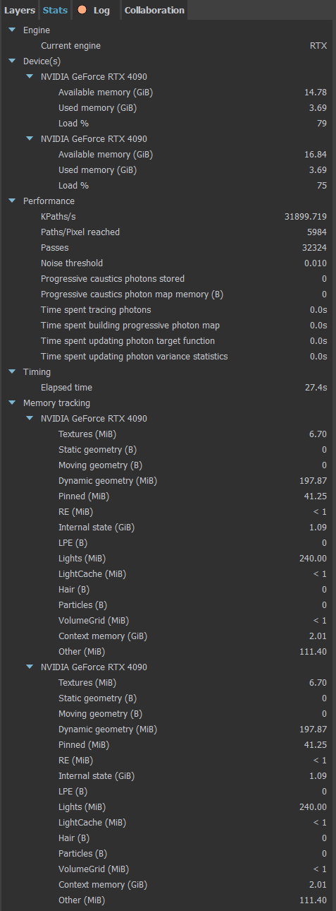

Stats tab in the VFB
Use the Stats tab in the V-Ray Frame Buffer (VFB) to monitor GPU engine, memory, and performance while rendering Interactively (IPR) or in Production mode in V-Ray 5 or later.
Note: Some stats like Load % is only available when the Sampler is set to Progressive.
Engine: Displays the current GPU engine (CUDA or RTX).
Available memory: The VRAM V-Ray GPU can use on this device. This is lower than the card’s total VRAM because:
  • Windows WDDM reserves part of the GPU memory.
  • DCC (e.g. 3ds Max, SketchUp, etc.) take a chunk of the GPU memory for the GPU connected to monitors.
  • The GPU driving monitors and your DCC (for example, 3ds Max) reserves additional memory.
  • Other open applications (e.g. Photoshop, After Effects, Nuke) also take a chunk of the available GPU memory for a GPU device.
Used memory: The amount of VRAM V-Ray GPU is using for the current scene. The RTX engine typically uses more VRAM than the CUDA engine.
Load %: Current GPU utilization; available only when the Sampler is set to Progressive.
Performance: Useful metrics related to progressive rendering performance.
Timing: Render time after scene compilation.
Memory tracking: Detailed breakdown of GPU memory usage by scene elements (textures, geometry, etc.). Note: when using "Use System Memory for Textures" Checkbox the stats tab might show incorrect data for GPU memory. This will be improved in the future.
