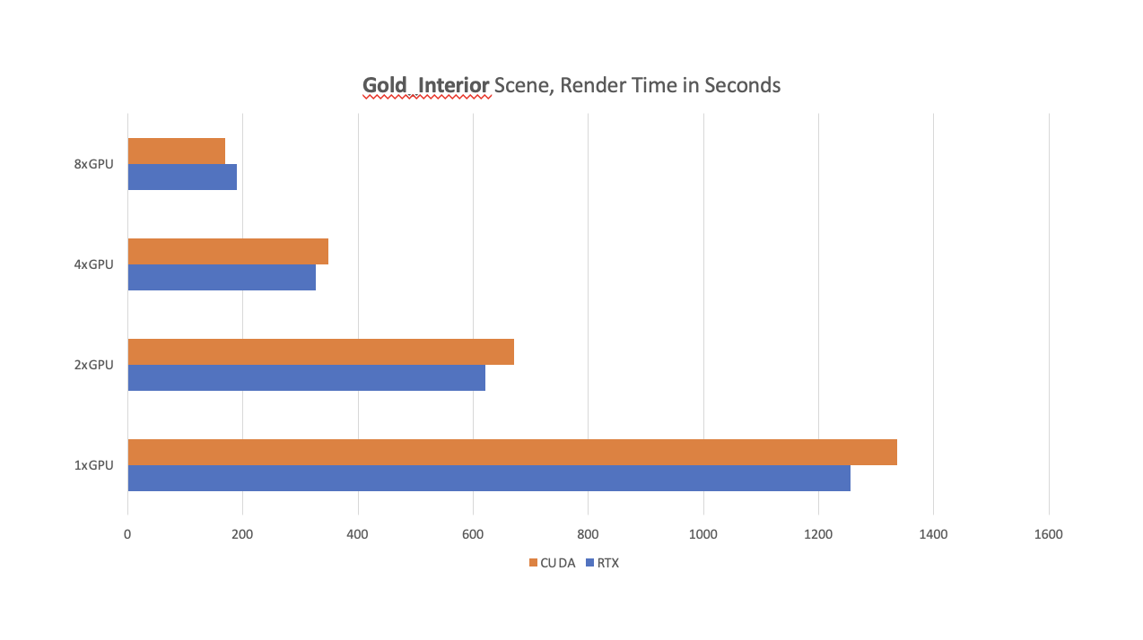

Test 1:
We noticed CUDA scaling of 99.61% scaling for 2 GPUs, 96.08% for 4 GPUs and 88.47% for 8 GPUs
The noticed RTX scaling of 101.13% for 2 GPUs, 96.26% for 4 GPUs and 92.35% for 8 GPUs​:
Test 1 Render time results

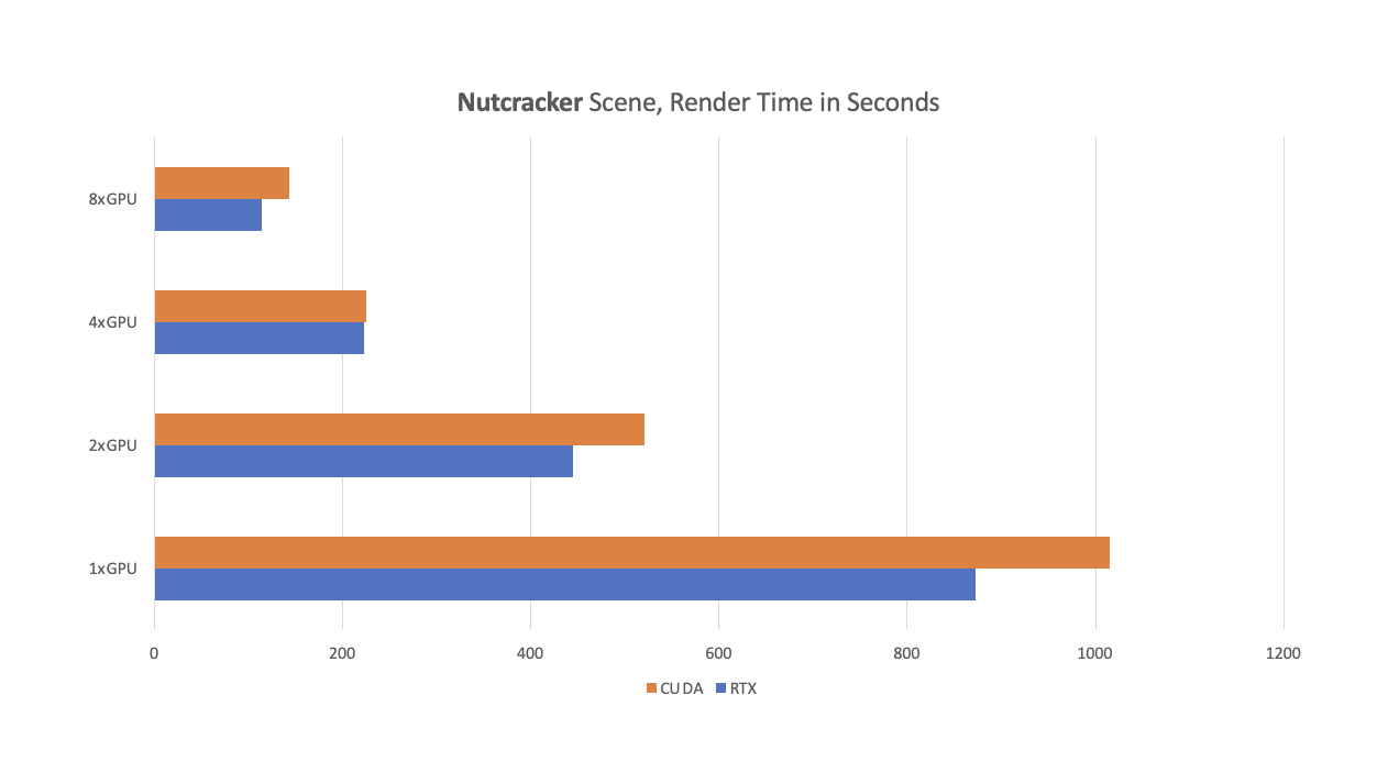

Test 2:
We noticed CUDA scaling of 97.41% scaling for 2 GPUs, 99.51% for 4 GPUs and 88.72% for 8 GPUs
The noticed RTX scaling of 97.98% for 2 GPUs, 97.71% for 4 GPUs and 95.03% for 8 GPUs​:
Test 2 render time results

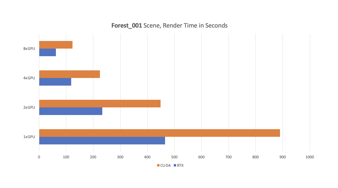

Test 3:
Note: this scene includes thousands of leaves and grass objects, and has all shading baked to textures, hence showing a big boost for RTX mode. In most cases, CUDA mode should be close to RTX mode in performance.
We noticed CUDA scaling of 99.11% scaling for 2 GPUs, 98.89% for 4 GPUs and 89.79% for 8 GPUs
The noticed RTX scaling of 99.79% for 2 GPUs, 97.69% for 4 GPUs and 93.75% for 8 GPUs:
Test 3 render time results
