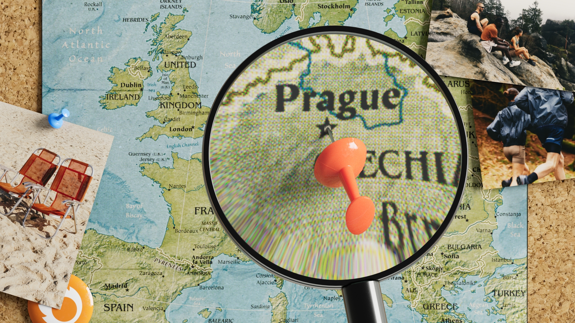

Below is an example showing how the old filtering compares to the new improved one:
Old filtering - note how the texture seen under the magnifying glass appears blurred and low-resolution:
(click to enlarge)
New filtering (Corona 12 Update 2 and newer) - the texture seen under the magnifying glass is sharper and higher-resolution. You can see individual halftone dots:
(click to enlarge)
