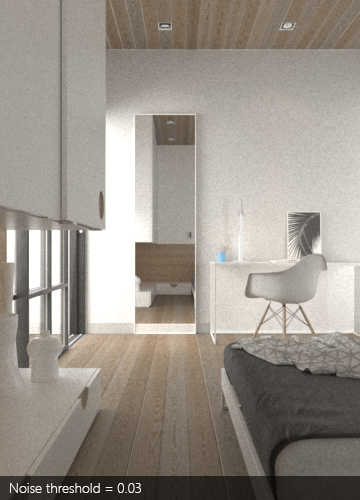

Example: Noise Threshold 0.005/0.03/0.02/0.01

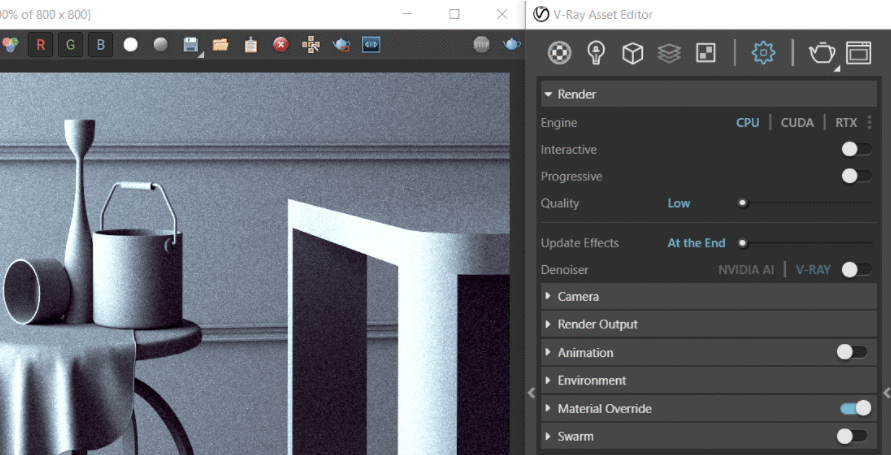

In V-Ray for  SketchUp, Rhino and Revit, render time can be reduced by decreasing the Quality slider/preset:
Reducing render time using Quality slider

For better image quality, increase the Max. Subdivs parameter for the Bucket or Progressive Image Sampler. If you can’t get the desired quality, try decreasing the Noise Threshold parameter a bit. In case you use a Render Time (min) limit, increase the time limit value to improve the quality.

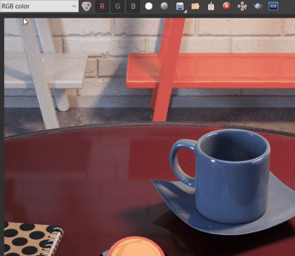

V-Ray provides a tool for denoising rendered images, called V-Ray Denoiser, that comes with the V-Ray installation. Denoising is a post-rendering process that helps remove noise in the image, without affecting the render time itself.
Since the tool is designed to remove noise, you can use lower-quality render settings and denoise the image after rendering.
To learn more about using the V-Ray Denoiser, visit the denoiser documentation page for: SketchUp, 3ds Max, Maya, Rhino, Revit, Cinema 4D, Houdini, Blender.
Example with enabled and disabled V-Ray Denoiser
Note: V-Ray Denoiser also comes as a Standalone Denoise Tool, which can be used outside of the host application and is ideal to process animations.
