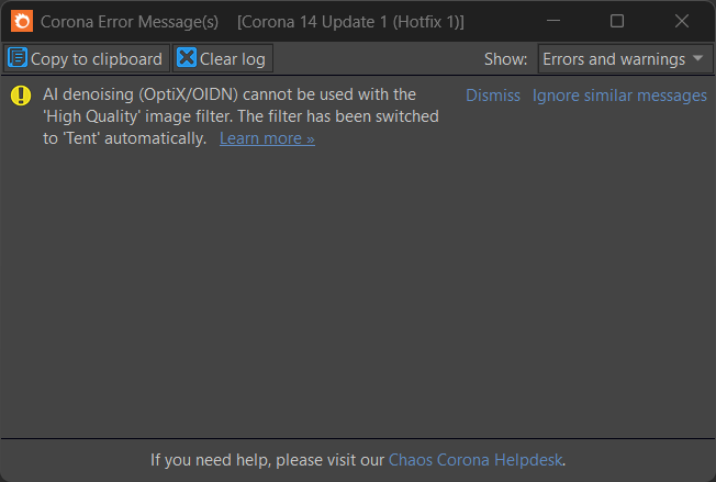

Error message text: AI denoising (OptiX/OIDN) cannot be used with the "High Quality" image filter. The filter has been switched to "Tent" automatically.

Currently, AI denoising and upscaling cannot be used with High Quality pixel filtering due to technical limitations. In such cases, the image filter type is automatically changed to "Tent" so that the AI denoising or upscaling can be used.
