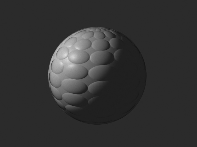

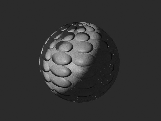

Normal Map - correct result
Normal Map - incorrect result due to wrong gamma correction
Note: Corona will attempt to detect whether a normal map texture is loaded correctly or not, but it might sometimes fail. This will result in displaying this error message even if the normal map is loaded correctly, and the material is looking as expected. To learn more, see this short guide: How to use normal maps?
