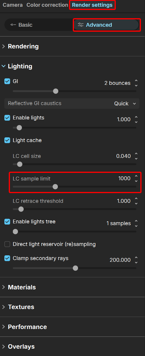

  2. Raise the Light cache sample limit to around 1000 or more for interiors; exteriors may need less. The setting is located in: Render Settings > Advanced > Lighting
    Location of the LC samples limit option
