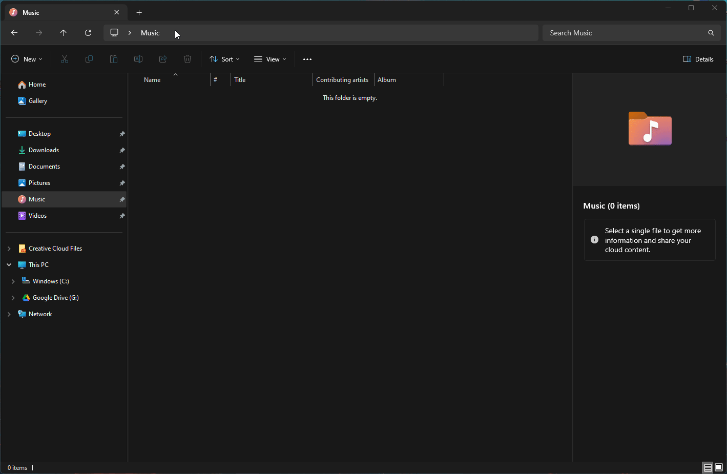

1. Force update the .rui file by deleting the cached version that Rhino makes here: %AppData%\Roaming\McNeel\Rhinoceros\7.0\UI\Plug-ins\VRayForRhino.rui
Starting up Rhino next time the file will be updated and it should fix the issue.
To access the Roaming folder write %AppData% in the file path and hit Enter:

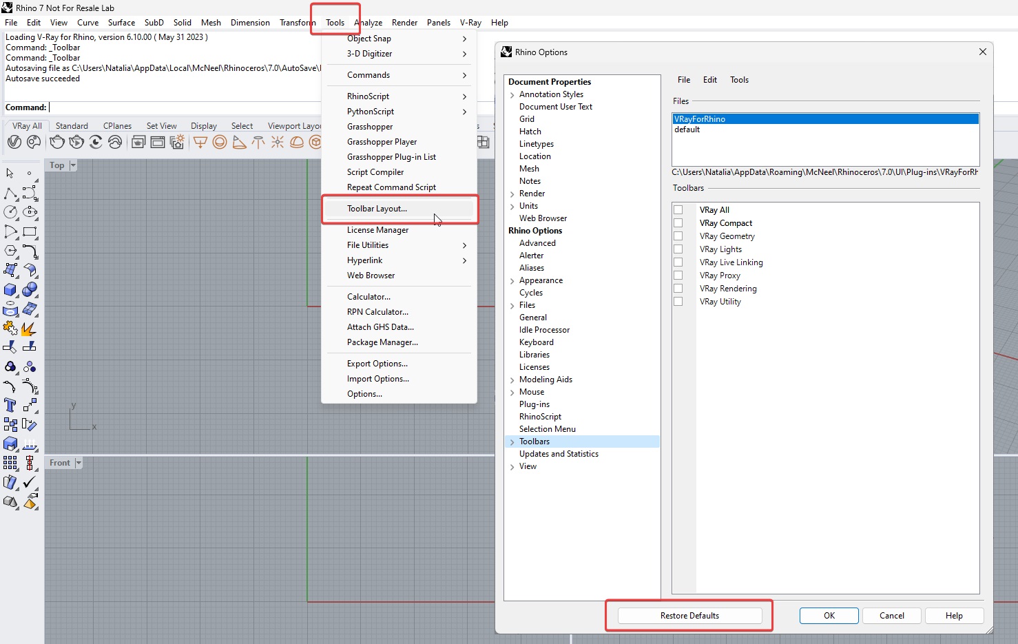

2. If updating .rui file does not help, try to Reset all Toolbars to Default from Tools > Toolbars Layout > Restore Default. Restart Rhino and the new V-Ray Toolbars will be loaded.
