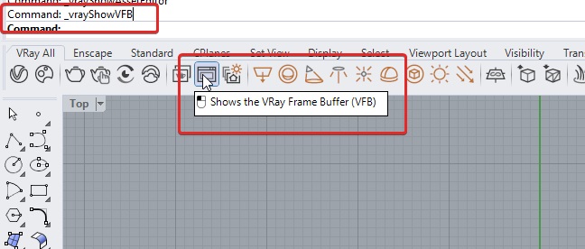

  1. Start a new file in Rhino and Open V-Ray Frame Buffer with the VFB button or _vrayShowVFB Command:
