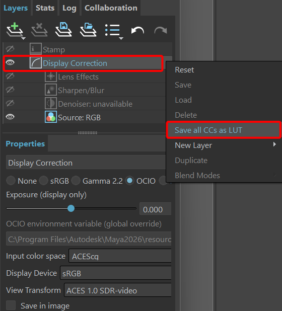

    1. Export the VFB Color Corrections as a LUT by right-clicking on the Display Correction layer in the VFB and choosing "Save All CCs as LUT".
      Location of the Save CCs as LUT option in the VFB

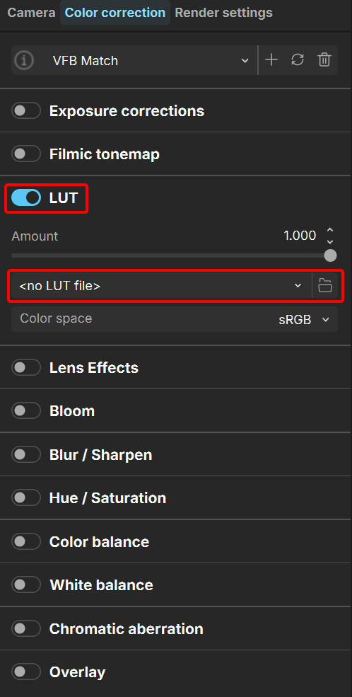

    2. Load the .LUT file in Vantage.
    Location of the LUT color correction in Chaos Vantage
