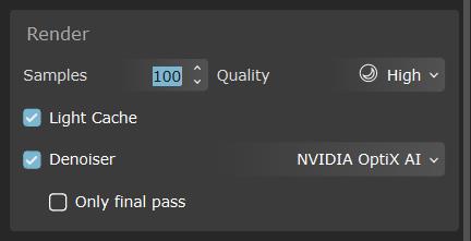

- Not enough Samples per pixel. Interior projects may need a lot more samples than exterior ones. Using values between 1000 and 2000 can result in flicker/splotchy-free rendering results.
UI Path: Tools > High Quality Render

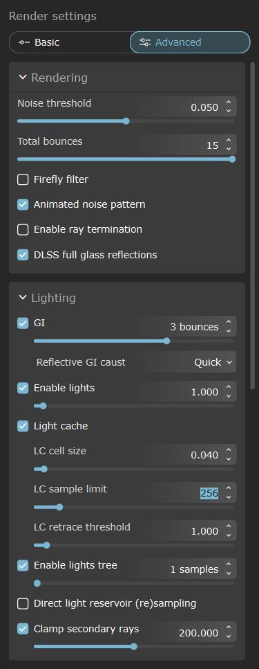

- The default Light Cache Sample limit might be insufficient. Similar to the Samples per pixel, interior projects may need a lot more Light Cache samples than exterior ones. Using values around 1000 or more can help to get flicker/splotchy-free rendering results.
UI Path: File > Advanced Scene Settings

- Try rendering a few frames without a denoiser.
- Turn off the Enable dynamic textures option (in Render tab > Advanced).
- Increase the Light Cache’s Retrace threshold to 3.
Use the Reduce flickering option (in Tools menu > High Quality Render).
