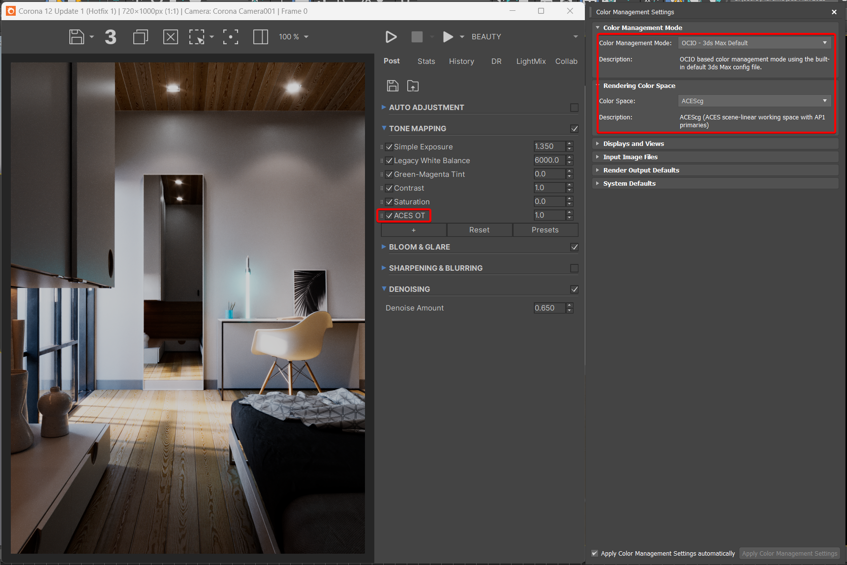

Wrong setup: 3ds Max OCIO color management mode is enabled. ACES OT is enabled. The image appears darker and the highlights are heavily clamped. The error message is displayed in this case:

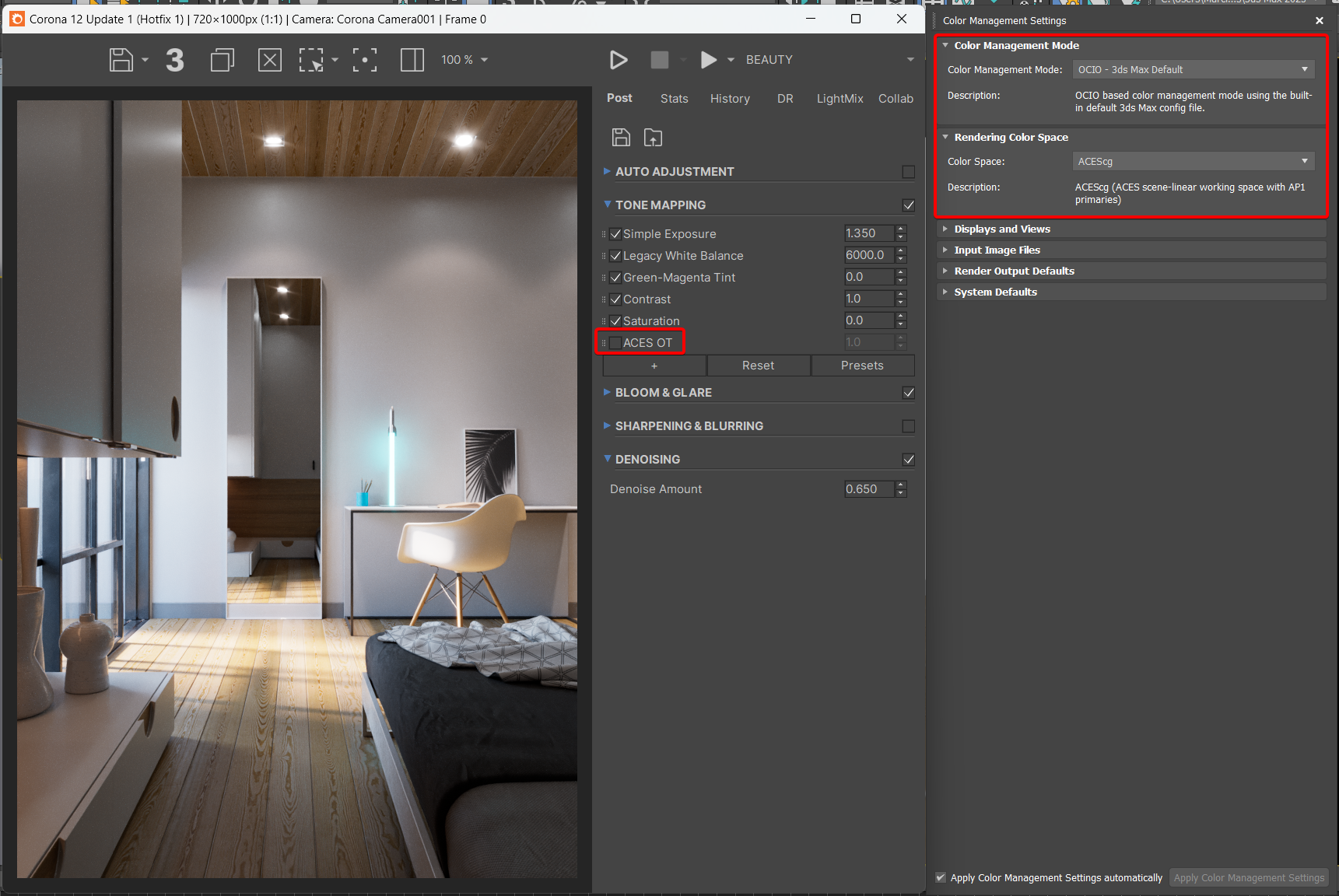

Correct setup: 3ds Max OCIO color management mode is enabled. ACES OT is disabled. This is the expected appearance of the rendered image:
