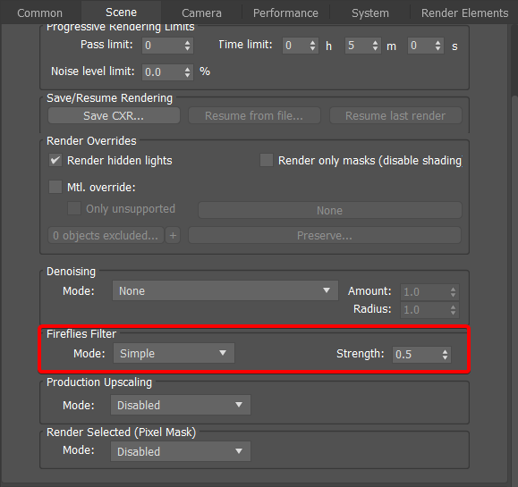

You can find the option under Render Setup > Scene > Fireflies Filter:
Note: using high strength values can make the whole image appear darker.

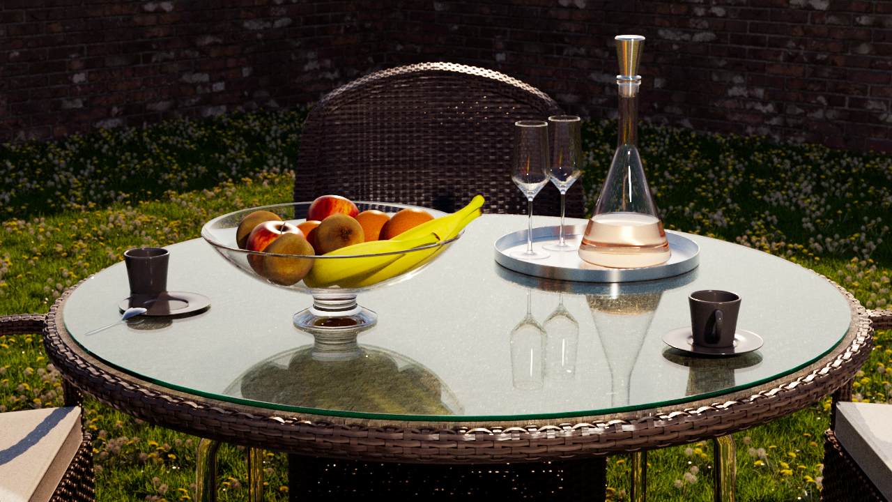

Original image with no Fireflies Filter or denoising applied:
Fireflies appear most clearly on the glass tabletop. This happens because the sun—a small but very bright light source—shines through multiple glass layers and then reflects off the surface below. In this scenario, it’s challenging for the renderer to sample light accurately, which leads to bright fireflies.
