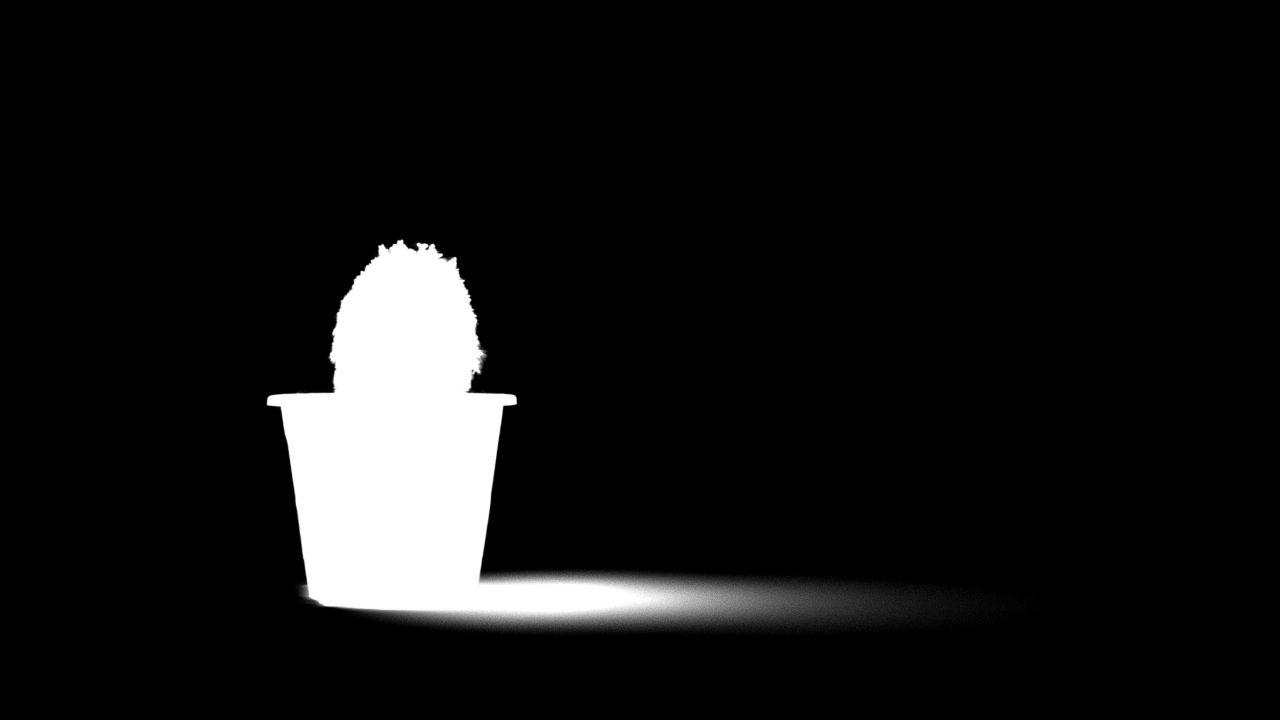

    Gaussian splats work well with Corona's shadowcatcher materials. They appear correctly even when placed behind matte objects. This makes them useful for advanced compositing projects.
    Corona Shadowcatcher capturing the shadow of a Gaussian Splat cactus in a pot. Gaussian Splat provided by https://www.steam-studio.jp under Creative Commons CC0 license.

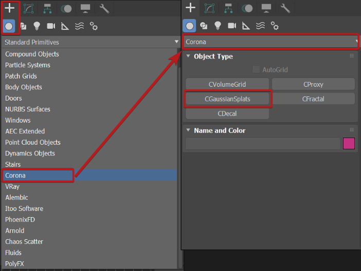

To create a Gaussian Splat object: Command panel > Create tab > Geometry > Corona category > Corona GaussianSplats button

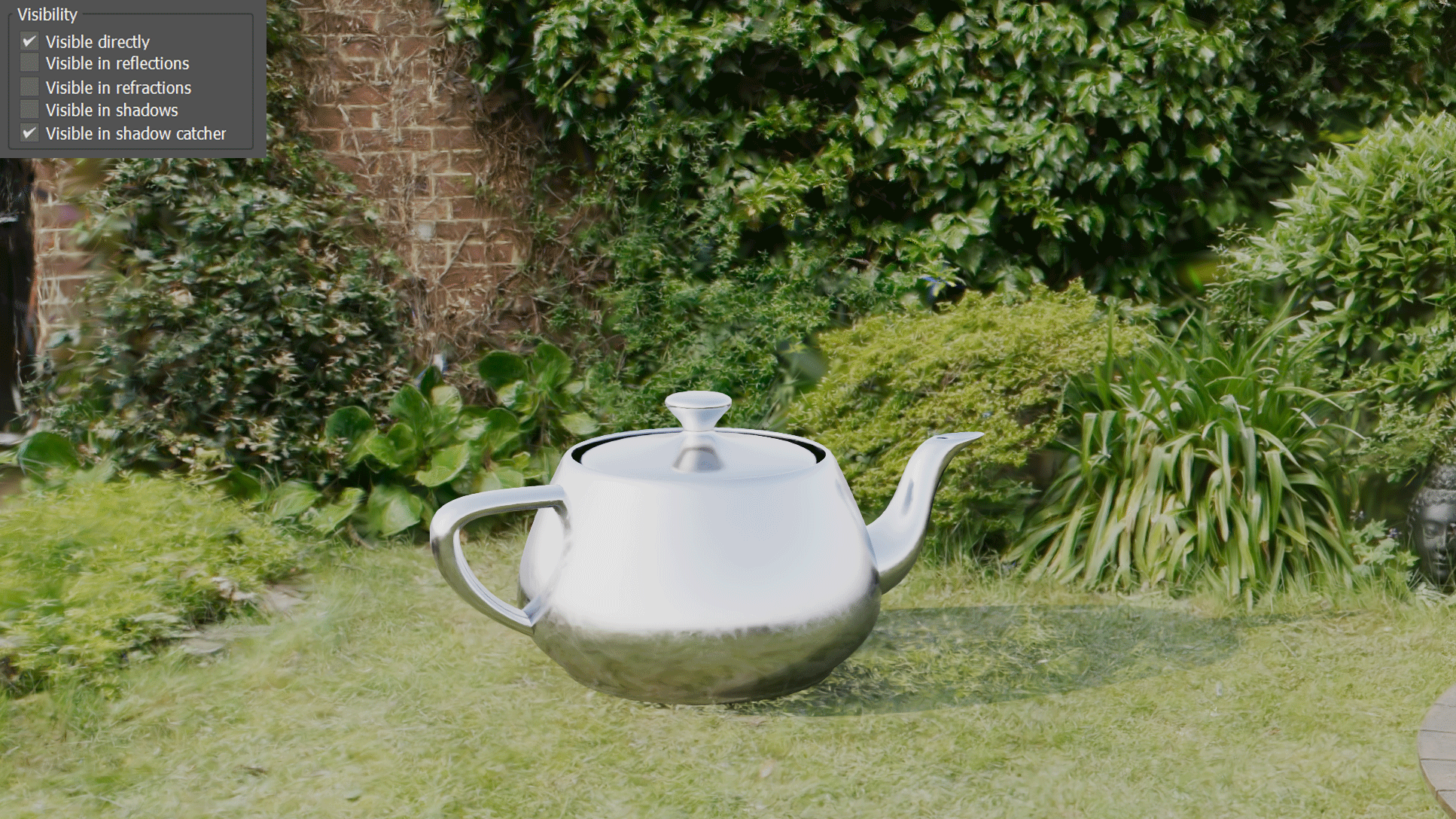

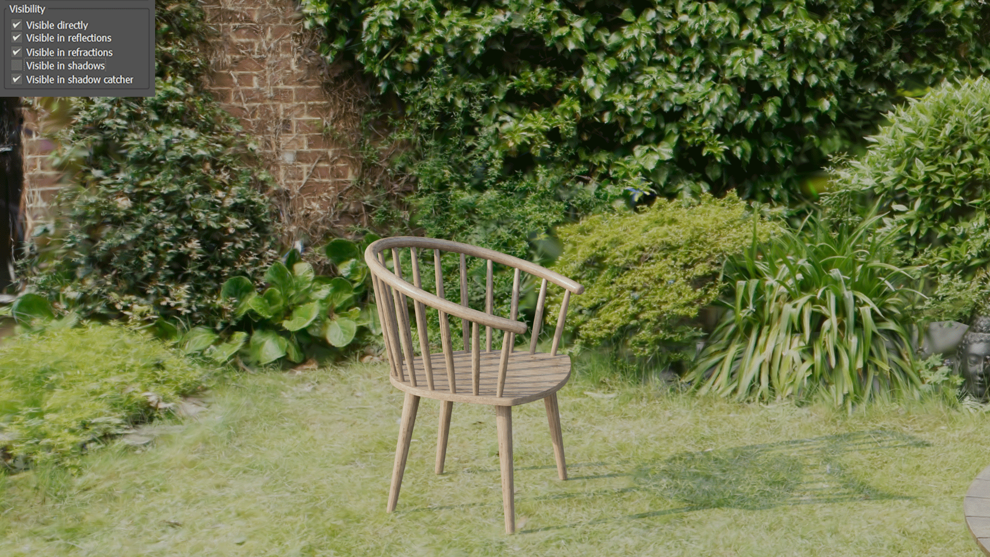

Using splats as environments
To use splats as a background environment:

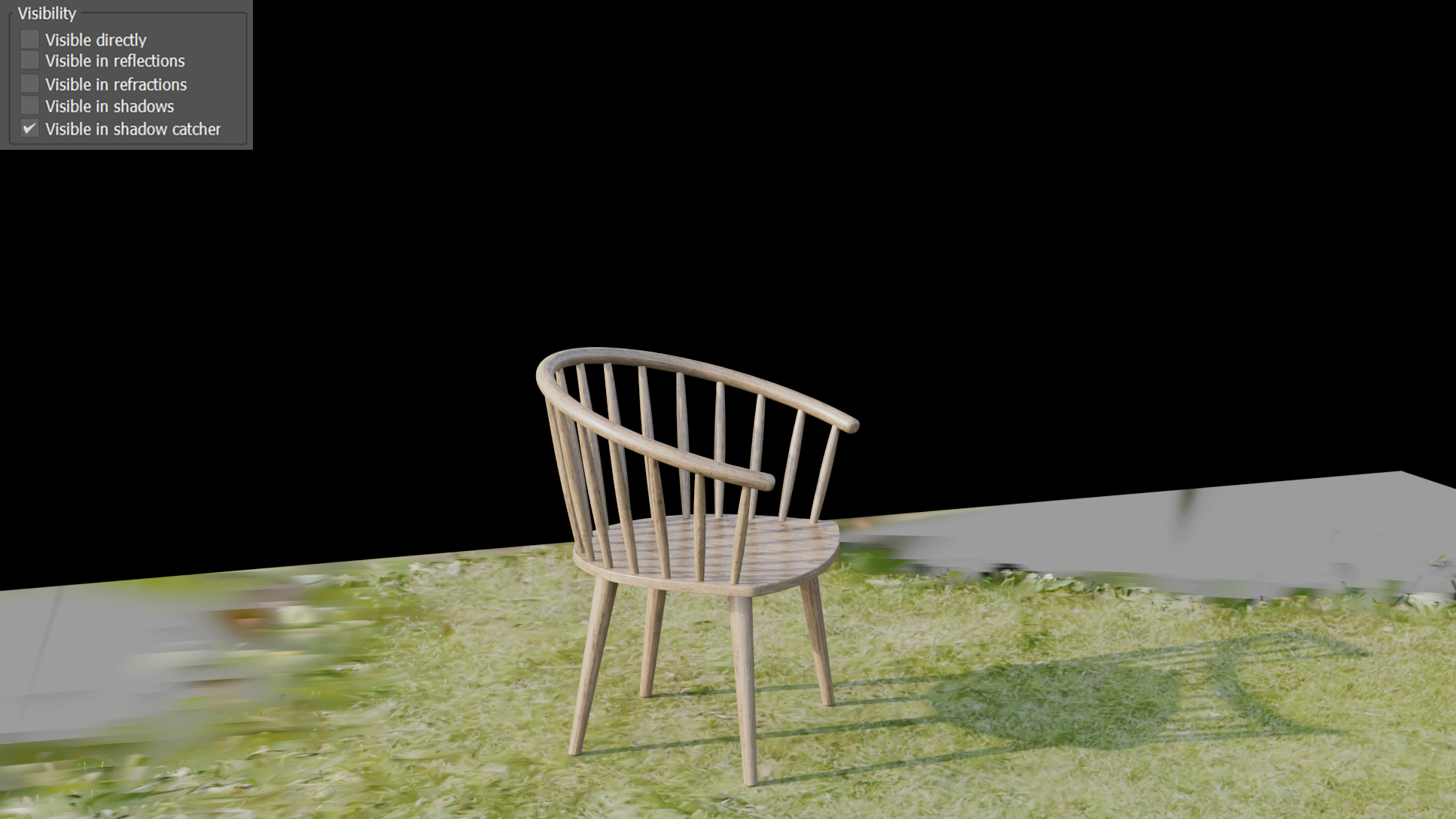

  1. Turn on Visible in shadowcatcher so the splats show up behind shadowcatcher materials
  2. Turn off Visible in shadows to prevent unwanted shadows
  3. Adjust the Scale to match your scene size
  4. Use the Flip frame dropdown to reorder the X Y Z axes if the splat loads in the wrong direction.

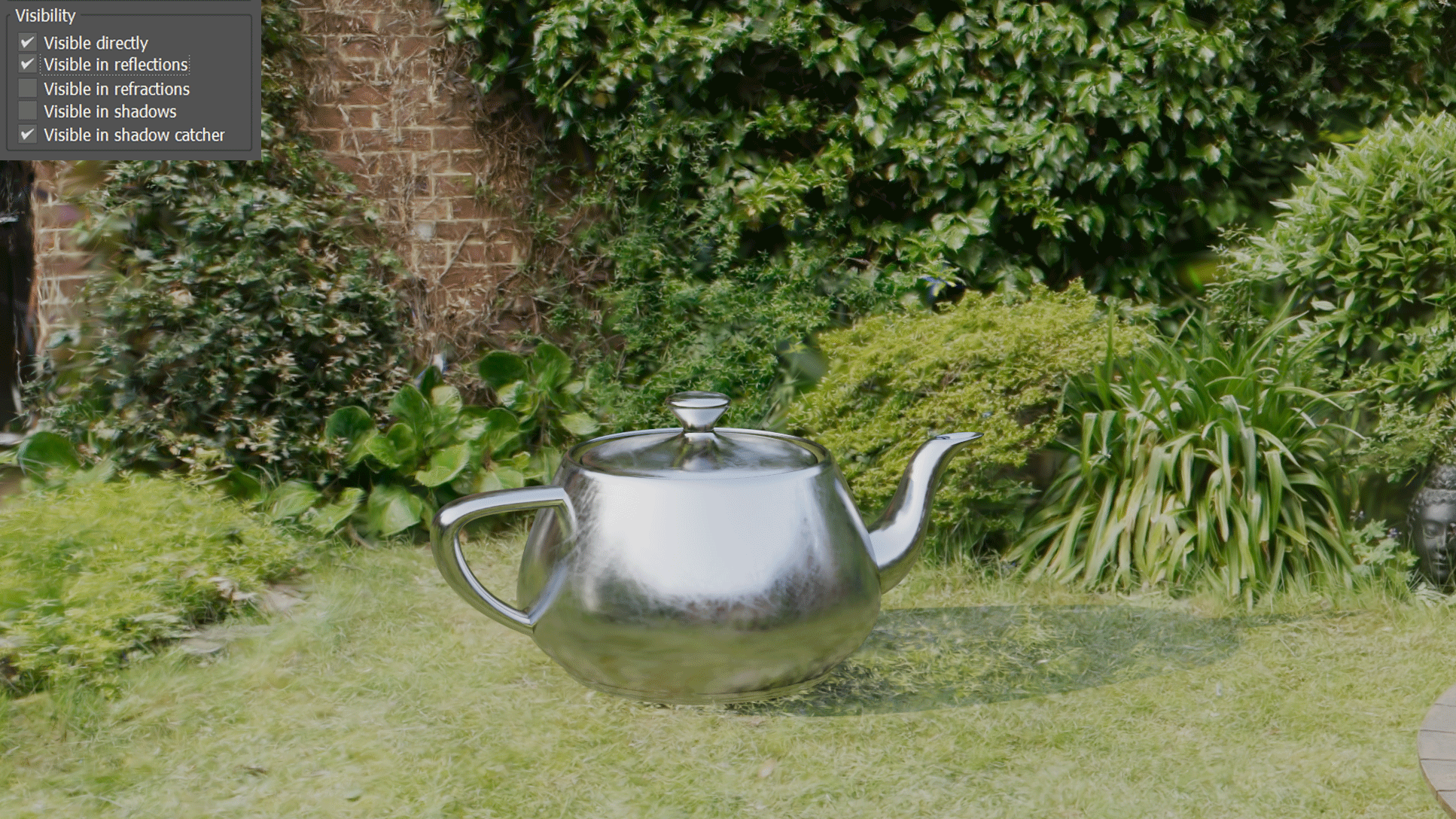

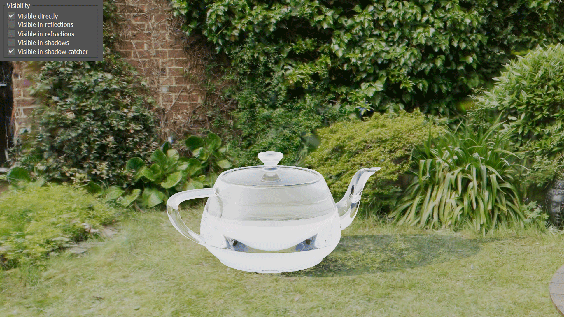

  • Visible Directly: Shows splats in the camera view
  • Visible in reflections: Shows splats in mirrors and shiny surfaces

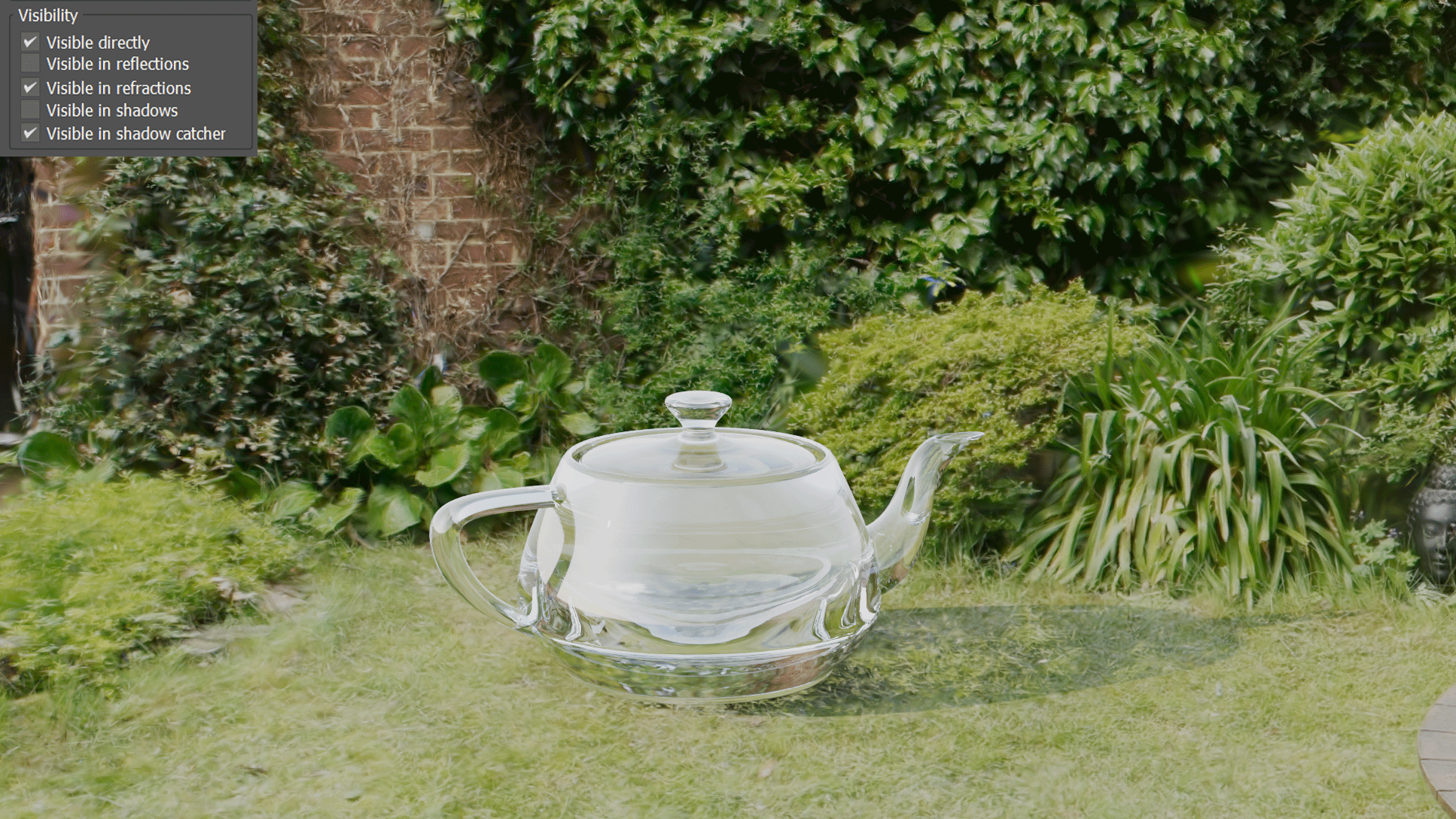

  • Visible in refractions: Shows splats through glass and transparent objects
  • Visible in shadow catcher: Makes splats visible when behind objects with Shadowcatcher material
  • Visible in diffuse GI: Lets the splat cast indirect (bounced) light onto other objects in your scene.
Visible Directly
Shows the Gaussian splat directly to the camera.
Visible in Shadow Catcher
Makes the splat visible behind objects using the Corona Shadow Catcher material.
Visible in Reflections
Controls whether the splat appears in mirrors and reflective materials.
Visible in Refractions
Controls whether the splat can be seen through glass and other refractive materials.
