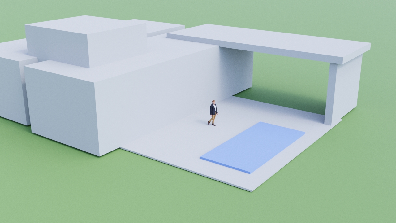

An example use of Veras (click each thumbnail to enlarge it):
Original Corona rendering
Realistic Veras rendering
Stylized Veras rendering

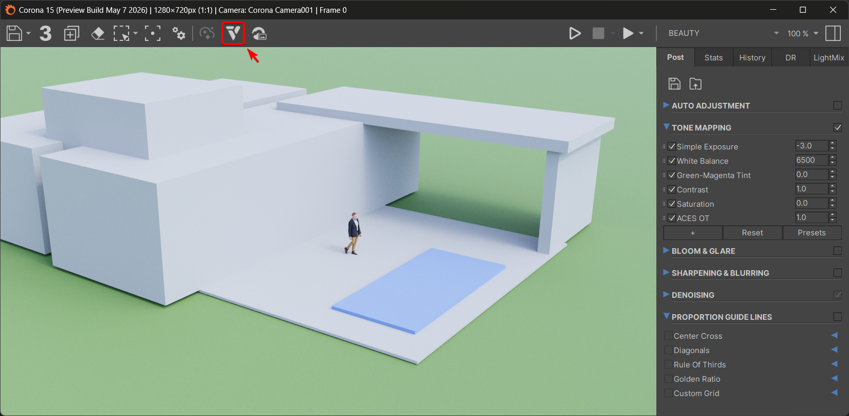

Where to find it?
You can find the Veras button in the top toolbar of the Corona VFB:

  1. Start a Render: You can trigger Veras during Interactive Rendering, while a production render is running, or after it has finished.
  2. Launch Veras: Click the Veras icon in the VFB. This will automatically capture the current VFB contents and open the Veras interface.
