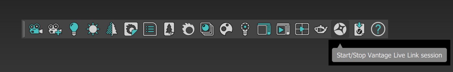

    You can also use the Corona toolbar button that looks like a small Vantage icon to start or stop Live Link.

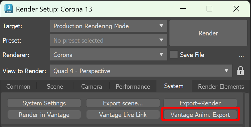

  • Go to Render Setup > System and click Vantage Anim. Export
  • This allows Vantage to render the animation using the live-linked data from 3ds Max.

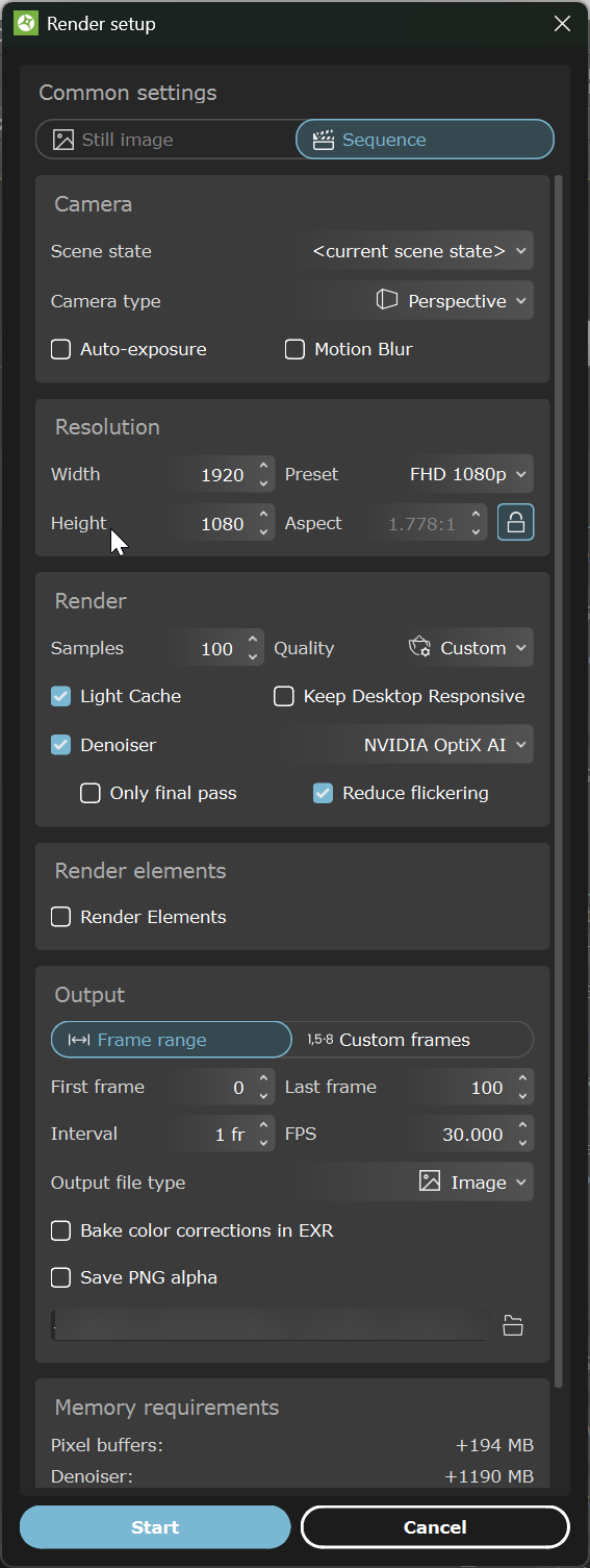

  • Vantage will now open a Render Setup window.
Step 3: Final Render Settings in Vantage

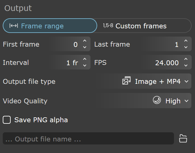

In the Vantage render window:
  1. Make sure “Sequence” is selected (not still image).

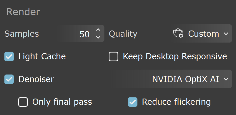

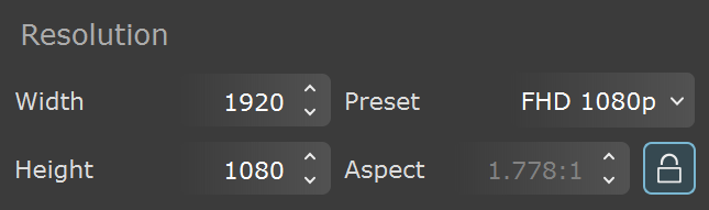

  2. Set:

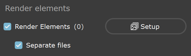

  3. Optional: Enable Render Elements and pick the ones you need.
  4. Hit the Start button to begin rendering the animation.
  5. That’s it! Vantage will now render your animation sequence.
