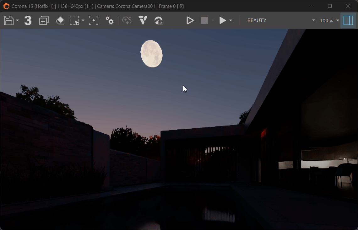

  5. If you want to make the moon visible, adjust its position so that the camera can see it. Interactive rendering is extremely helpful here.
    Tip: to specify the exact position of the the moon in the sky during interactive rendering, with the "Pick" button active, right click in the sky and select "Place moon here":
