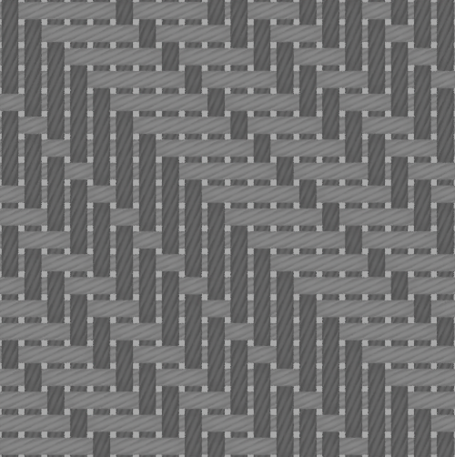

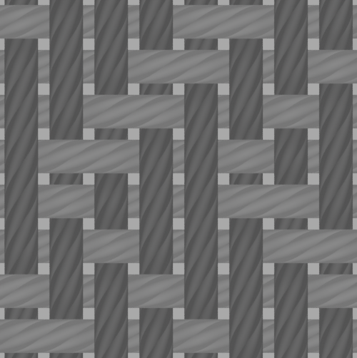

Weave pattern - pattern to be tiled across the surface. Several patterns are available:
Flat
Plain
Twill
Satin
Mosaic
Diamond
Spiral
Broken Twill
Shaded Twill
Herring Bone
Huck a Back
Welts and Pique
Mock Leno

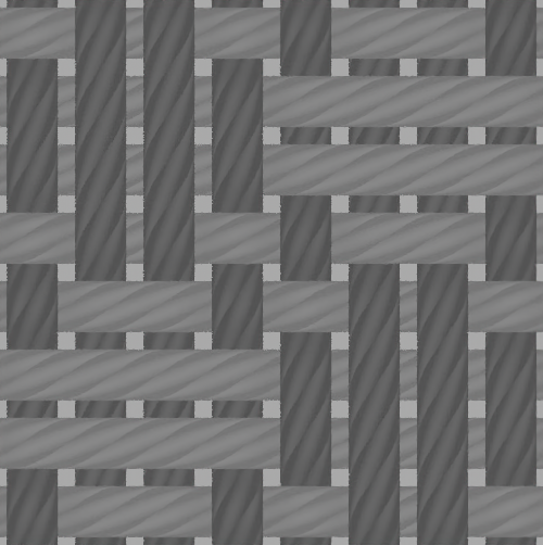

You can also specify a custom pattern using a map. The map should be reasonably low-resolution and should consist of black and white pixels only. Pixels of any other color will be interpreted as either white or black, whichever their brightness is closer to.
Pattern size (h/v): when you specify your own pattern, you need to specify the resolution of the pattern, which should be an exact match to the resolution of the bitmap texture.

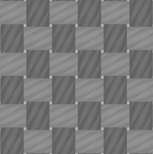

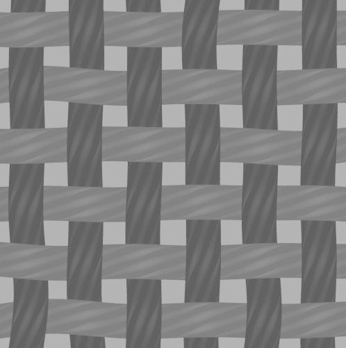

Plain pattern
Plain pattern

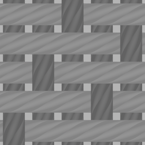

with warp repeat = 2

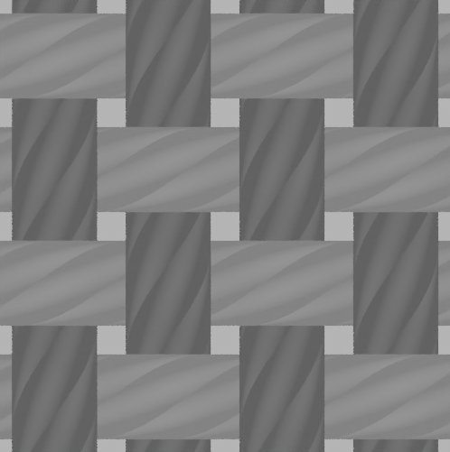

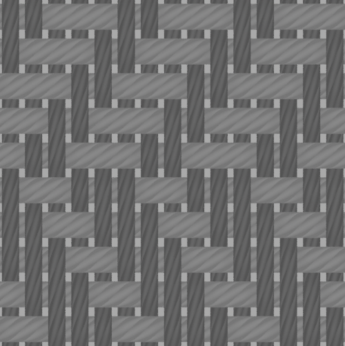

Twill pattern
with warp repeat = 3
and weft repeat = 2

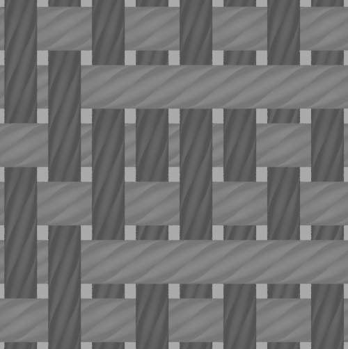

3x3 diamond tiling
10x10 satin tiling
Custom pattern of size 80x80
with tiling of 2x2

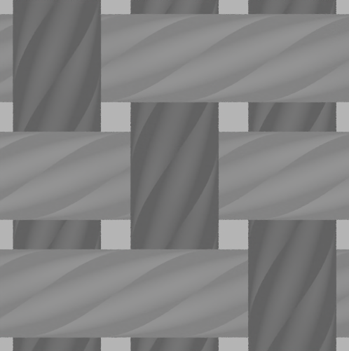

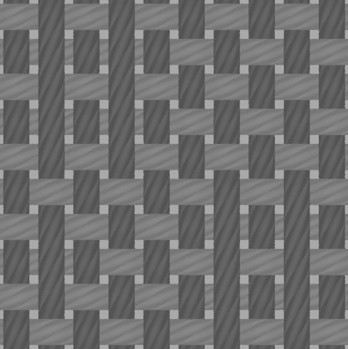

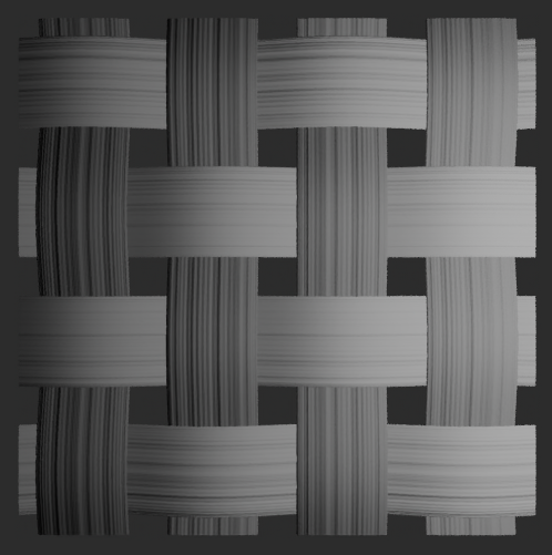

Yarn strands
Once the pattern is determined, the geometry of the yarn itself can be refined. Strands can be flat or cylindrical, have various diameters and can oscillate at different amplitudes. Flatter strands will typically have low oscillations, while rounder ones will bend more.
Weft diameter - fraction of the space filled by each horizontal strand
Warp diameter - fraction of the space filled by each vertical strand
Diameter of 0.5
Diameter of 0.9
Amplitude - Strength of the yarn oscillations when interlacing
Amplitude of 0.1
Amplitude of 0.6
                     (Both illuminated by a light source on the right)

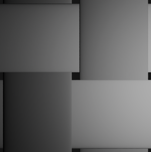

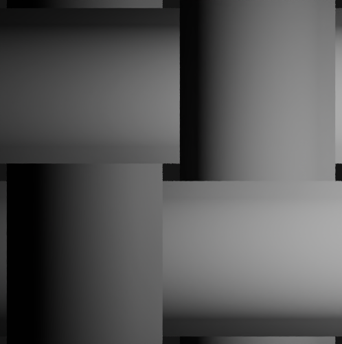

Thickness - Thickness of the yarn, which determines the roundness of the strands
Thickness of 0.1
Thickness of 0.8

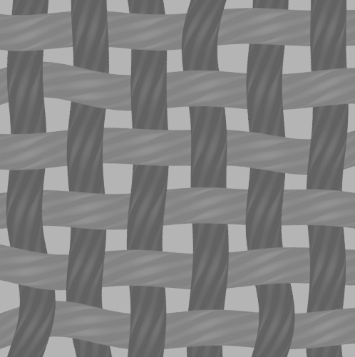

Distortion
To prevent the geometry from being too regular, the yarn strands can be distorted sideways along their length.
Texture - custom map for distorting the the yarn strands. If none provided, a default noise map is used
Strength - strength of the distortion effect. The sideways bending can go from none all the way to the strand boundary, after which the space belongs to a different strand
Distortion strength of 0.3
Distortion strength of 1.0
Frequency - smoothness of the distortions.
Distortion frequency of 0.1
Distortion frequency of 0.5

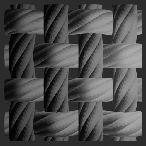

Depth
To induce a sense of depth, parallax effect can be enabled to change the geometry according to the view angle. This effect is useful for close-ups and fabrics with distinctive yarn strands. Because of its heavy performance cost, it should only be used when its impact is visually noticeable, and when the surface is not at a high grazing angle.
Parallax quality - quality of the effect. If set to zero, disables parallax entirely.
Yarn offset - how much below the surface the yarn strands should be. This parameter is sometimes useful when large amplitude and thickness values cause the strands to flatten at the top. This however can drastically reduce the quality of parallax for curved surfaces.
Parallax with amplitude of 0.6
and thickness of 0.4
Parallax with amplitude of 0.2
and thickness of 0.1

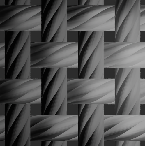

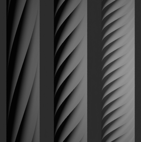

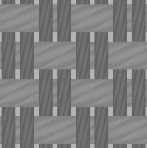

Plies

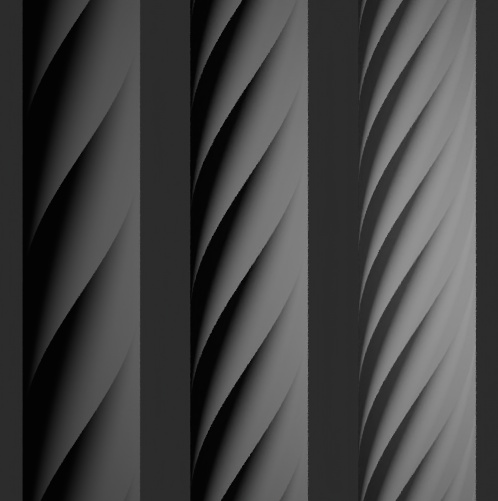

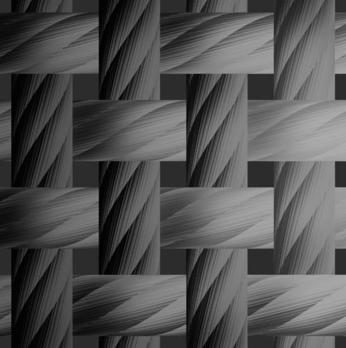

Yarn strands are composed of several strands themselves, twisted in a helical fashion. These sub-strands are called “plies”.
Count - the number of plies
Twisting - how much the plies twist
Strength - how much impact on the shading the plies have
4, 6, and 8 plies
Twisting of 0.15, 0.4, and 0.8
Strength of 0.2 and 0.7

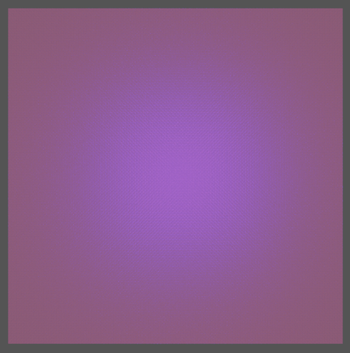

Examples

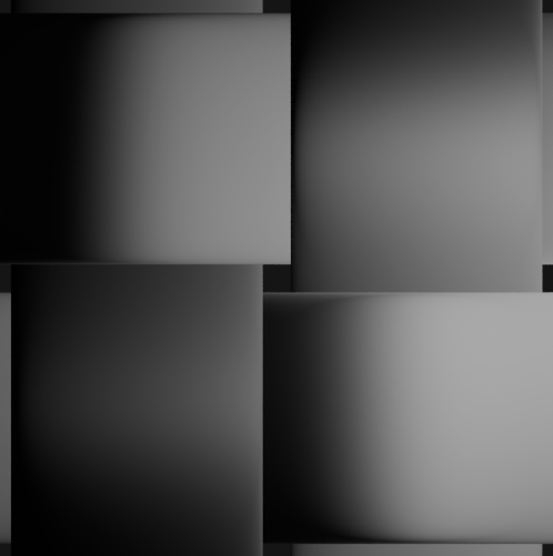

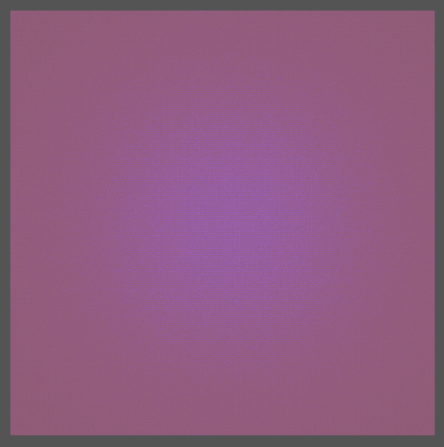

A simple plane-shaped colorless fabric is rendered from a top-view, with two spherical light sources. One is a red light that provides frontal illumination (it is located near the camera), and the other is a blue light that provides illumination from the back (the fabric lies between the blue light and the camera).
Diffusedness
No diffuse (Refraction = 1)
No scattering
Semi-diffuse (Refraction = 0.5)
No scattering
Left: Without scattering or diffusion, and at such an angle, most of the light is specularly refracted, which is why the dominant color is blue and the shape of the light source is clearly visible underneath the fabric.
Right: With partial diffusion, some of the front light reflects, making the red color more dominant than before.
Scattering amount
No diffuse
Semi-scattering (Amount = 0.5)
Balanced (Directionality = 0.5)
No diffuse
Highly-scattering (Amount = 1.0)
Left: Both red and blue light contribute, as scattering adds both reflection and refraction. The silhouette of the blue light is still quite visible due to specular refraction, making the blue color more dominant in the center.
Right: With almost no specular refraction, the silhouette of the blue light is blurred, giving the fabric a more uniform look.
Scattering directionality
No diffuse
Highly-reflective (Directionality = 0.2)
No diffuse
Highly-refractive (Directionality = 0.8)
Left:  the fabric has almost no specular refraction, and all scattering is reflected, making red the more dominant color
Right: the fabric has almost no specular refraction but all scattering is refracted, making blue the more dominant color, without making the blue light silhouette more visible

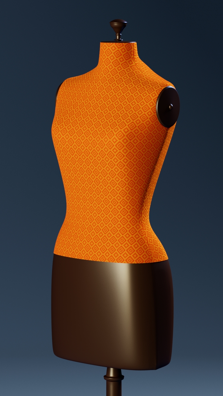

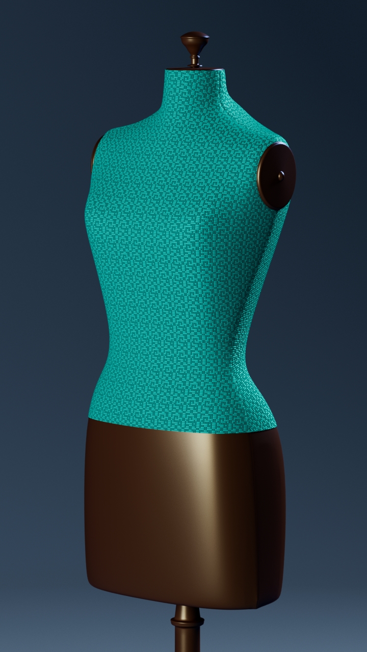

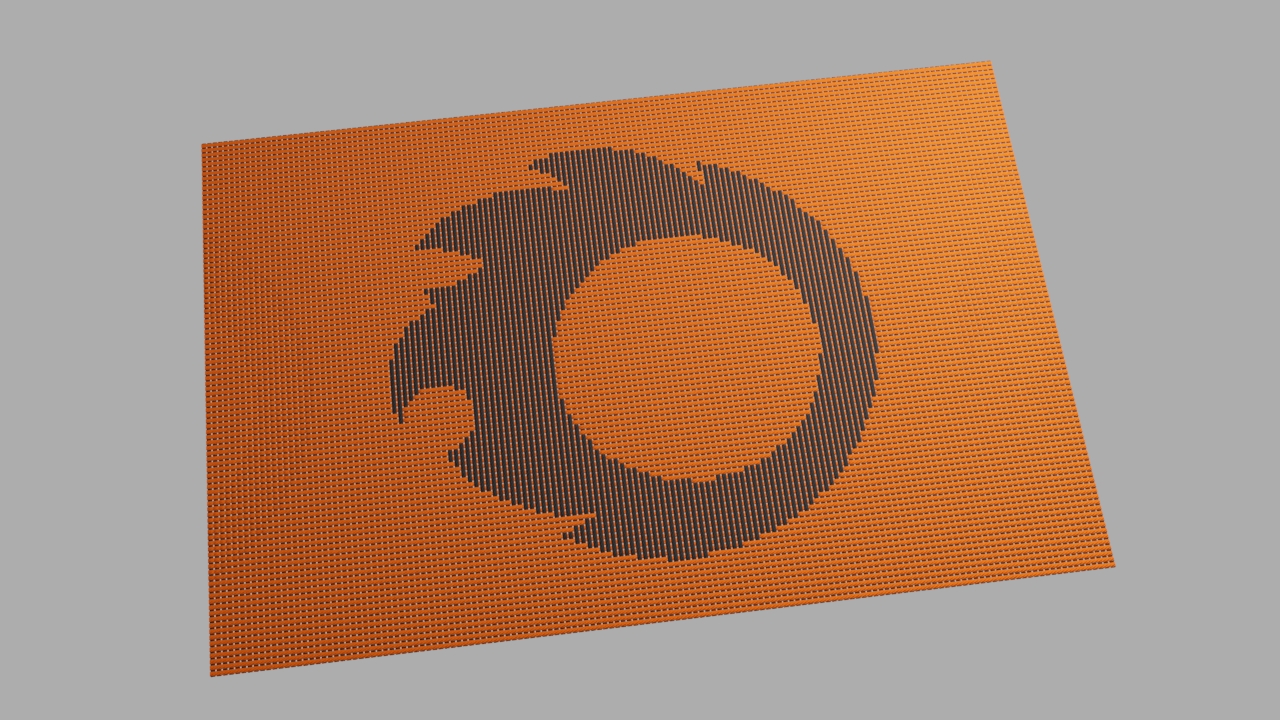

Custom Weave Pattern
You can use a custom Corona Bitmap or a procedural texture to define the areas where wefts and warps show up in your fabric material, as if the texture was woven.

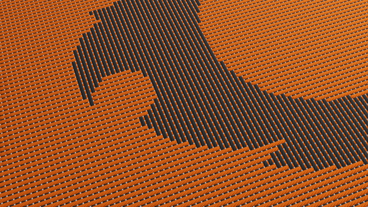

If you simply set a Corona Bitmap as the pattern, the result most likely won't be realistic and will appear as if it was a print applied to the surface of the fabric:
To fix that, we need to make some adjustments:

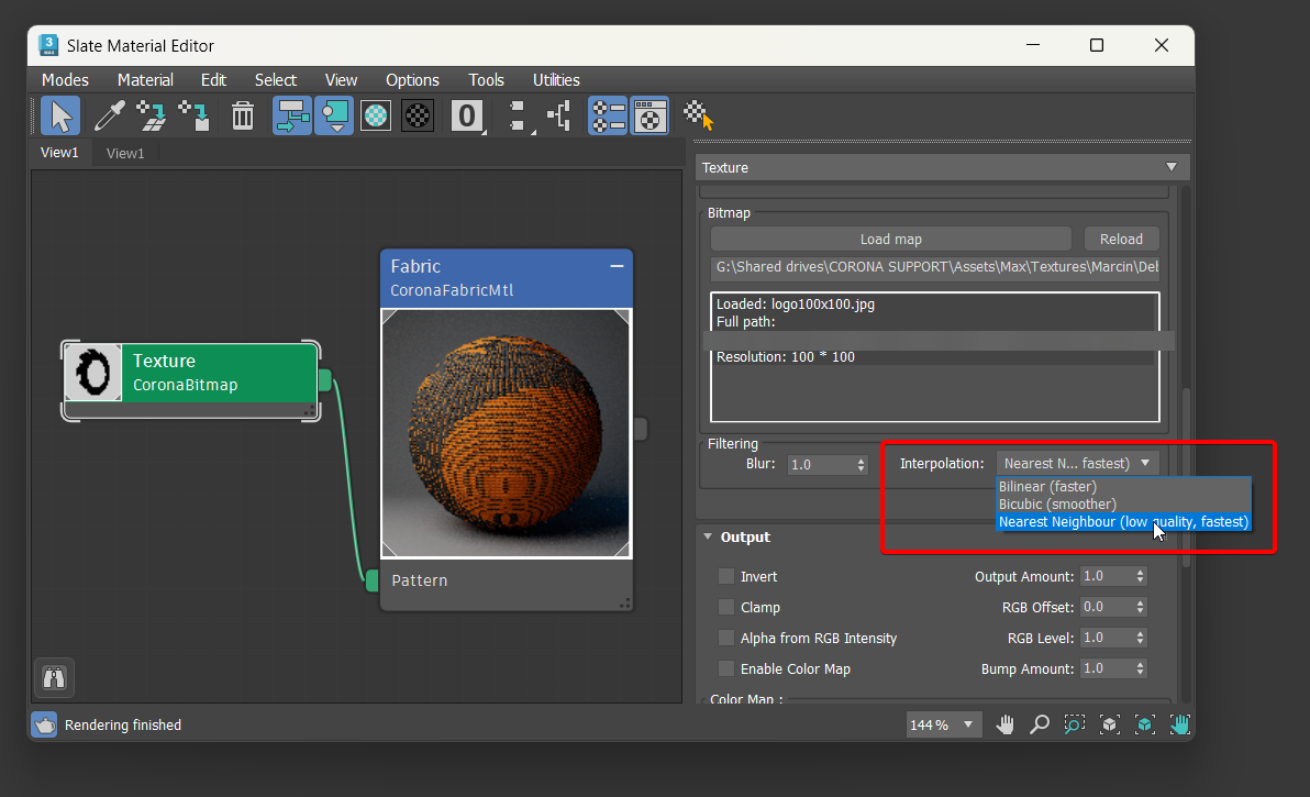

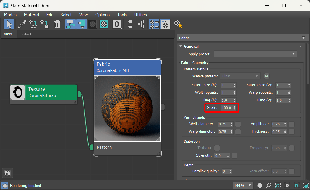

  • We need to make sure that the resolution of the bitmap texture (width x height in pixels) is the same as the "resolution" of the fabric material (the number of wefts x warps).
  • We need to disable texture filtering so that we end up with a texture consisting of sharp pixels without any blurring. To do this, we need to set Interpolation to "Nearest Neighbor" in the Corona Bitmap's settings.
In the below example, we reduced the resolution of the Corona logo texture to 100x100px in a 2D editor, set its interpolation to "Nearest Neighbor", and set the scale of the fabric material's pattern to 100:
The result is a woven version of the Corona logo:

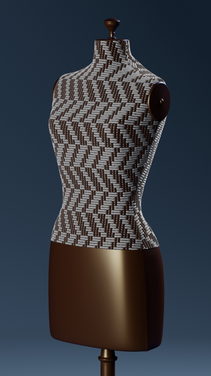

Weave pattern: Herring Bone

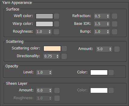

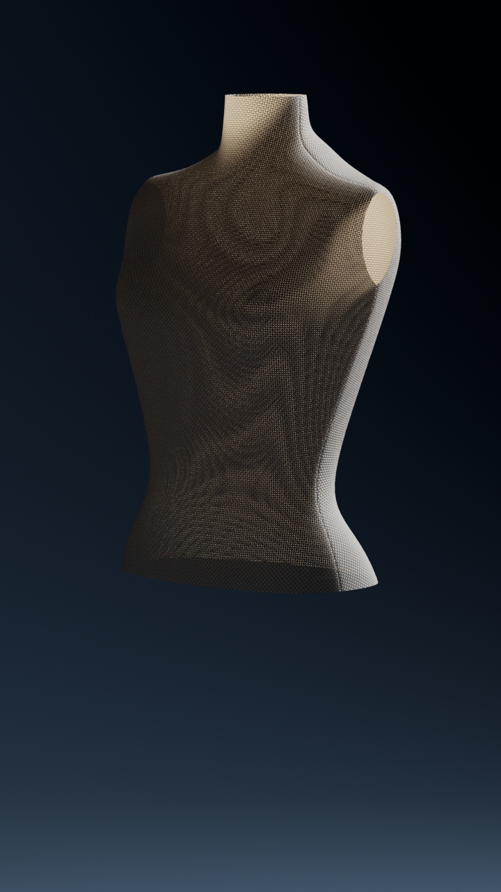

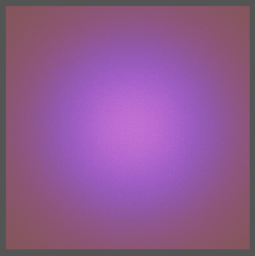

Using Refraction and Scattering
Material setup:
Was this article helpful?
