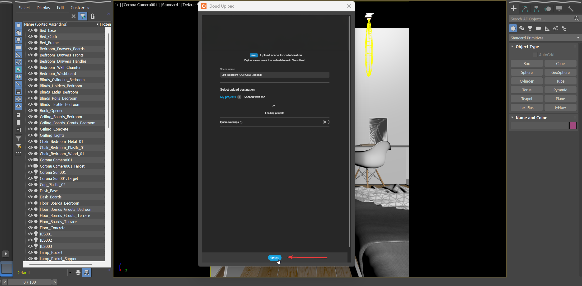

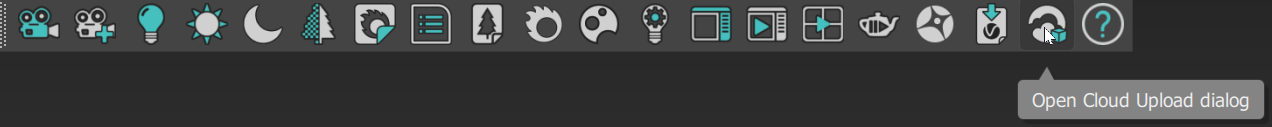

  1. Open your Corona scene.

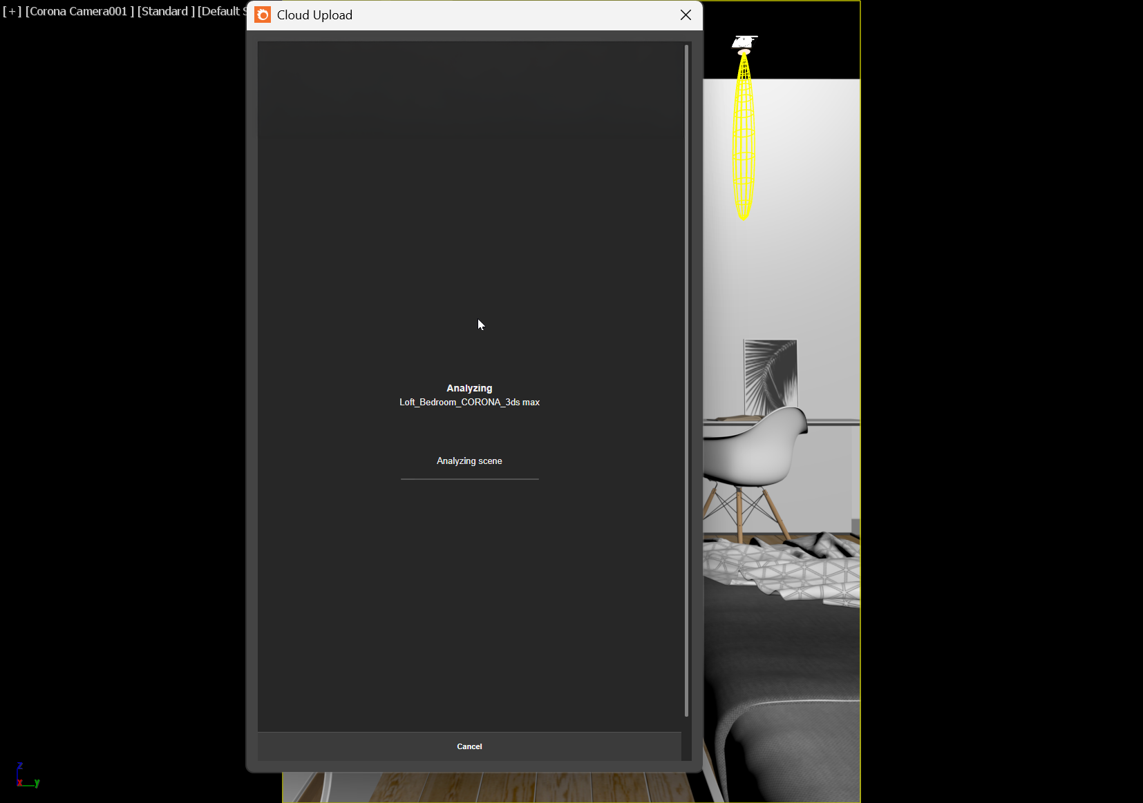

  2. Click the Cloud Upload button in the Corona toolbar.

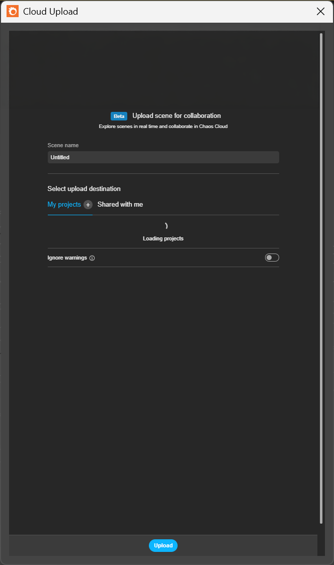

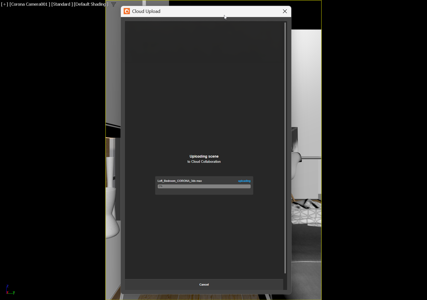

  1. In the Cloud Upload window, enter a scene name and select the upload destination.
  1. Click Upload.

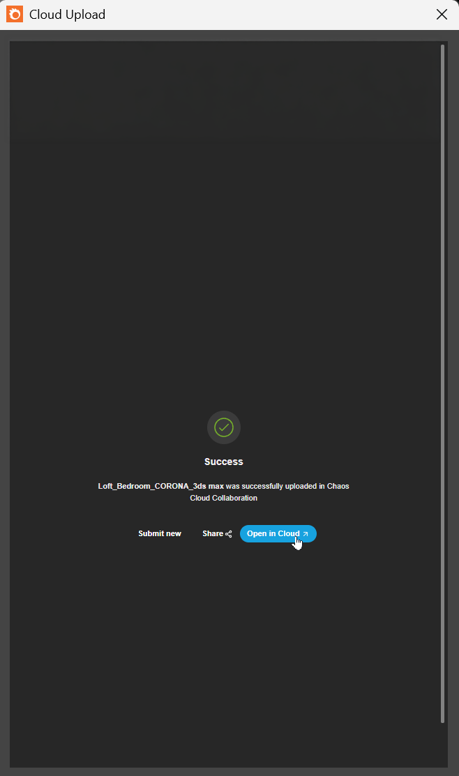

  1. Corona will analyze the scene and upload it to Chaos Cloud Collaboration.
  1. Once the upload is complete, click Open in Cloud.

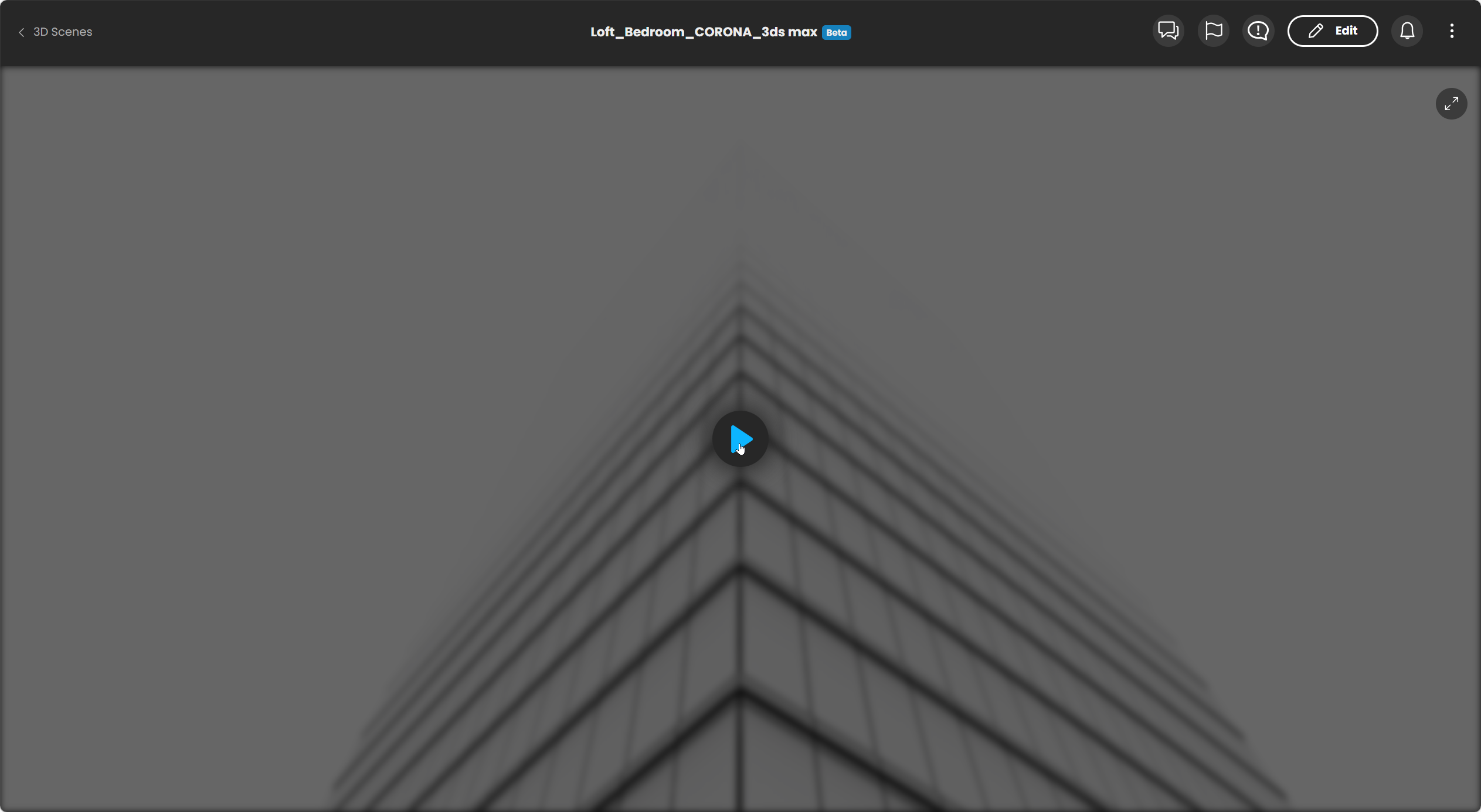

Opening the scene in Chaos Cloud

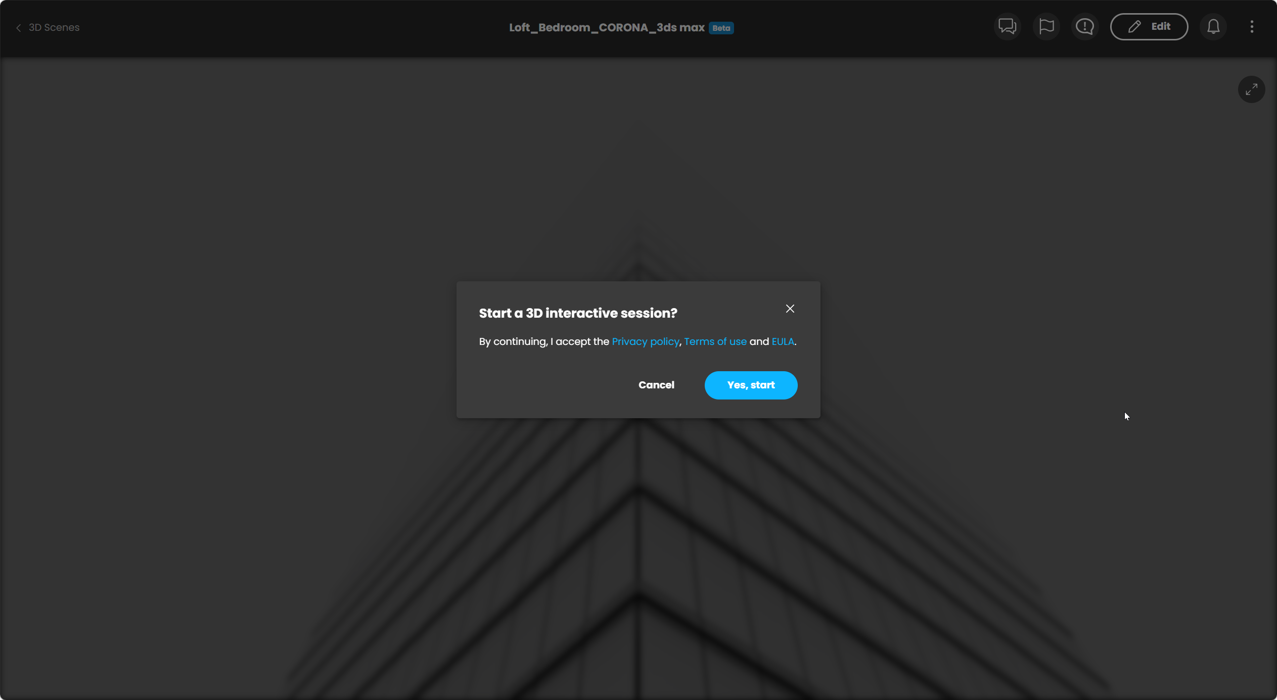

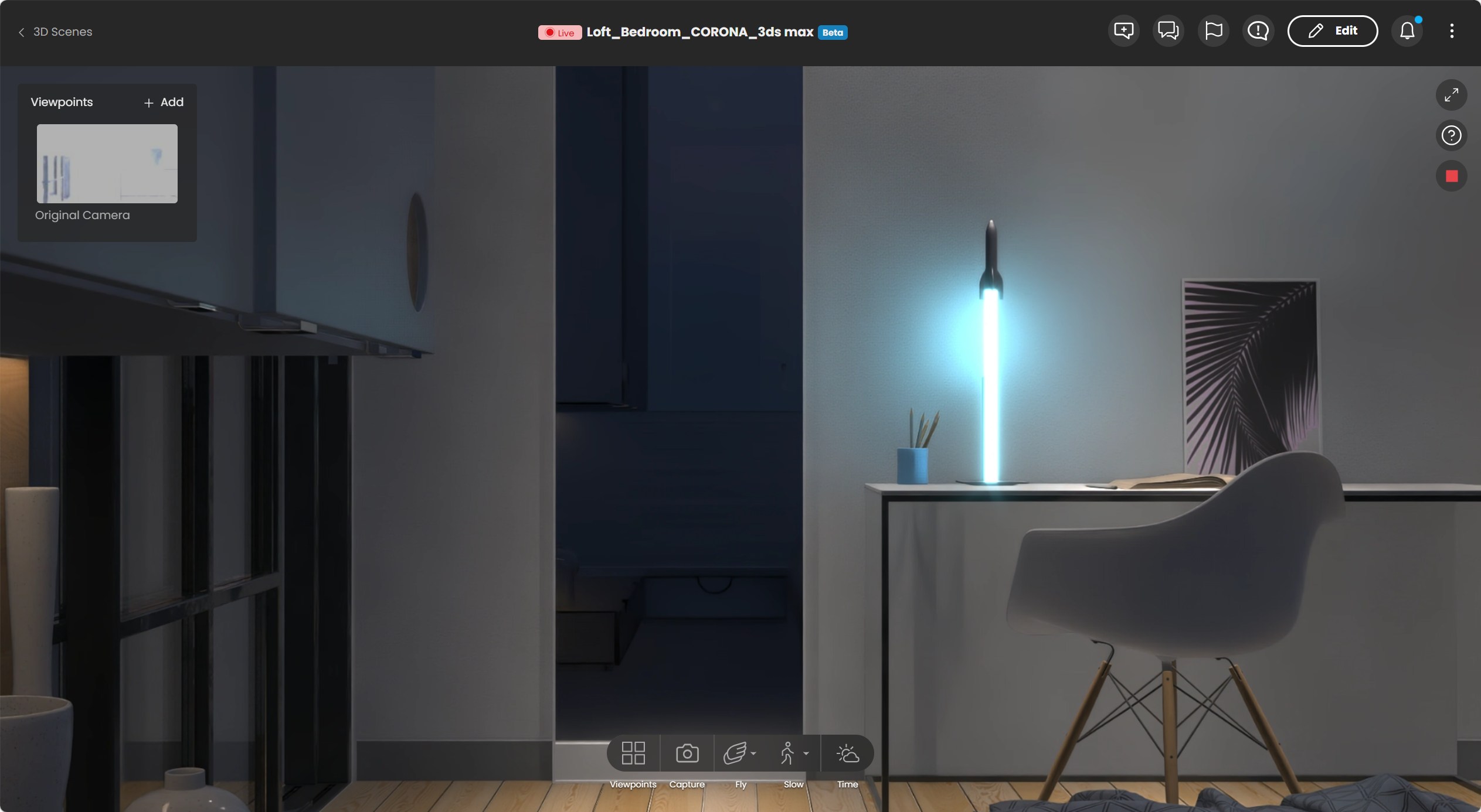

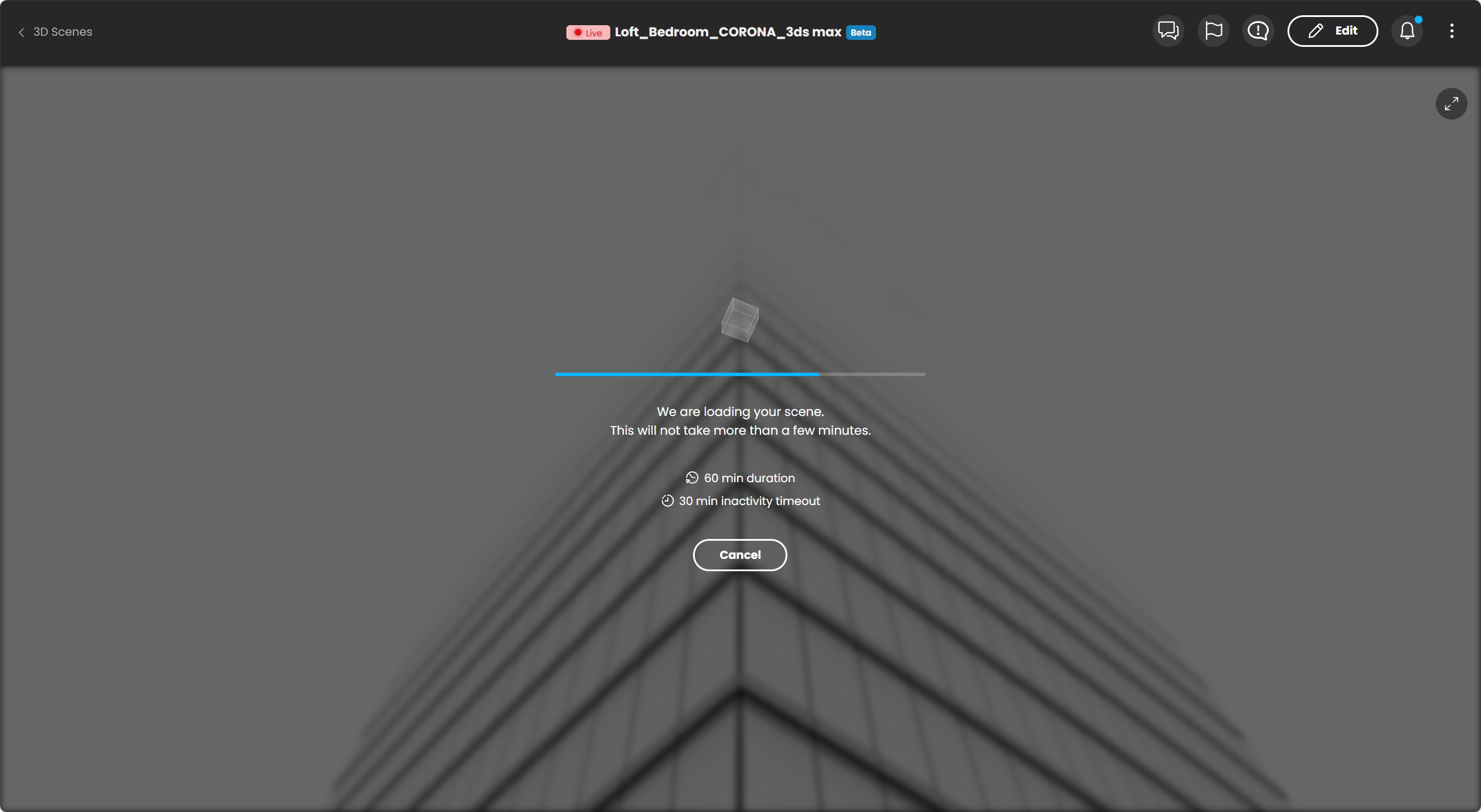

After the scene opens in Chaos Cloud, click the play button to start a 3D interactive session.
Confirm by clicking Yes, start.
The scene may take a few minutes to load.

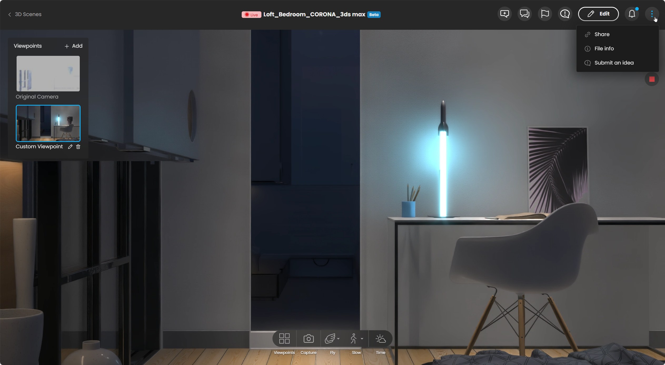

Once loaded, you can navigate the scene directly in the browser.
Available controls
You can use the toolbar at the bottom of the viewer to switch navigation modes, change movement speed, capture snapshots, save viewpoints, and adjust the time of day.

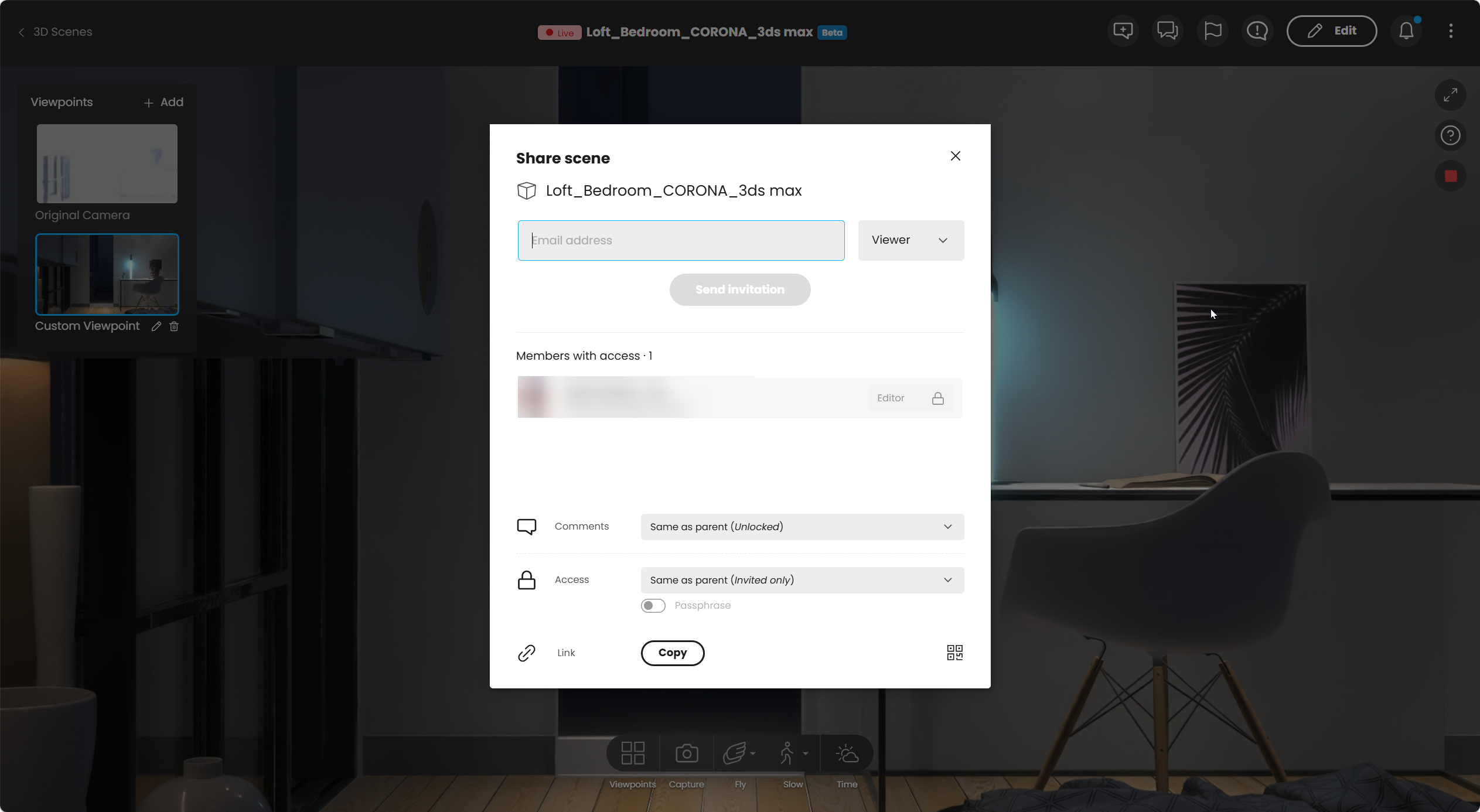

Sharing the scene
To share the uploaded scene, open the menu in the top-right corner and select Share.
In the Share scene window, you can invite users by email, assign Viewer or Editor permissions, and copy a share link.

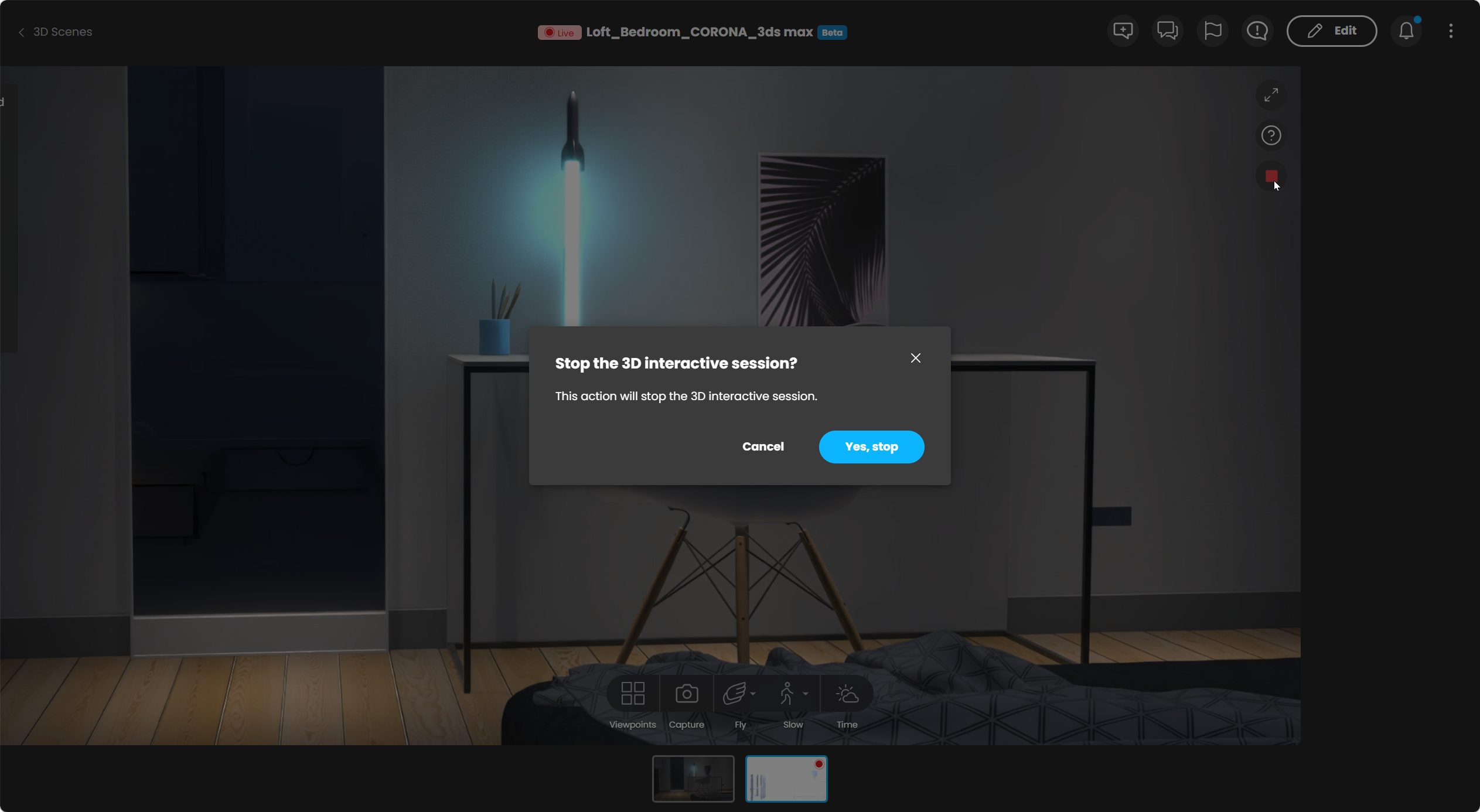

Stopping the session
To stop the 3D interactive session, click the stop button and confirm with Yes, stop.

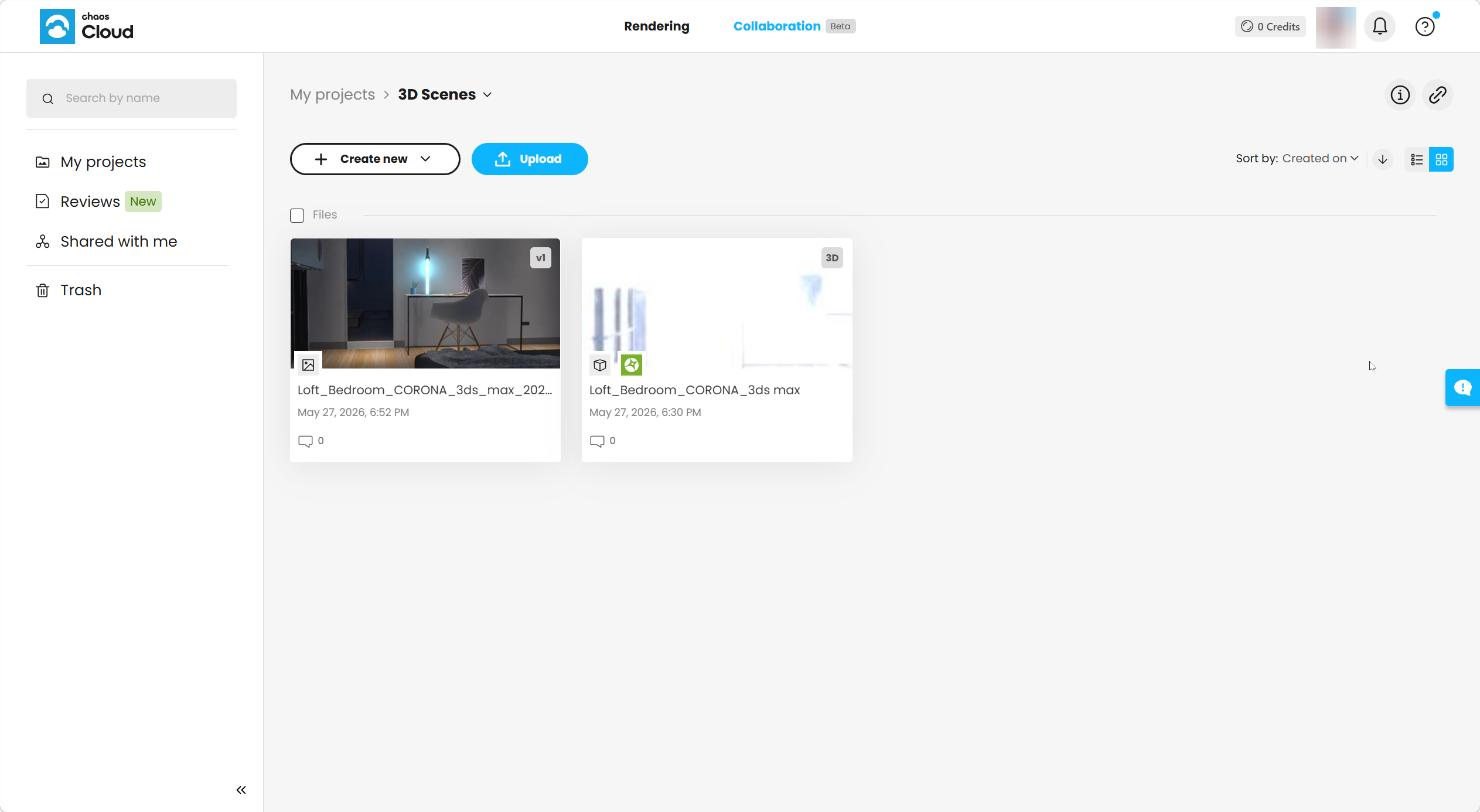

The uploaded scene remains available in Chaos Cloud under Collaboration > My projects > 3D Scenes.

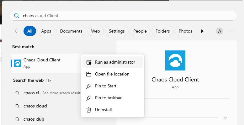

Troubleshooting: Update gets stuck
If a Chaos Cloud Client update gets stuck and fails to complete:
  1. Open the Start menu and search for Chaos Cloud Client.
  2. Right-click the app and select Run as administrator.
  3. Try the update again from within the app.
