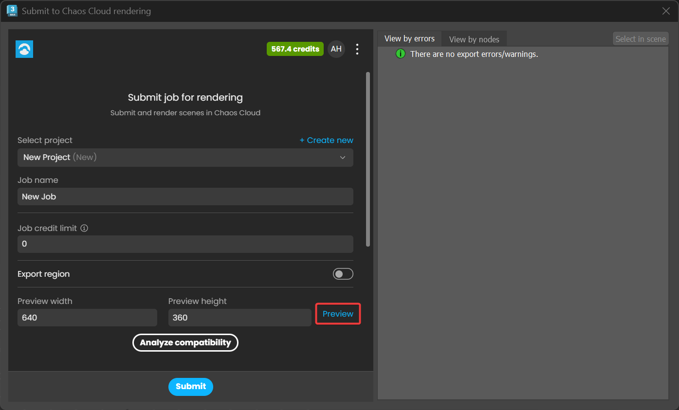

  • Render a Preview before submitting it to the Chaos Cloud
The submit to Chaos Cloud window offers an option to render a Preview. It will show a smaller resolution preview of what the render would look like when rendered on the Chaos Cloud. When using the preview, a .vrscene file is exported and rendered locally with V-Ray Standalone. The preview shows the closest result to the Chaos Cloud and can help you minimize the chance of unexpected errors.
Preview button's location

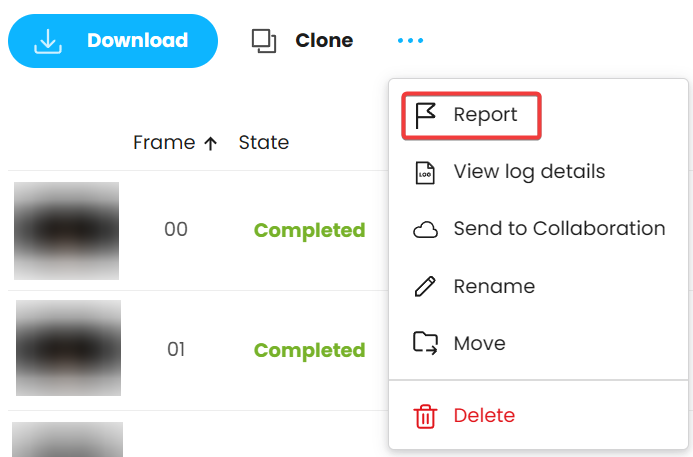

  • Reporting the Job in your Chaos Cloud account
Preview of the Report button's location
