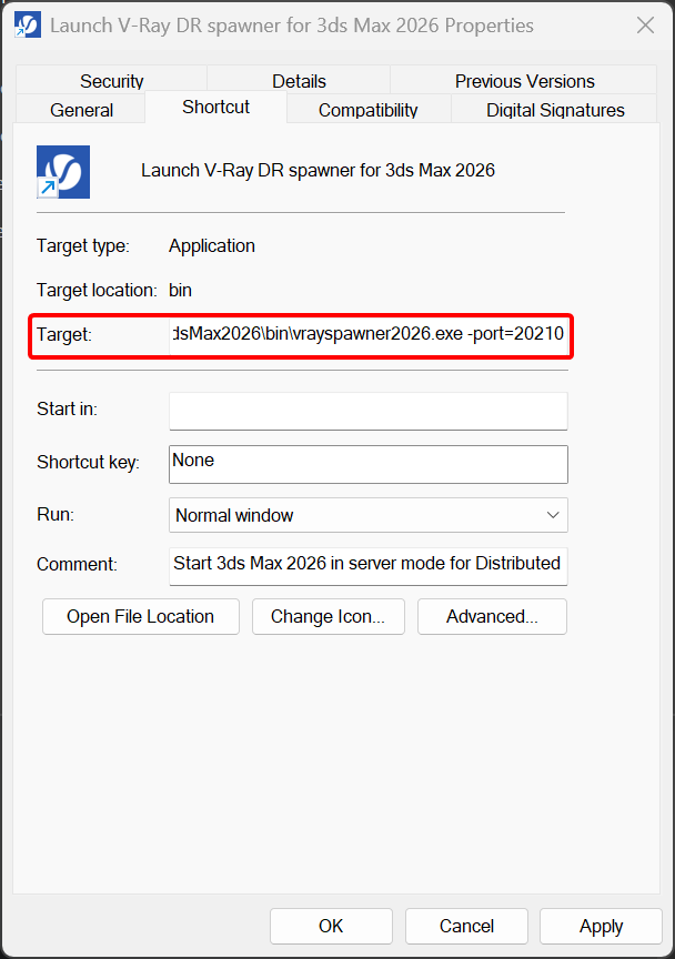

    • If the V-Ray Spawner is launched manually from the Start Menu, the port number can be changed from the Shortcut Properties by adding -port=20210 at the end of the Target value:
      Example setup of the "Launch V-Ray DR spawner" shortcut
  • If the V-Ray Spawner is launched from a Command Line you can change its port by using a -port=20210 argument:
    “C:\ProgramData\Autodesk\ApplicationPlugins\VRay3dsMax20XX\bin\vrayspawner20XX.exe” -port=20210

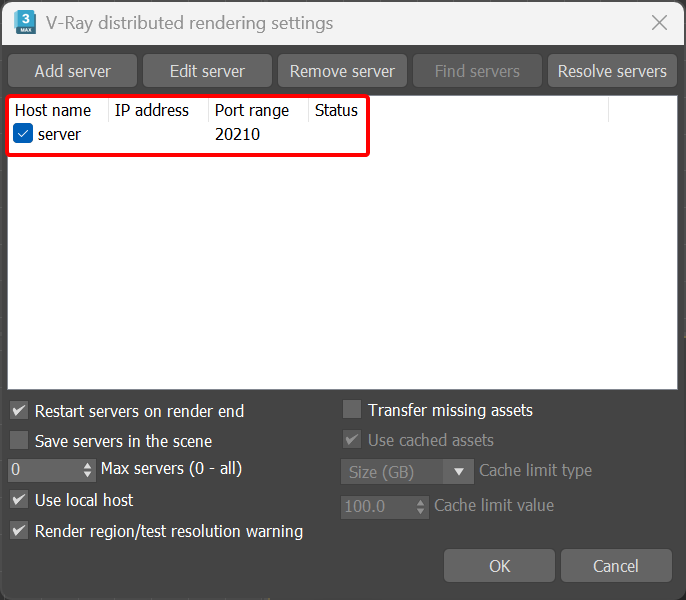

    To submit the job to the correct V-Ray Spawner, the port settings need to be adjusted in the V-Ray Distributed Rendering settings on the Workstation machine:
Example setup of a server's Port Range in 3ds Max

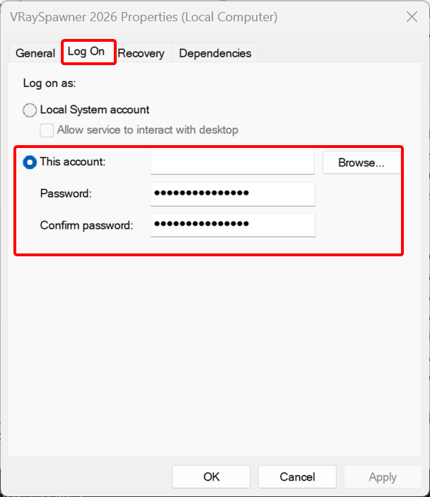

    • Inaccessible assets
      All shared assets need to be accessible by all Render Servers.
      A common problem with accessing assets stored on shared locations (with UNC paths or mapped drives) is caused by the V-Ray Spawner running as a Windows Service with Local System Account privileges. The Local System account is a predefined local account on Windows. It's the default account that the service uses, unless otherwise specified. The service has complete unrestricted access to local resources, but has no access to shared locations, as share permissions cannot be granted to the Local System Account. To allow the V-Ray Spawner to access network assets, the V-Ray Spawner service must be registered with a Windows Account with proper access permissions to the network shares.
      This can be done from Window Services > V-Ray Spawner Properties > Log On tab:
      Example setup of the VRaySpawner service Log on options

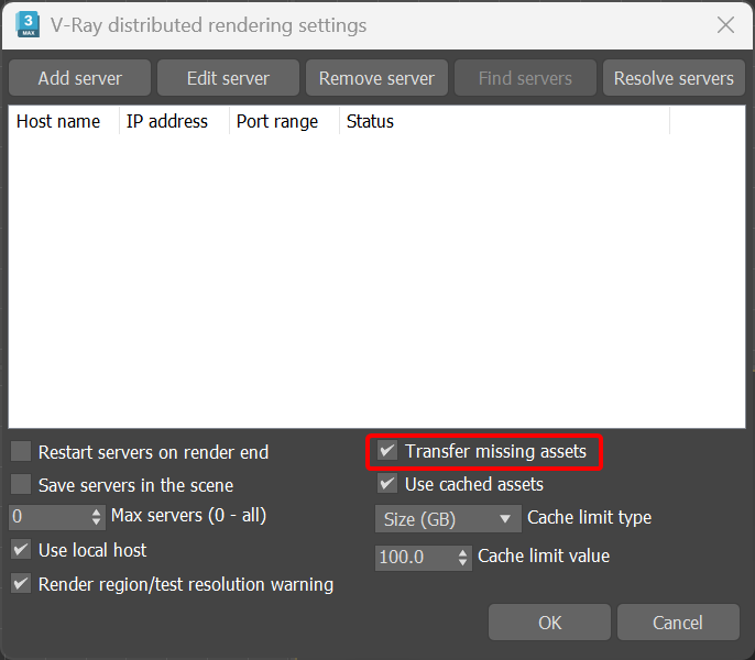

    • Using Mapped Drives instead of UNC paths
      We recommend using UNC paths (f.e., "\\server\project\") to access network resources instead of mapped drivers (f.e., "Z:\project")
      An easy solution may be enabling the “Transfer Missing Assets” option from Distributed Render Settings is a useful option when an asset cannot be accessed by the render servers.
