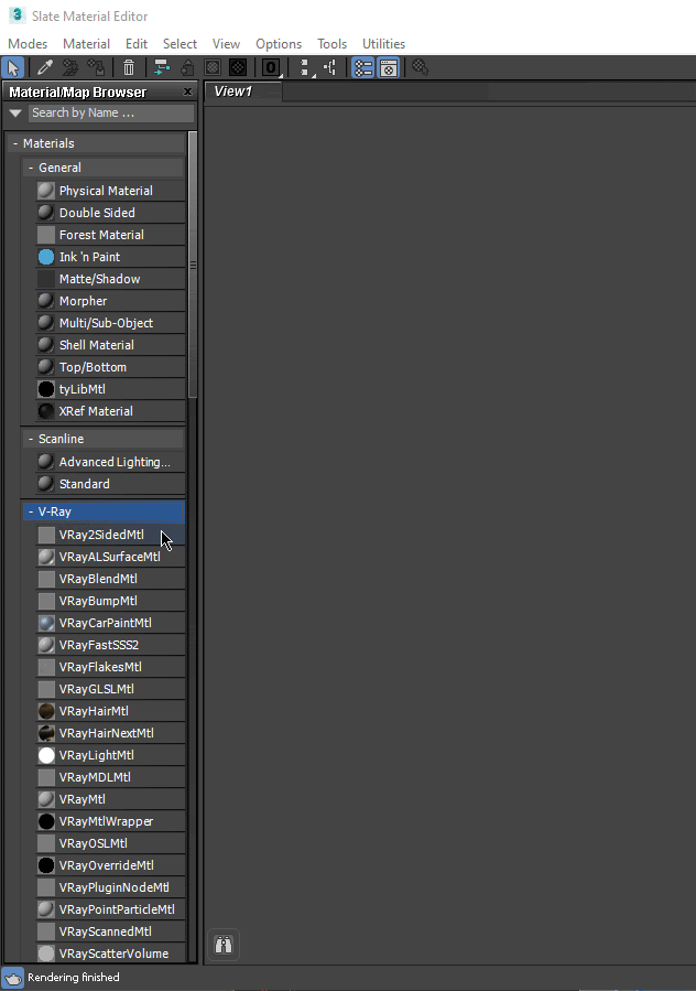

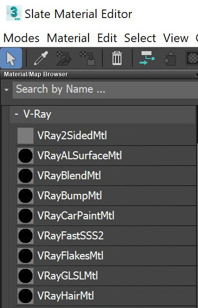

Sometimes, when opening the 3ds Max Material Editor, the material swatches may be rendered black in the Material/Map Browser, or the Sample slots may be rendered with a flat color.
Preview of the incorrect swatches in the Slate/Compact Material Editor

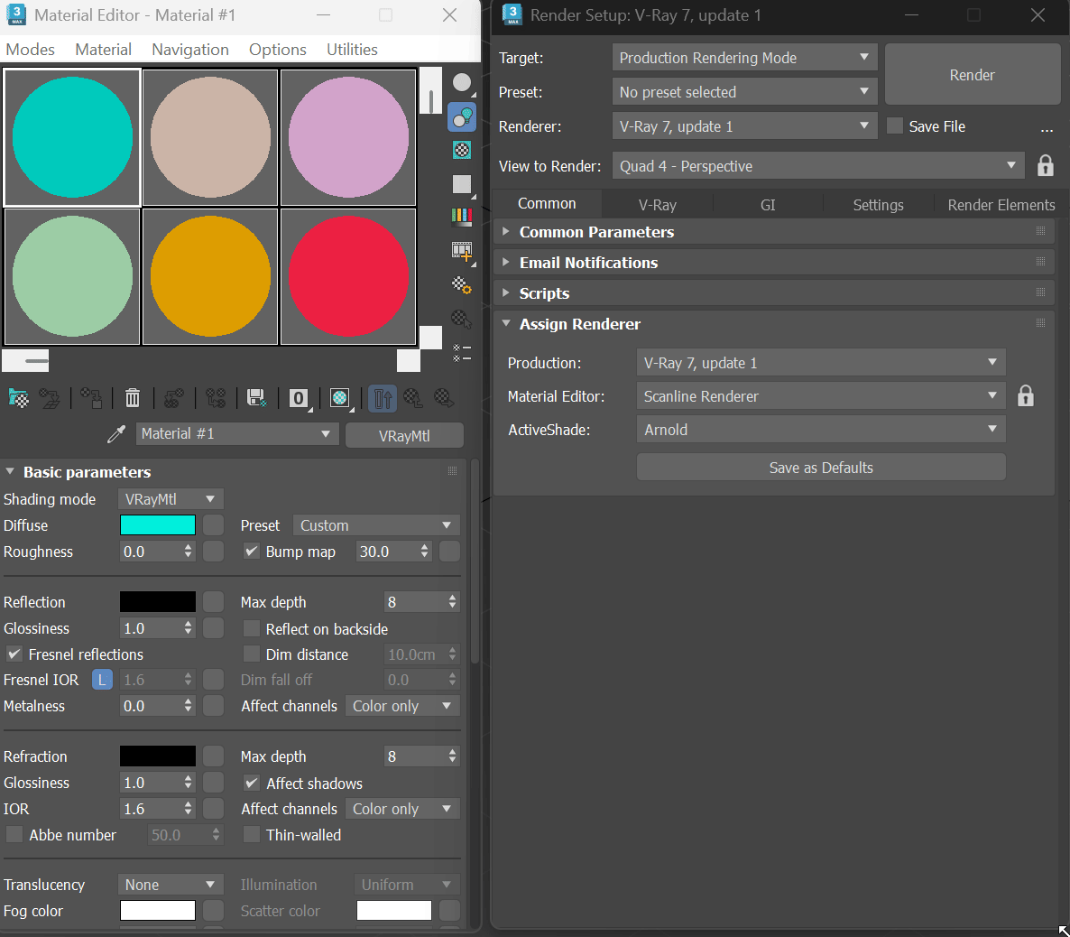

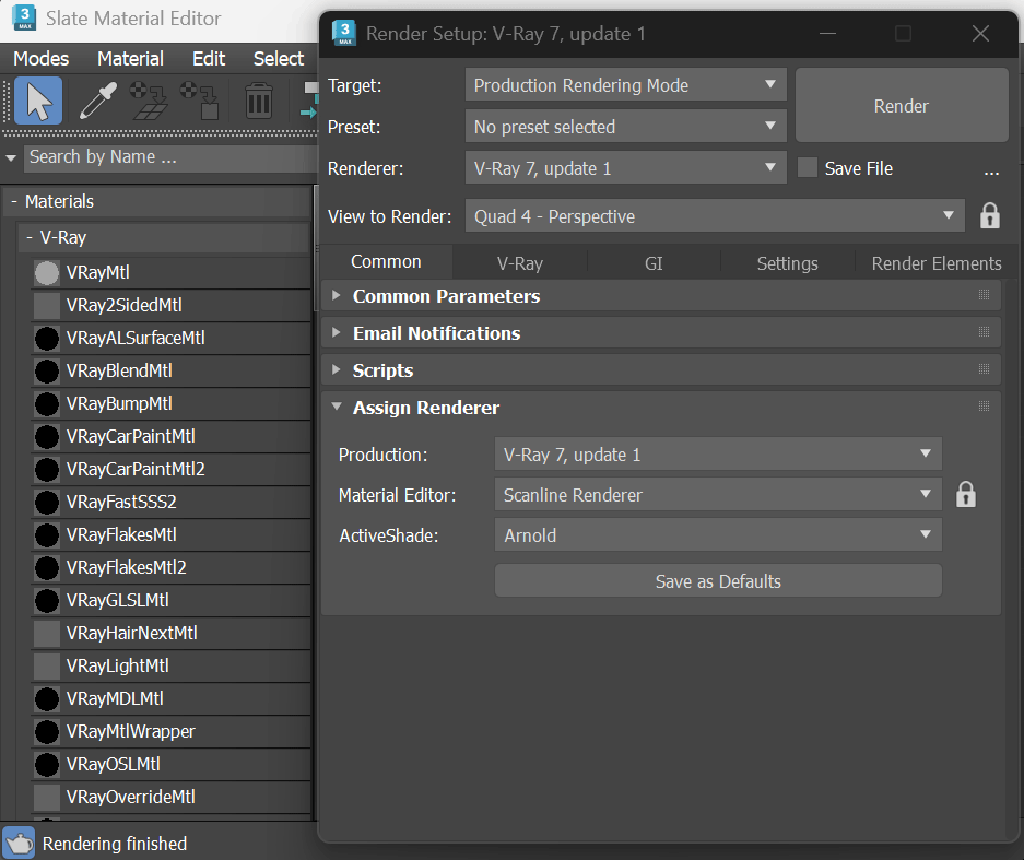

V-Ray is not set as the Material Editor’s Renderer
By default, V-Ray is set as the render engine for the Material Editor. In some cases, however, another renderer might be selected, which will cause the V-Ray material swatches to render black.
To render them, assign the renderer to V-Ray manually from Render Setup > Common > Assign Renderer > Material Editor.
Assigning V-Ray as a renderer for the Material Editor

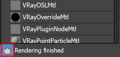

Rendering in the Material Editor is Disabled
The swatches will not render if rendering for the Material Editor is disabled.
Make sure that rendering is enabled by toggling the Teapot (teapot.png) button in the lower-left corner of the Slate Material Editor window.
Location of the Teapot button in the Slate Material Editor

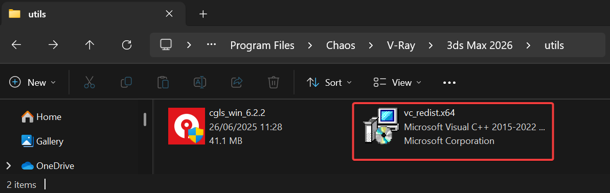

Reinstalling Microsoft Visual C++ Redistributable
For Windows users, in some cases, the installer may not install the necessary Microsoft Visual C++ Redistributable properly, leading to swatches in the Material Editor rendering black.
Reinstalling it manually through the setup file "vc_redist.x64.exe" included in the V-Ray utils folder (C:\Program Files\Chaos\V-Ray\3ds Max 20XX\utils) may resolve the issue.
Location of the Microsoft Visual C++ Redistributable setup file
