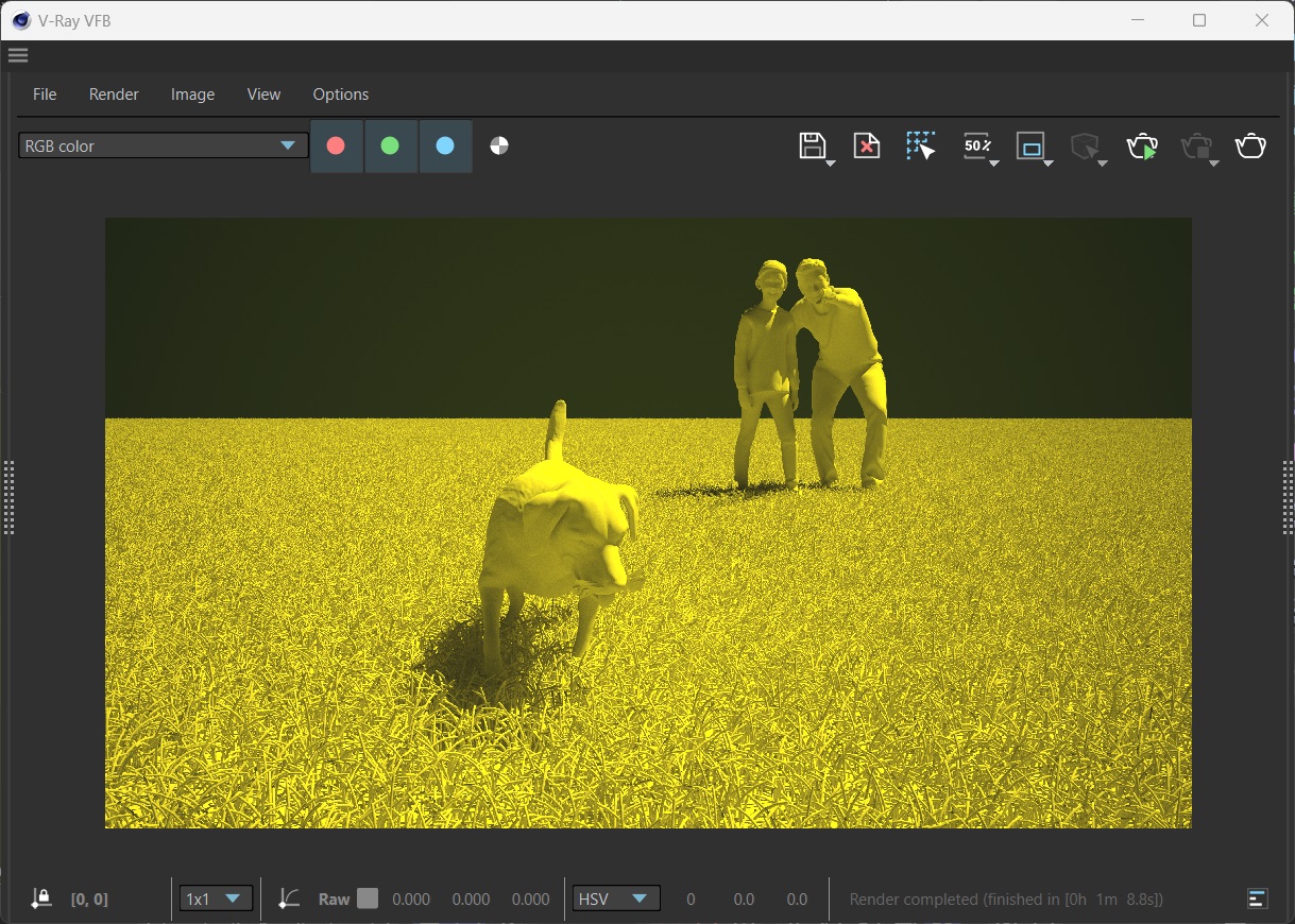

The yellow or white coloring of the rendered result, similar to the one shown below, is usually caused by unsupported materials or maps in V-Ray IPR:

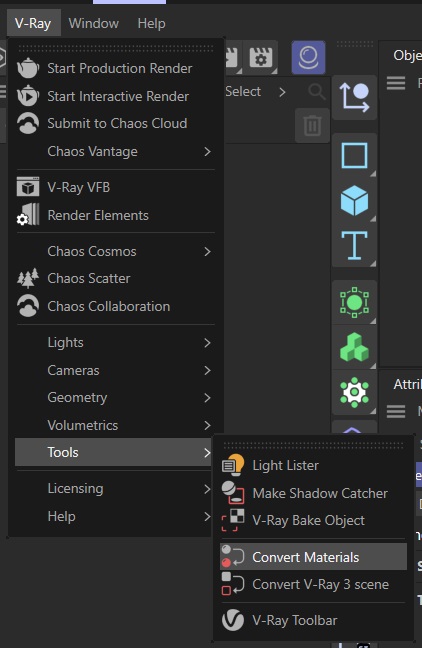

Convert all native Cinema 4D materials to V-Ray Standard materials by using the Convert Materials Tool that you can find in V-Ray > Tools menu:

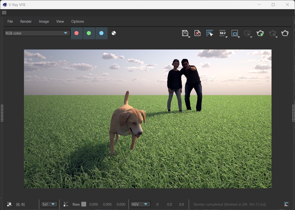

After conversion, V-Ray IPR should render correctly:
