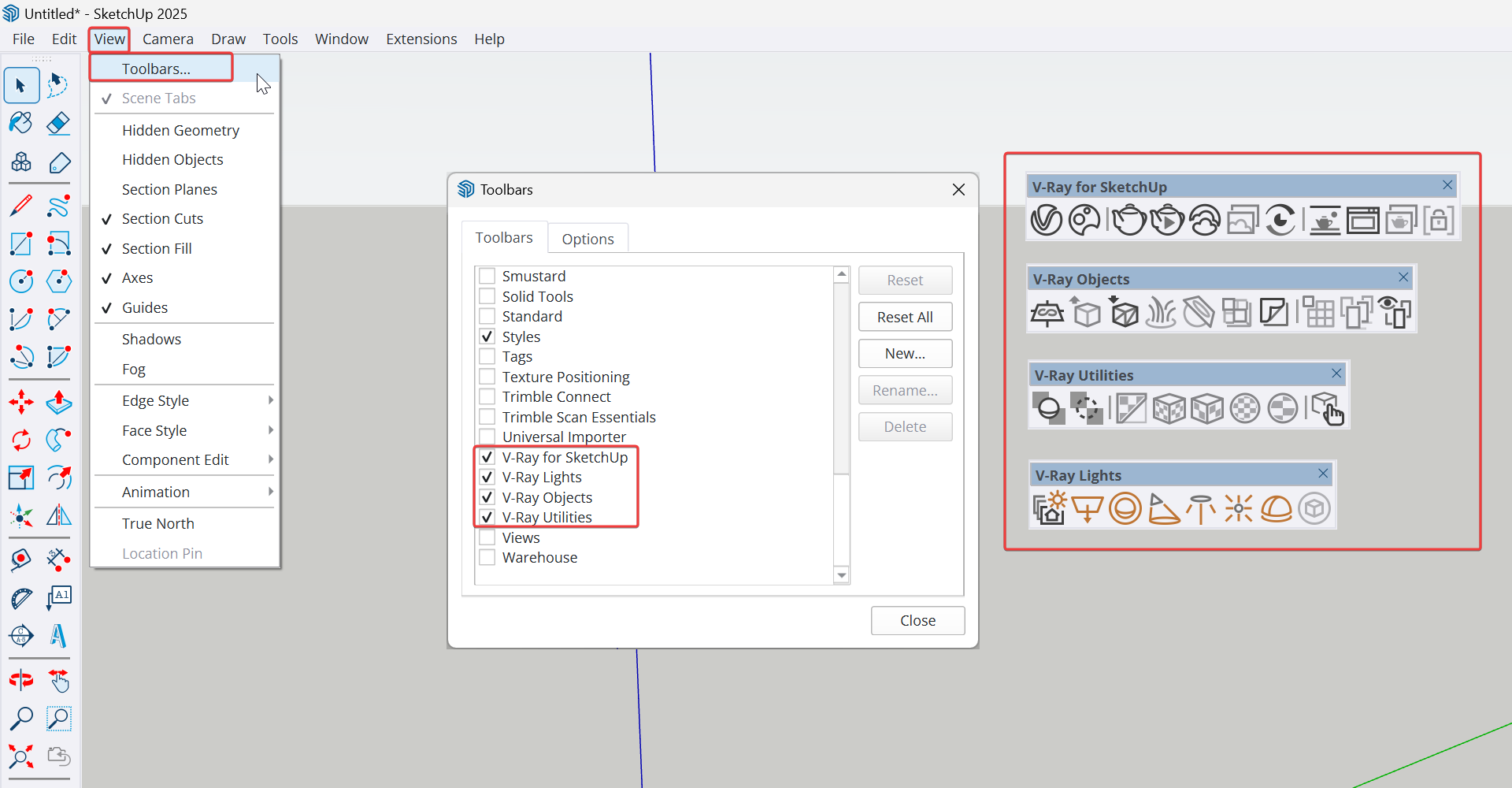

Windows: When using SketchUp for Windows, the V-Ray Toolbars can be found under SketchUp > View > Toolbars.

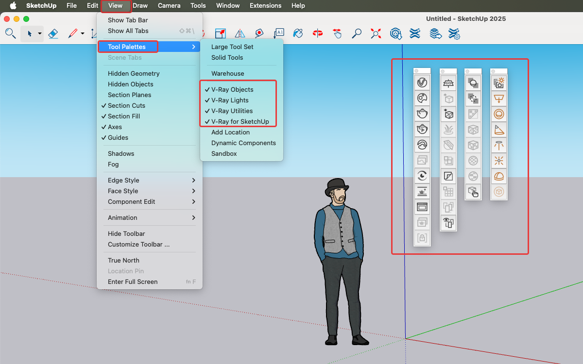

macOS: The V-Ray Toolbars, called palettes in SketchUp for macOS, can be found under SketchUp > View > Tool Palettes.
How to enable V-Ray Toolbars on Windows
How to enable V-Ray Tool Palettes on macOS
