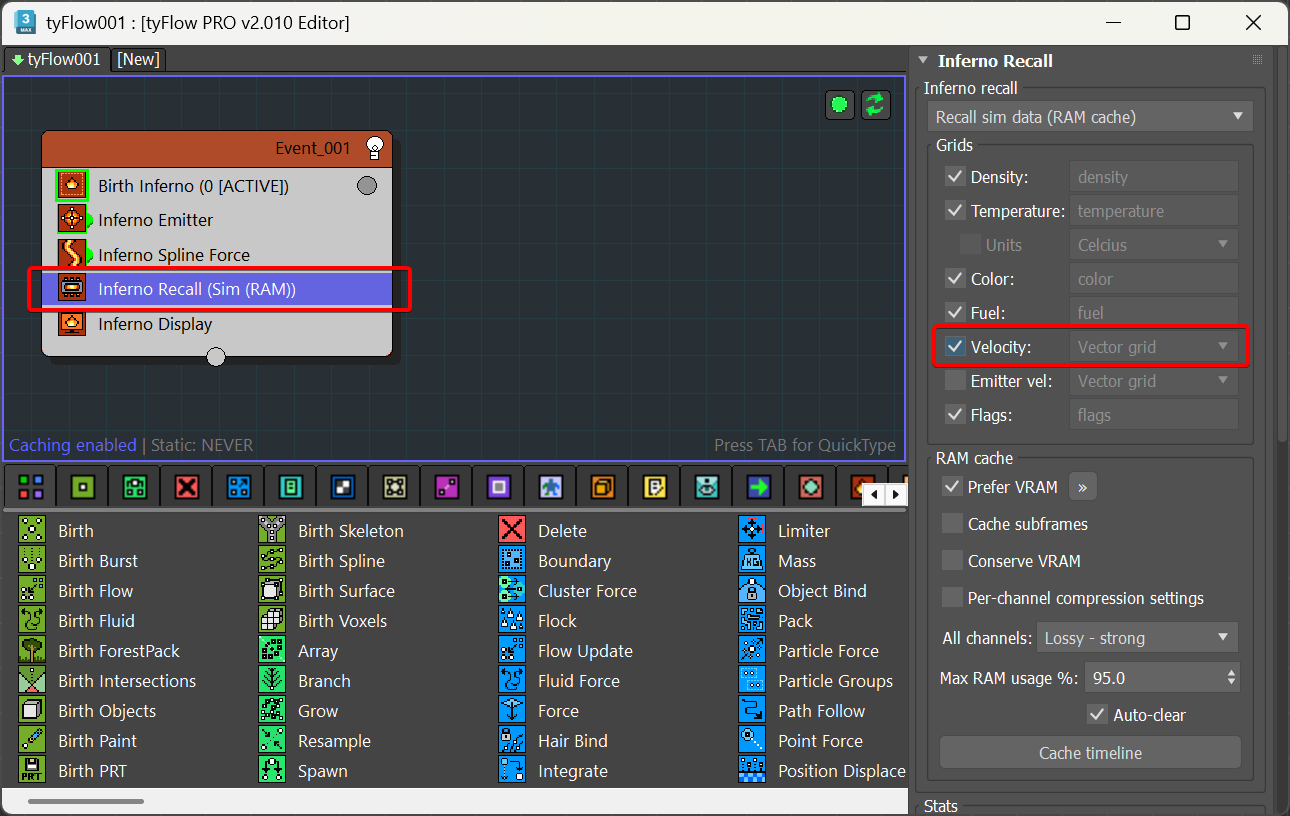

For Inferno simulations:
Make sure you have the Velocity grid enabled in your Inferno Recall (Sim (RAM)) operator. Then enable motion blur in Corona (either in Render Setup > Camera or in your currently used Corona Camera - see this article for more information: How to enable and control motion blur? ).
