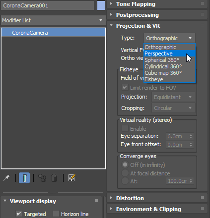

  • Disable the orthographic projection option in the active camera - for example, switch to perspective projection mode - this is the simplest and most effective solution, however, it will change the appearance of the rendered image because of the change in the camera projection type.
Note: setting a very narrow field of view in a camera and moving it far away from the scene objects can create a similar effect as using the orthographic projection mode. This can be used as a workaround.

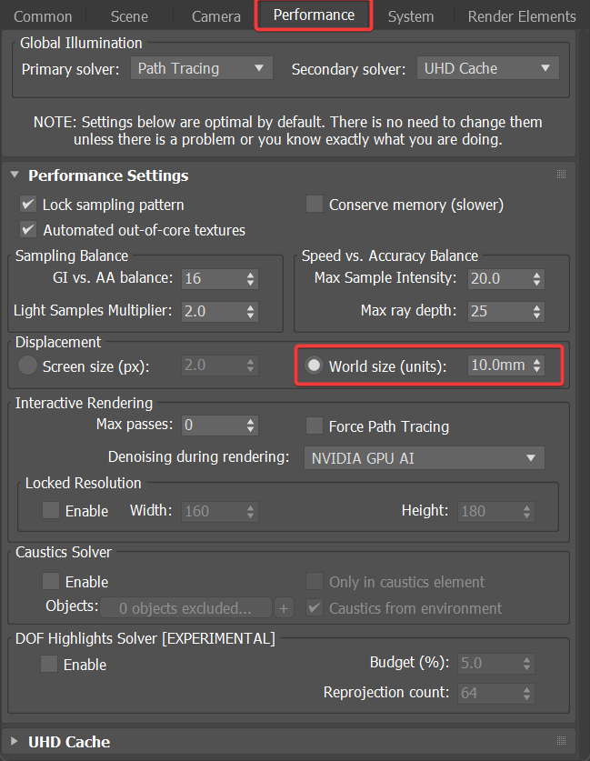

  • Change displacement calculation method from screen size to world size (Render Setup > Performance > Displacement) - this should prevent the extreme RAM usage in most cases while maintaining the appearance of the scene. Remember to use the highest possible displacement world size value, otherwise (when using too small values) high memory usage may become an issue again.
