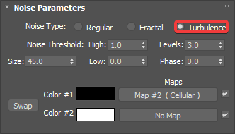

- Noise
- Noise type: Turbulence is not supported, the map will be rendered as if this parameter was set to Fractal
- Noise phase: not supported

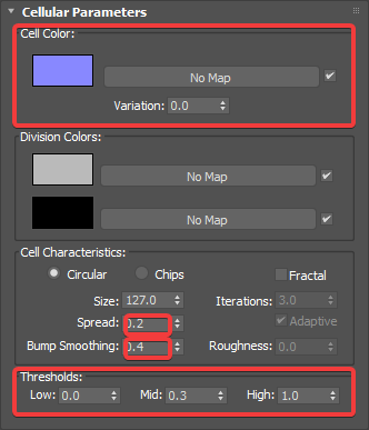

- Cellular
- Cell color variation: not supported
- Cell spread: not supported
- Bump smoothing: not supported
- Fractal (and its sub-parameters: iterations, adaptive & roughness): not supported
- Thresholds rollup: not supported

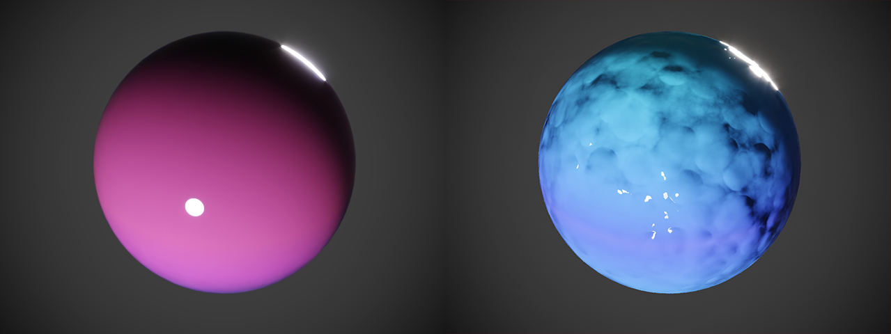

Here is an example scene of how the rendered outcome can differ between Corona standalone and Corona for 3ds Max, when maps with unsupported parameters are exported. (Corona Standalone export left, Corona VFB in 3ds max right)
(image comparison: https://corona-renderer.com/comparer/YVhQiV)
The scene contains a Corona material with many currently unsupported map parameters. A cellular map utilizing different cell color, altered spread, bump-smoothing characteristics as well as different thresholds, all of these parameters are currently unsupported for Corona Standalone.
Additionally, the Noise Map in our scene is using the Turbulence parameter which is also unsupported, as well as edited hue shift for the Color Correction map, advanced lightness, saturation, and lastly slight noise for the Gradient Map all of which are currently not supported and won't be exported successfully to the Corona Standalone.
