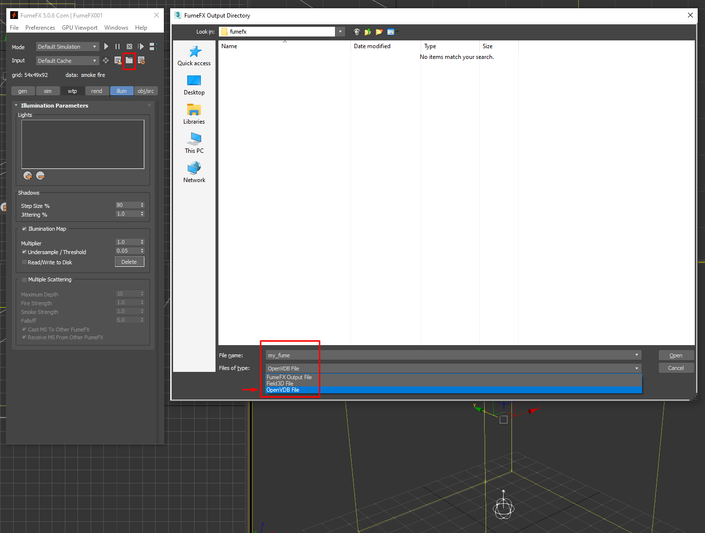

When your FumeFX setup is ready, go to FumeFX UI, click on the Output Directory icon (folder icon at the top), navigate to the folder where you wish to store your simulation, enter your file name (for example "my_fume") and select the "Open VDB file" format from the "Files of type" list below. Click "Open" to save your changes:
 Now run your FumeFX simulation. This will save it as a series of VDB files, which you can then load using the Corona Volume Grid object.

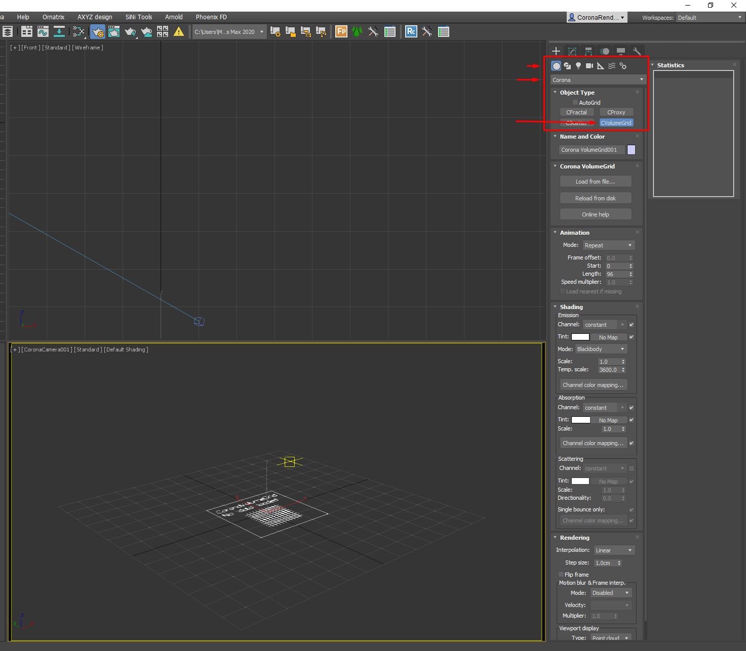

Go to Create > Objects > Corona > CVolume Grid and Create the Corona Volume Grid object anywhere in your scene:

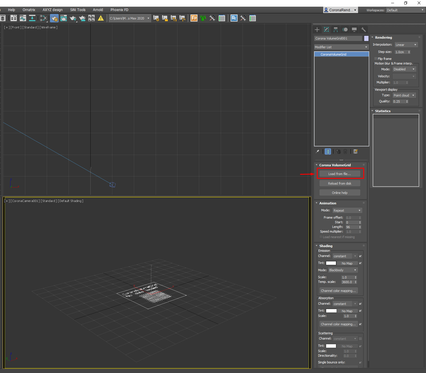

Press "Load from file..." and pick the first file of your VDB simulation:

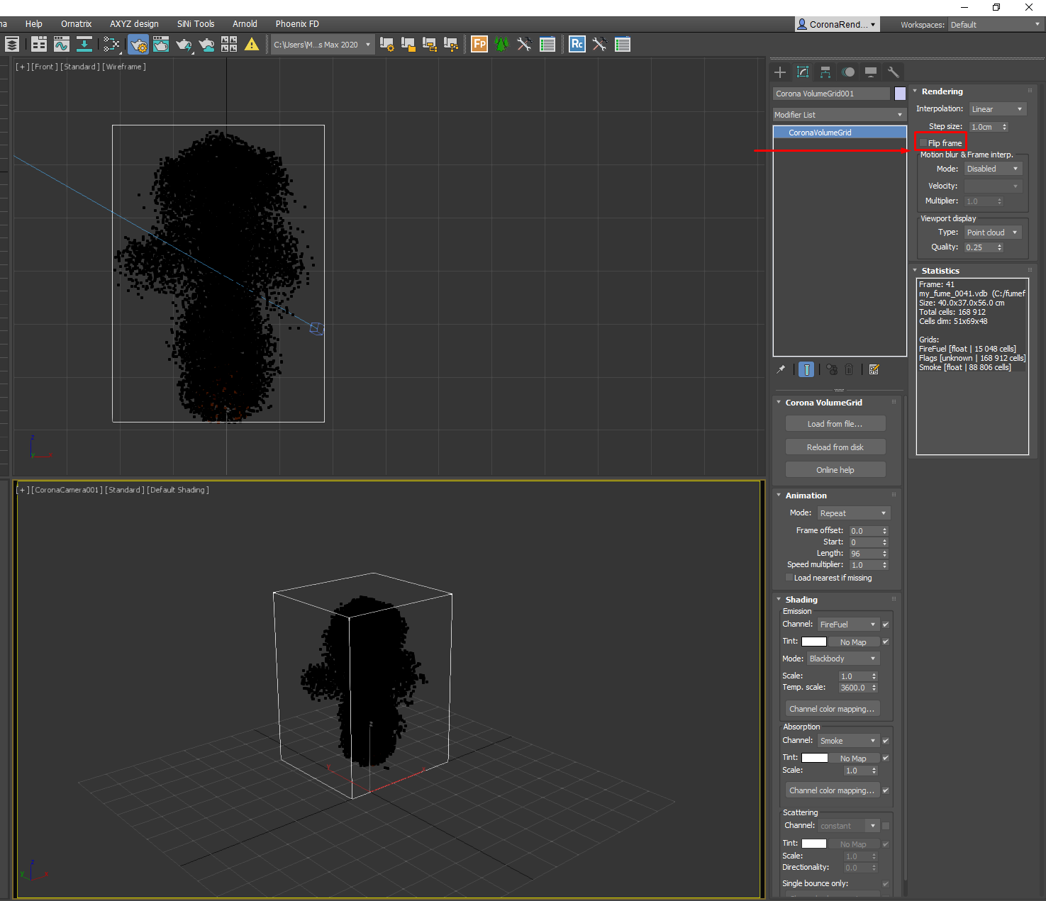

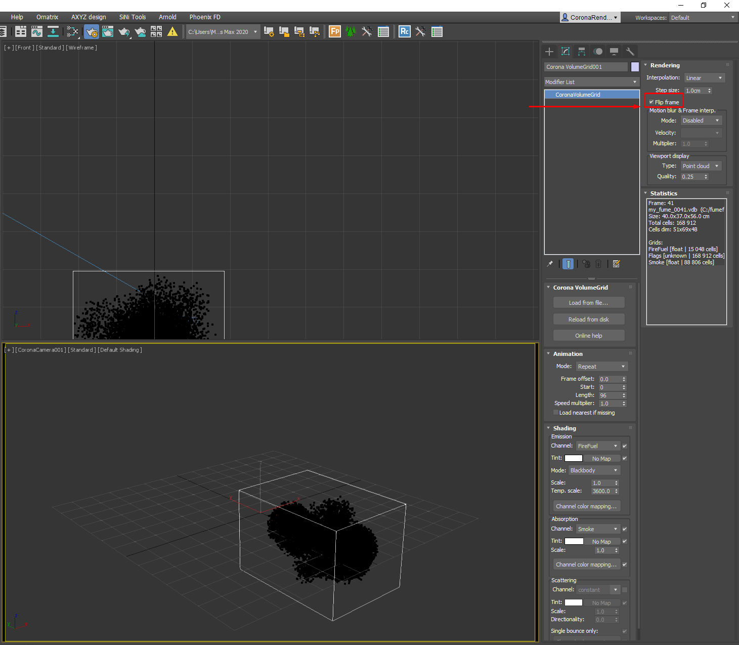

Note 2: you may need to check or uncheck the "Flip frame" option, which will rotate the Volume Grid object by 90 degrees:
"Flip frame" on:
"Flip frame" off:

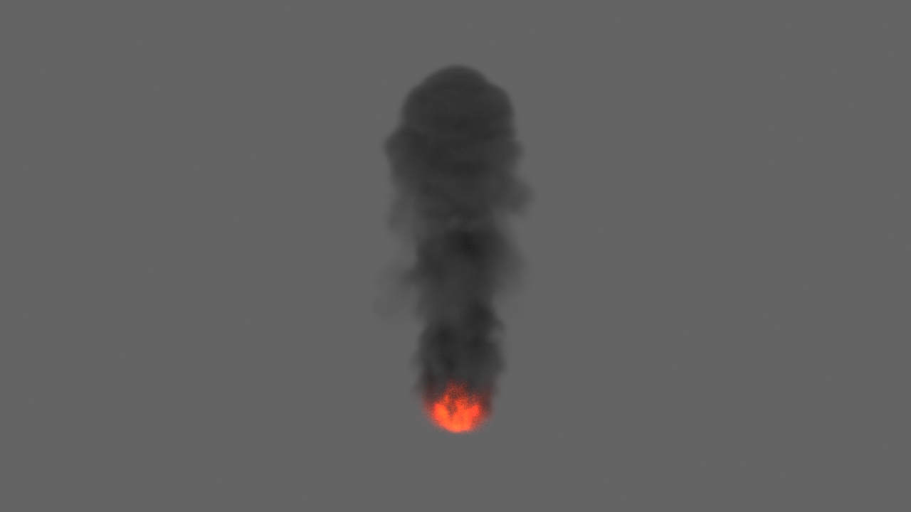

End result:
Using either of the above methods, the end result should be identical or similar to the original FumeFX simulation:
