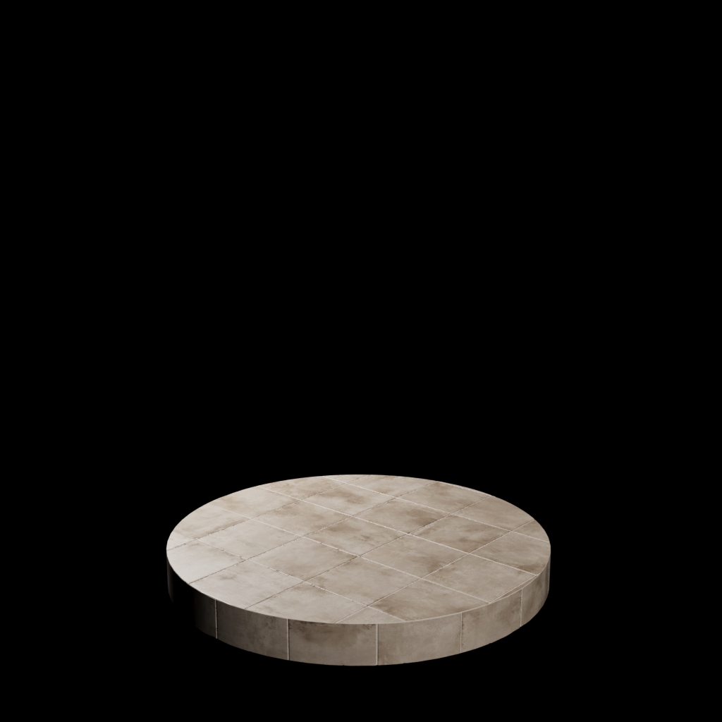

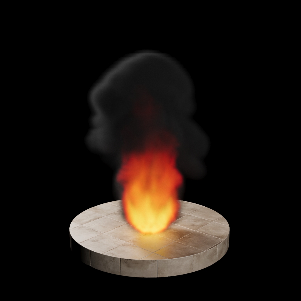

A scene rendered without the CoronaFumeFXMod modifier applied to the FumeFX object: | The same scene rendered with a CoronaFumeFXMod modifier applied to the FumeFX object: |

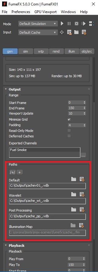

Set up the path to a folder where the resulting VDB files will be stored:
