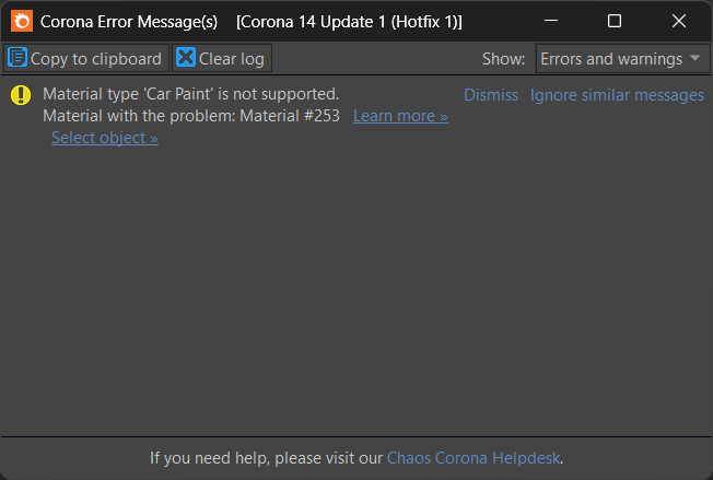

Material type X is not supported. Material with the problem: Y
This message means that some of the materials in the rendered scene are not compatible with Corona. This usually happens when using materials native to other renderers.
Please either manually replace the problematic material with a Corona-compatible one, or use the Converter Script to automate the process for large scenes with high numbers of materials.

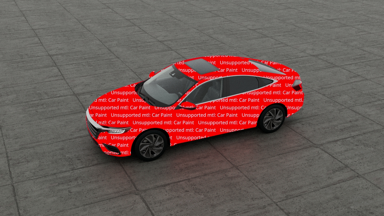

Unsupported material displayed in a rendered image.

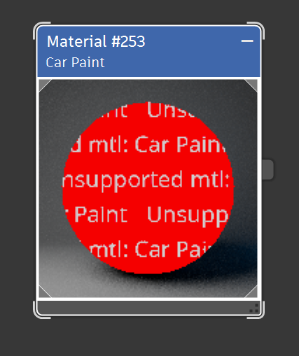

Unsupported material displayed in the material editor.
