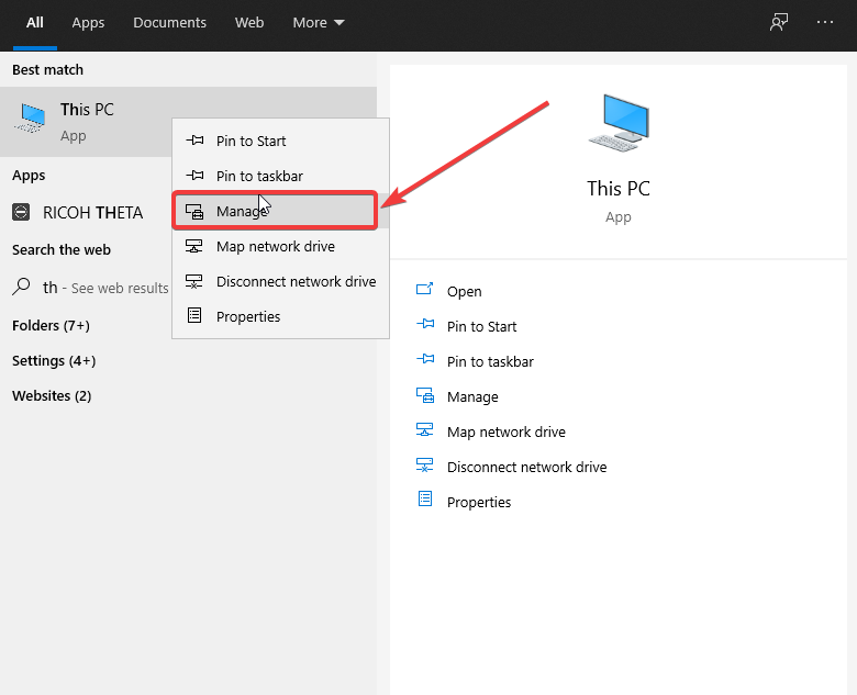

  1. Click the Start menu.
  2. Right-click Computer and click Manage:

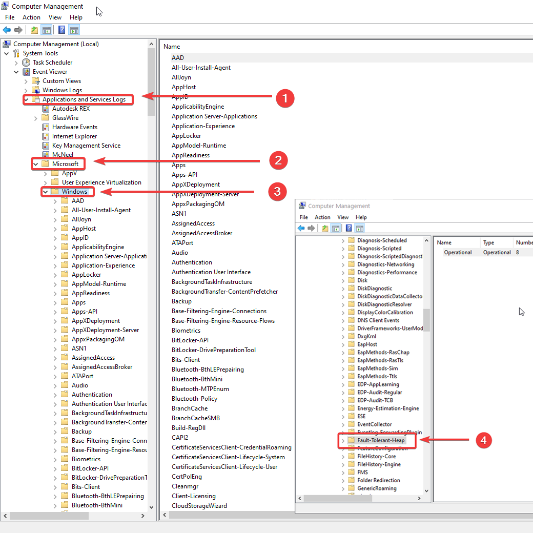

  3. Click Event Viewer > Applications and Services Logs > Microsoft > Windows > Fault-Tolerant-Heap:

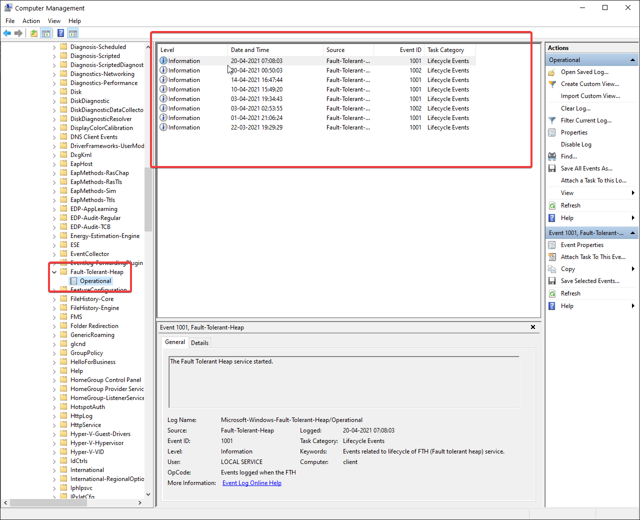

  4. View FTH Events:
The service stop and start events contain no additional data. The FTH Enabled event contains the Process ID (PID), the process image name, and the process instance start time.
