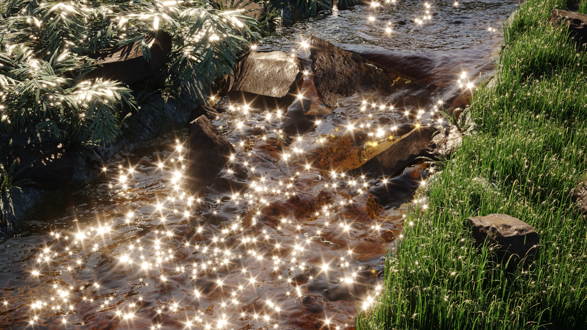

Bloom enabled (glare size is set to 0) - note that the bright pixels are now surrounded by soft halos, making them appear more natural:

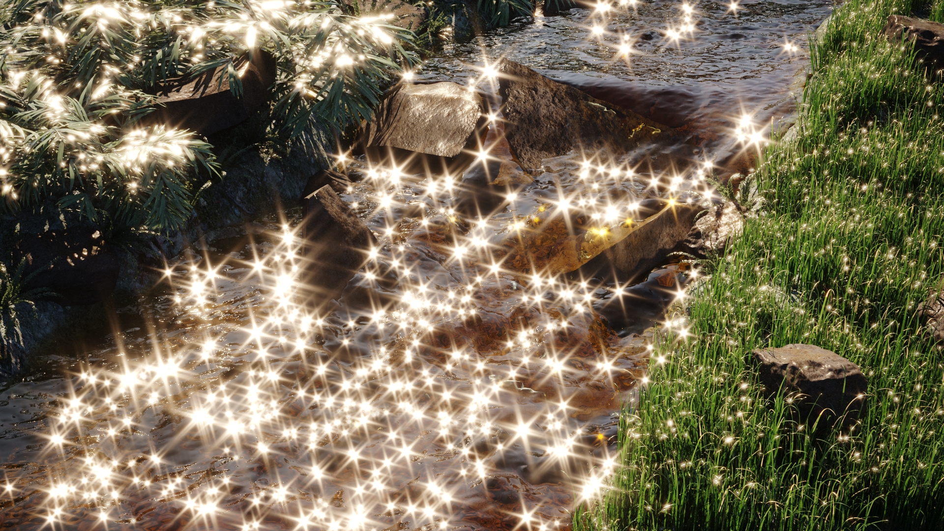

Glare enabled (bloom size is set to 0) - note that the bright pixels are now turned into star-shaped flares:
