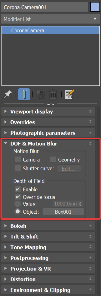

Depth of Field
Depth of Field can be easily toggled on and off from the Corona Camera’s UI, and the focus can be set by picking any object in the scene using the Override focus > Object option. The selected object’s pivot will be used to determine the position of the focus point. This is especially useful if the focus should be locked on a moving object during animation.
Depth of field can be enabled for the Corona Camera, and the focus point can be locked to the pivot of a specific object.
Note: Starting from Corona 12 Update 1, the Depth of Field (DOF) indicator in the viewport was introduced to help visualize a camera's focus range before rendering. It displays near and far planes around the focus point, representing the in-focus area; objects between these planes will appear sharp, while those outside will blur based on the F-Stop setting.

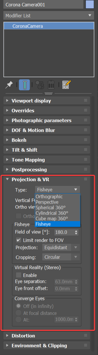

Virtual Reality and Panoramas
VR, panoramic, and fisheye projection can only be enabled when using the Corona Camera. They can be found under the “Projection & VR” rollout.
The Corona Camera features various projection modes.

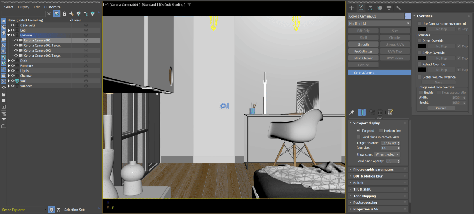

  • You can easily resize the Camera’s viewport icon using the Icon size option under the Viewport display rollout.
  • The camera's viewport icon changes according to the currently used VR mode (spherical, cylindrical, etc.)

Starting from Corona 15, each Corona Camera can override the global output resolution set in Render Setup > Common > Output Size. This lets you assign a different resolution and aspect ratio to individual cameras in the same scene, without having to change the render settings every time you switch cameras.
The controls are found in the Overrides rollout, under Image resolution override:
Enable - turns the per-camera resolution override on. When enabled, this camera's Width and Height are used for rendering instead of the global output size.
Keep aspect ratio - when enabled, changing Width or Height adjusts the other value automatically to preserve the current aspect ratio.
Width / Height - the resolution used when rendering from this camera.
Refresh - updates the render output to match the camera's override values.

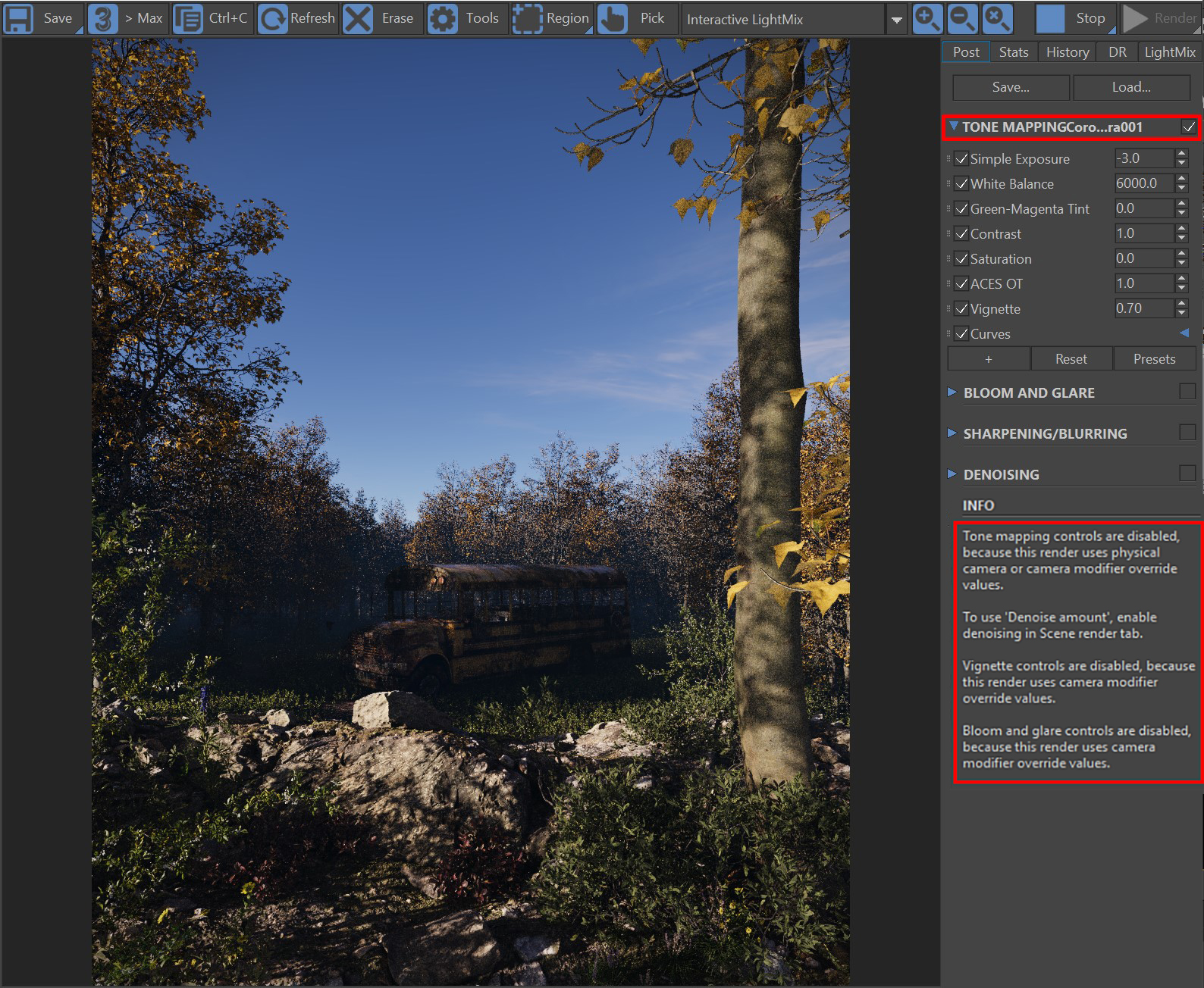

When rendering from a Corona Camera:
  • By default, any Corona Camera uses the same settings as the perspective view (the exposure, tone mapping, and post-processing settings available under Render Setup > Camera and inside the Post tab of the Corona VFB)

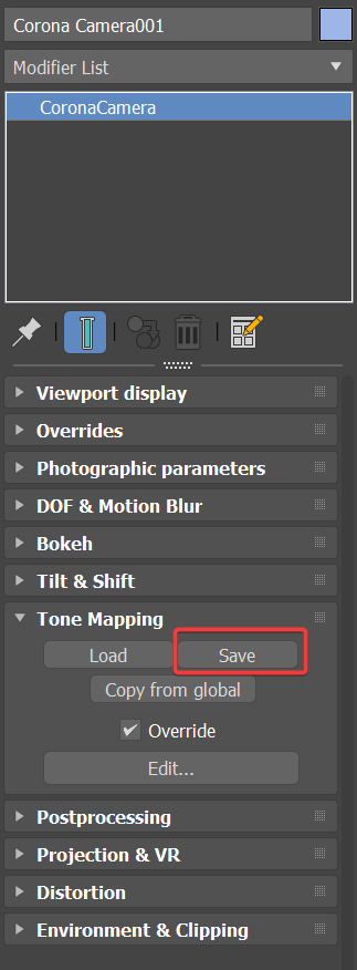

  • If the "Override" checkbox is enabled in the Tone Mapping rollout of a Corona Camera, then this camera uses its own tone mapping settings. The tone mapping stack can be edited, saved, loaded, and also copied from the global settings:
  • Additional "Override" checkboxes can be enabled in the Postprocessing rollout to override bloom and glare and sharpening and blurring options:

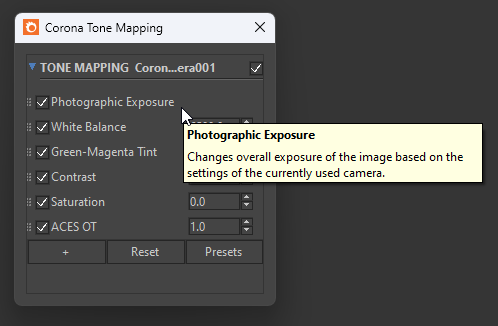

  • To use photographic exposure based on the photographic parameters available in a Corona Camera (ISO, f-stop, shutter speed), go to that camera's Tone Mapping rollout and make sure that:
    • The "Override" checkbox is enabled
    • That camera's tone mapping stack ("Edit..." button) includes a Photographic Exposure tone mapping operator:

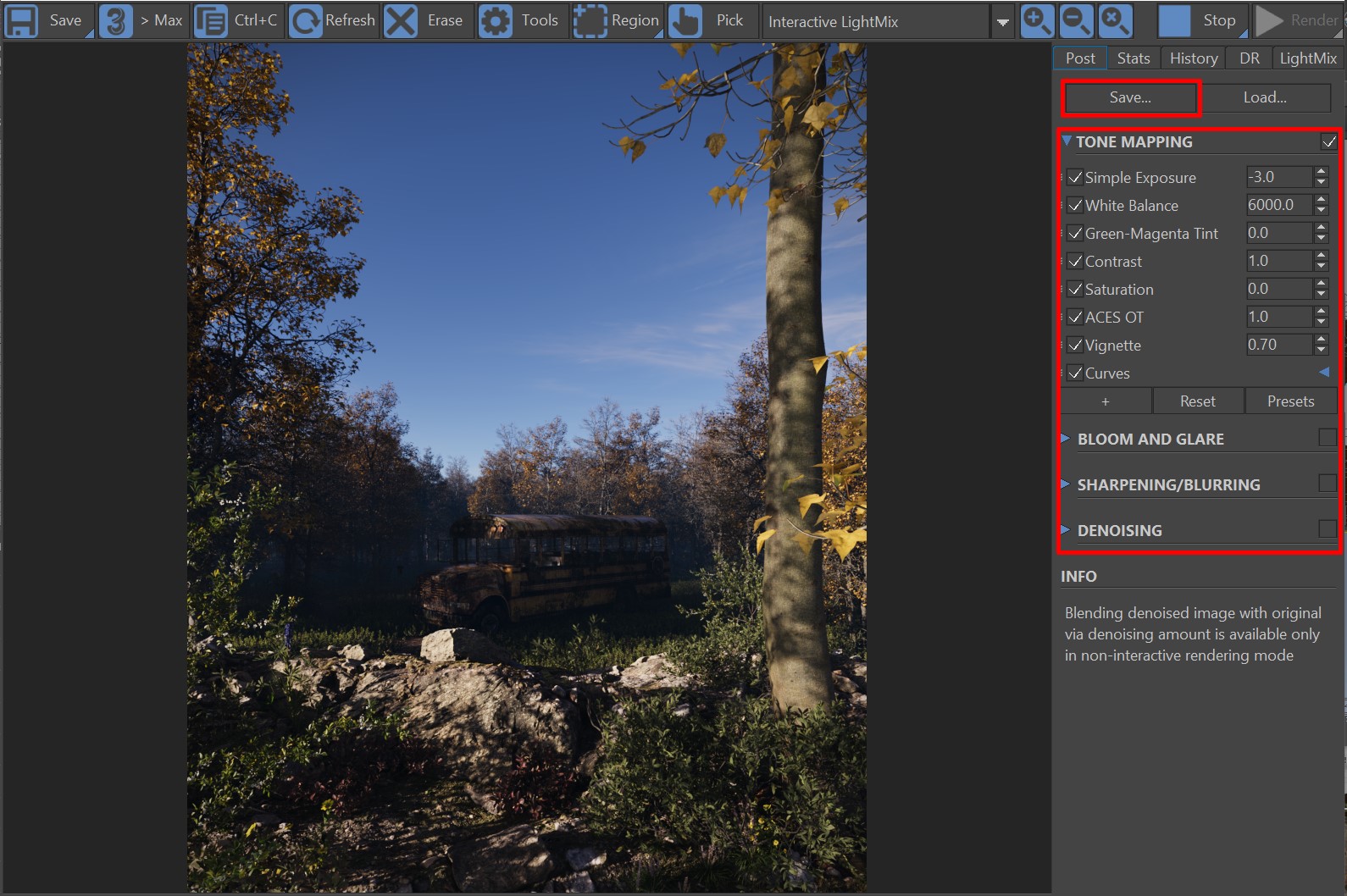

Saving and loading the tone mapping and post-processing settings

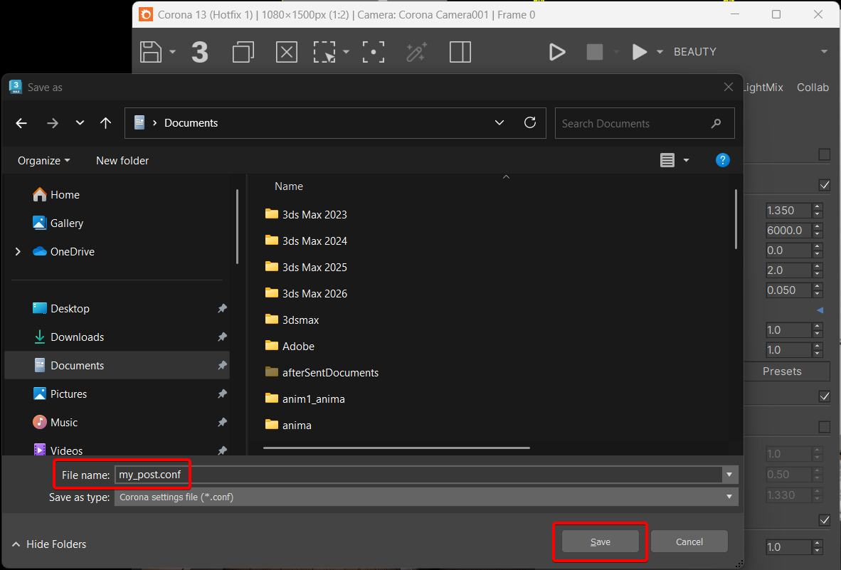

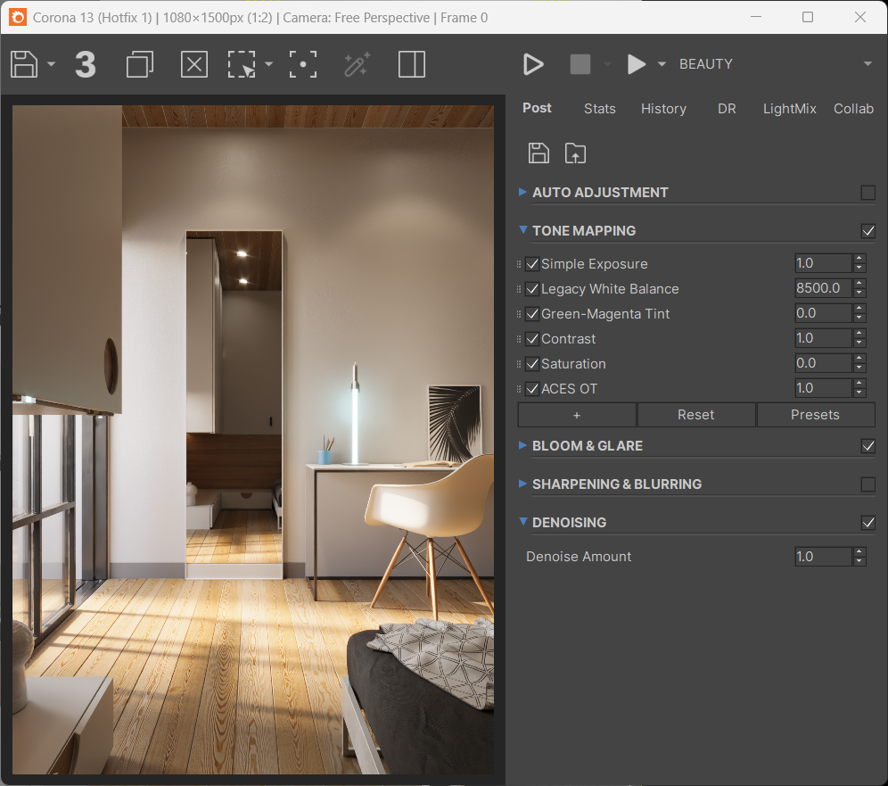

The Corona VFB offers Save and Load options, which can be used to save and load tone mapping and post-processing settings using the special CONF file format. These settings can be freely exchanged between the Corona VFB and the Corona Camera. This allows, for example, for:

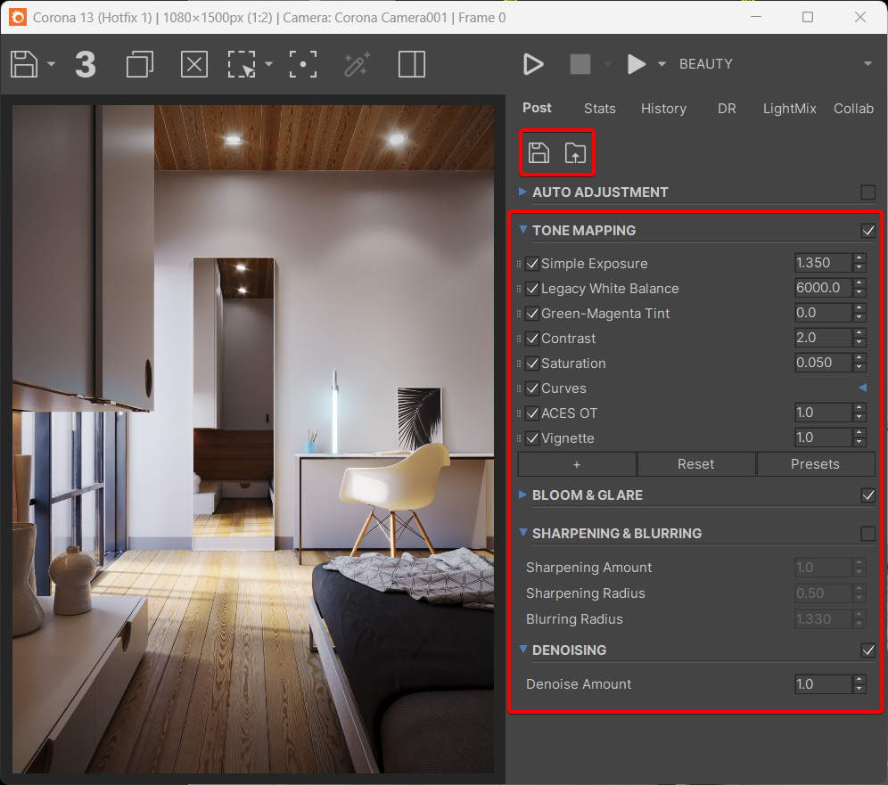

  • Defining the look of the image using the Post tab of the Corona VFB, and then moving those settings to a Corona Camera.
  • Creating various post-processing presets, which can be then loaded into different Corona Cameras and the Corona VFB.
  • Setting up multiple Corona Cameras with different post-processing settings, and then loading those settings from one of them into the VFB.
The Corona VFB's Post tab features various tone mapping and post-processing options, and the possibility to save and load them.

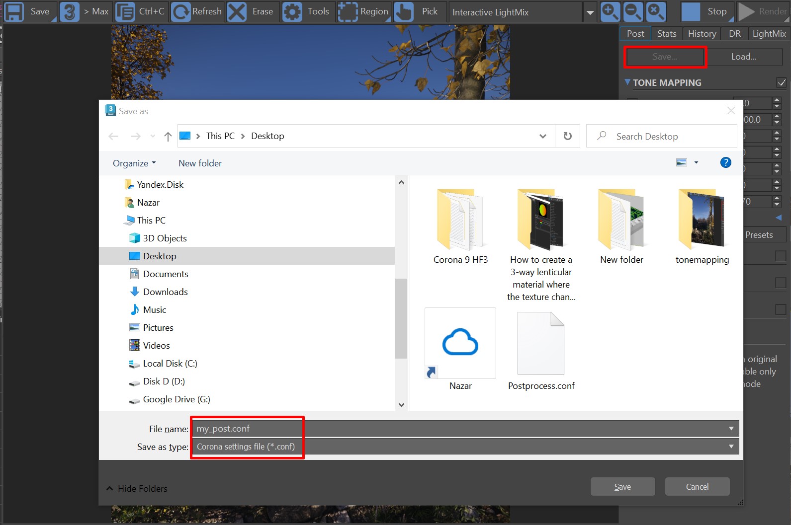

After clicking the Save button, you can save your custom preset as a CONF file.

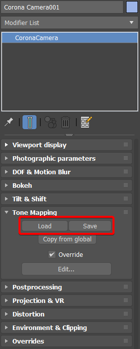

You can then load the CONF file saved from the VFB into a Corona Camera (and vice versa).
If the CONF file is loaded into the Corona Camera, and the Override checkboxes are enabled in that Corona Camera (to override the VFB settings), you will see that our custom post-processing preset is now used for the rendered image. So first we set up our desired post-processing in the VFB, then we saved it as a CONF file, and then loaded that CONF file into the Corona Camera.
If we render a non-camera view (in this case a free perspective view), only the settings available in the VFB Post tab will be considered. Once we render from the Corona Camera again, the CONF settings loaded in that Corona Camera will be used again.
