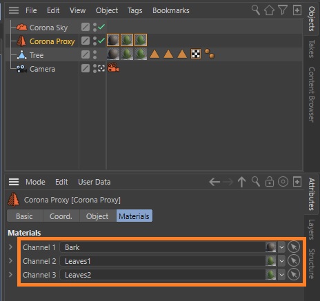

Materials:
Now that the proxy has been successfully loaded into your scene, you will note that it has it's own dedicated material tab. The materials are generated based on the selection tags that were previously assigned to the original mesh. This will allow you to replace a certain material by dragging a new one into the desired channel.
