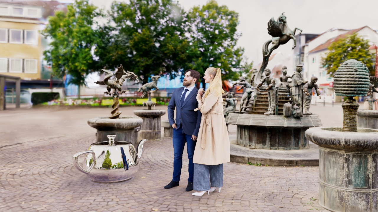

  1. As backgrounds and environments
    Gaussian splats can work better than regular HDRI images. They show correct depth when you move the camera or use depth of field. Objects in your scene can hide behind parts of the splat environment properly. This makes your backgrounds look more realistic.
    3D people and a reflective teapot composed into a Gaussian Splat environment. 3D Gaussian Splats Copyright 2026 Christian Rochner - 3ds-scan.de. Licensed under the CC BY-SA 4.0 license.

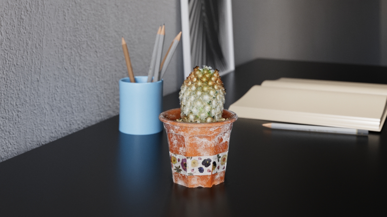

  2. As scanned objects
    You can use Gaussian splats to add real objects to your scene. These objects come with their original lighting and details already built in. This is perfect for adding complex real-world items without modeling them.
    A Gaussian Splat cactus in a pot placed in a 3D scene with visible reflections, provided by https://www.steam-studio.jp under Creative Commons CC0 license.

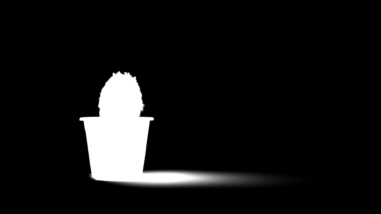

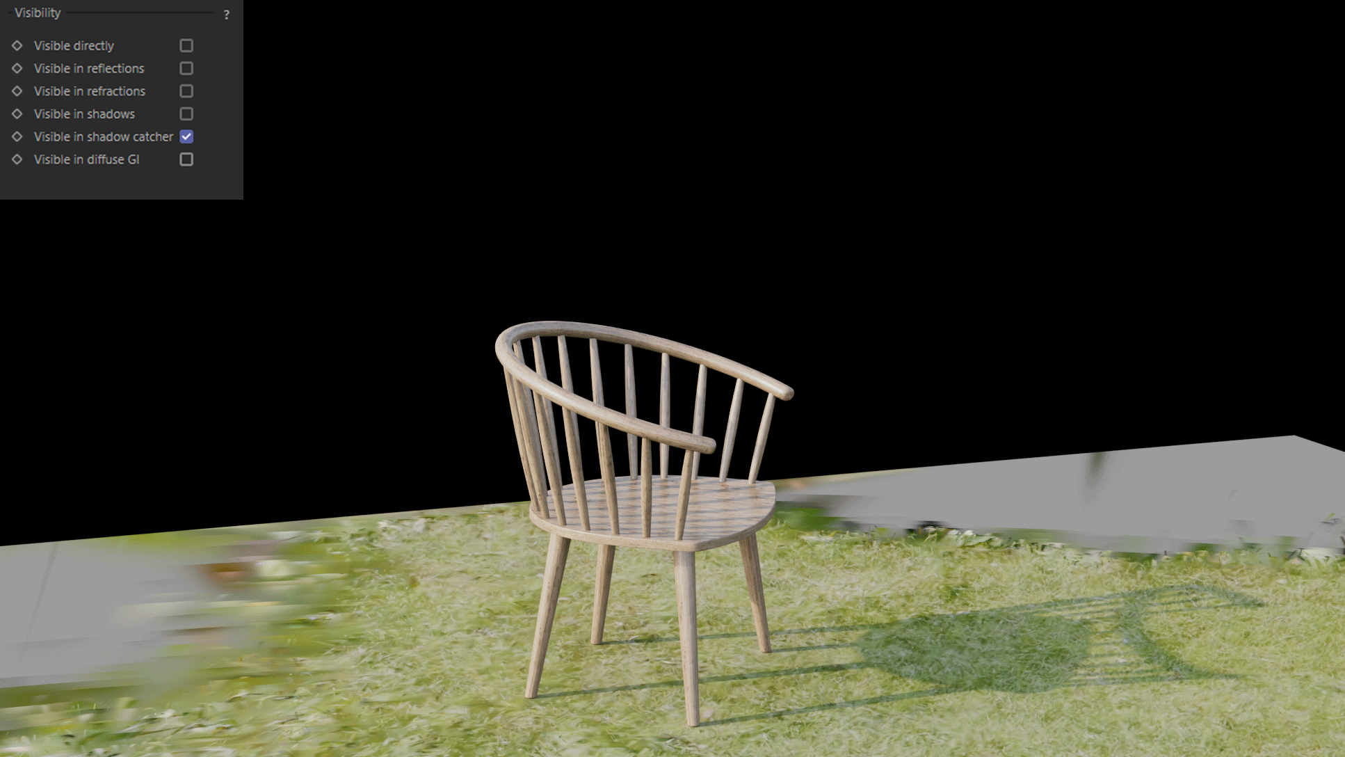

  3. For compositing work
    Gaussian splats work well with Corona's shadowcatcher materials. They appear correctly even when placed behind matte objects. This makes them useful for advanced compositing projects.
    Corona Shadowcatcher capturing the shadow of a Gaussian Splat cactus in a pot. Gaussian Splat provided by https://www.steam-studio.jp under Creative Commons CC0 license.

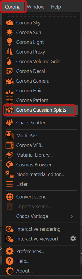

How to add Gaussian Splats to your scene
To create a Gaussian Splat object: Main Toolbar > Corona > Corona GaussianSplats button
You need a .ply file that contains Gaussian splat data. You can create these files with photogrammetry software or download them from online libraries.

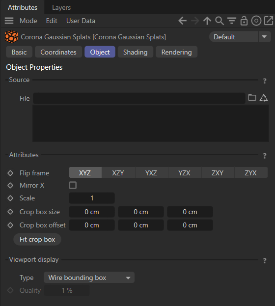

Loading your splat file
  • Click Select a file to load and choose your Gaussian .ply file
  • Click Reload from current file if you need to update the file after making changes
Note: Corona only works with Gaussian .ply files. Other file formats won't work.

The splat looks flipped or backwards
Use the Flip frame dropdown and pick a different axis order to correct the orientation.

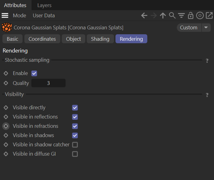

Rendering is too slow
Turn on Stochastic sampling and lower the quality setting.

Viewport display options
Corona gives you two ways to see splats in your viewport:
Wire box mode
Shows just a box outline. Use this when:
  • Your scene is heavy and slow
  • You're doing basic positioning
  • You want faster viewport performance
Point cloud mode
Shows the actual splat points. Use this when:
  • You need precise positioning
  • You want to see the splat details
  • You're checking if the file loaded correctly
The Points setting controls how many points appear in the viewport. Use lower numbers to keep your viewport fast.

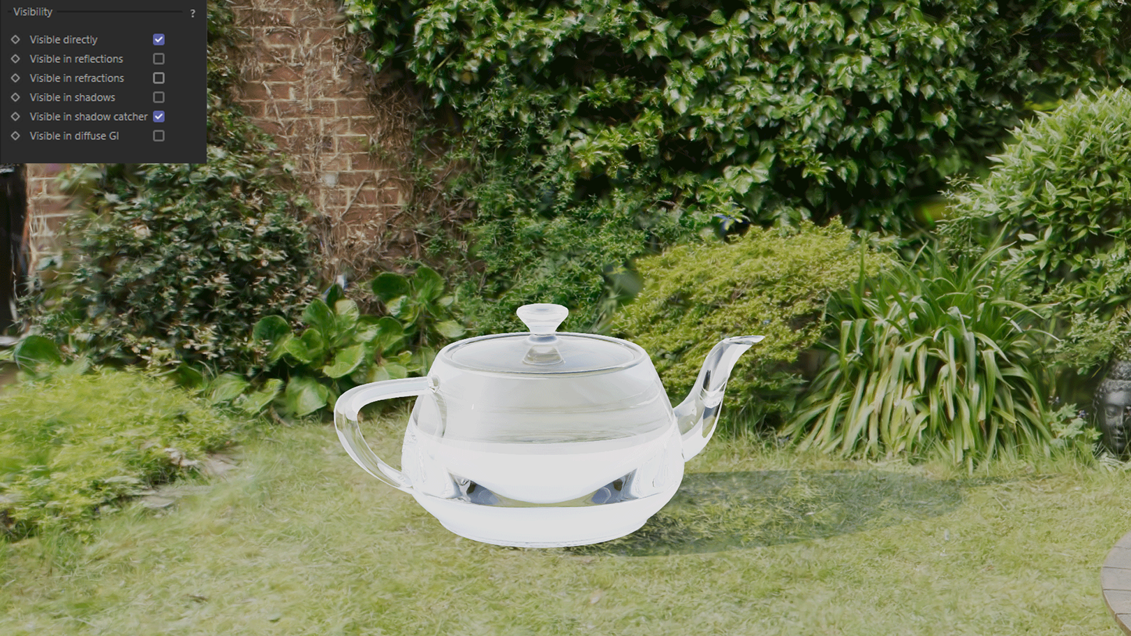

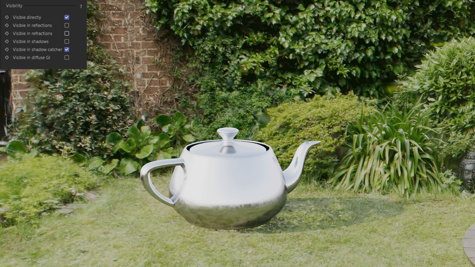

Visible Directly
Shows the Gaussian splat directly to the camera.
Visible in Shadow Catcher
Makes the splat visible behind objects using the Corona Shadow Catcher material.

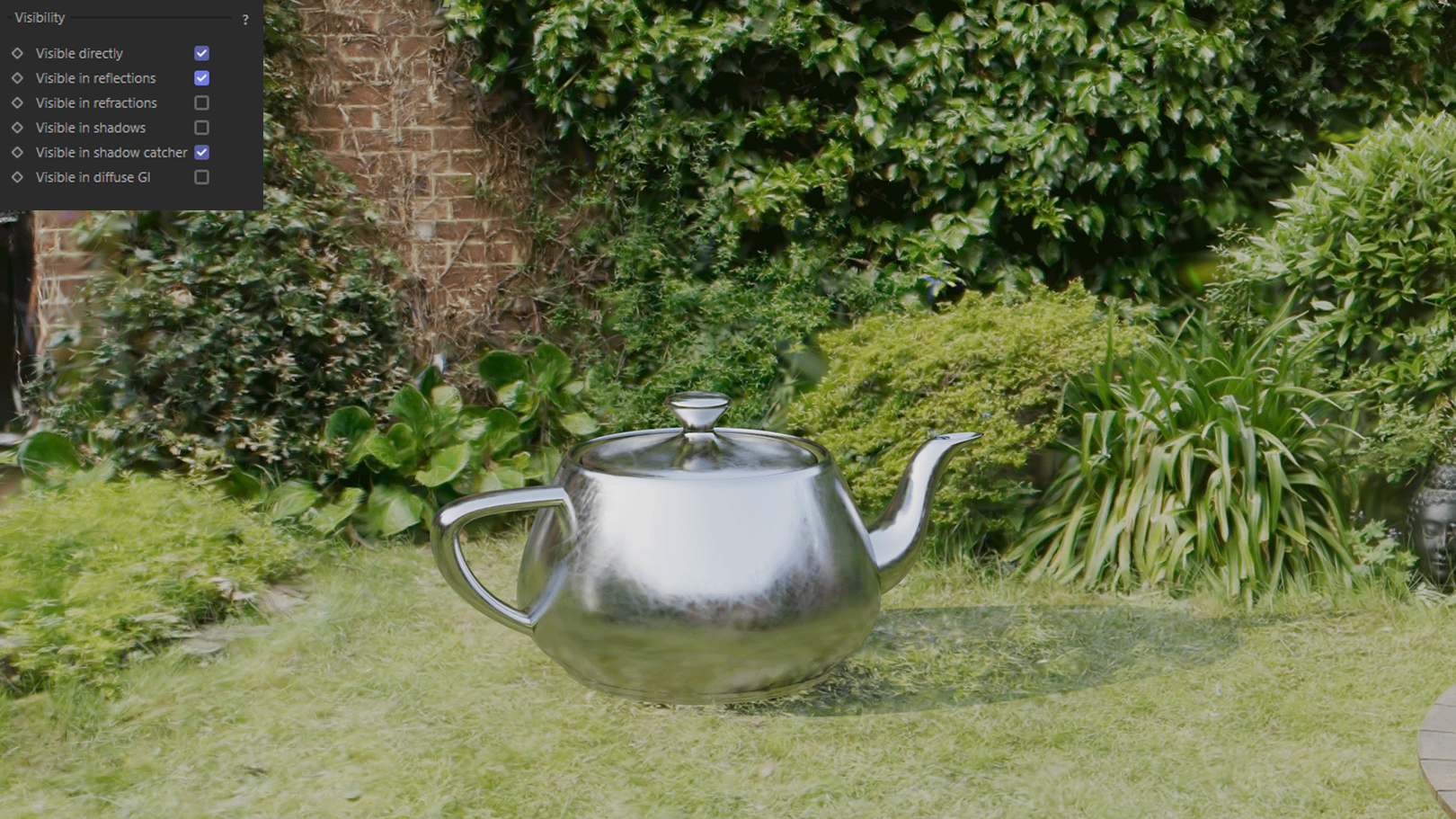

Visible in Reflections
Controls whether the splat appears in mirrors and reflective materials.

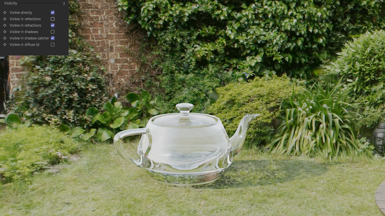

Visible in Refractions
Controls whether the splat can be seen through glass and other refractive materials.

  1. Turn on Visible in shadowcatcher so the splats show up behind shadowcatcher materials
  2. Turn off Visible in shadows to prevent unwanted shadows
  3. Adjust the Scale to match your scene size
  4. Use the Flip frame dropdown to reorder the X Y Z axes if the splat loads in the wrong direction.

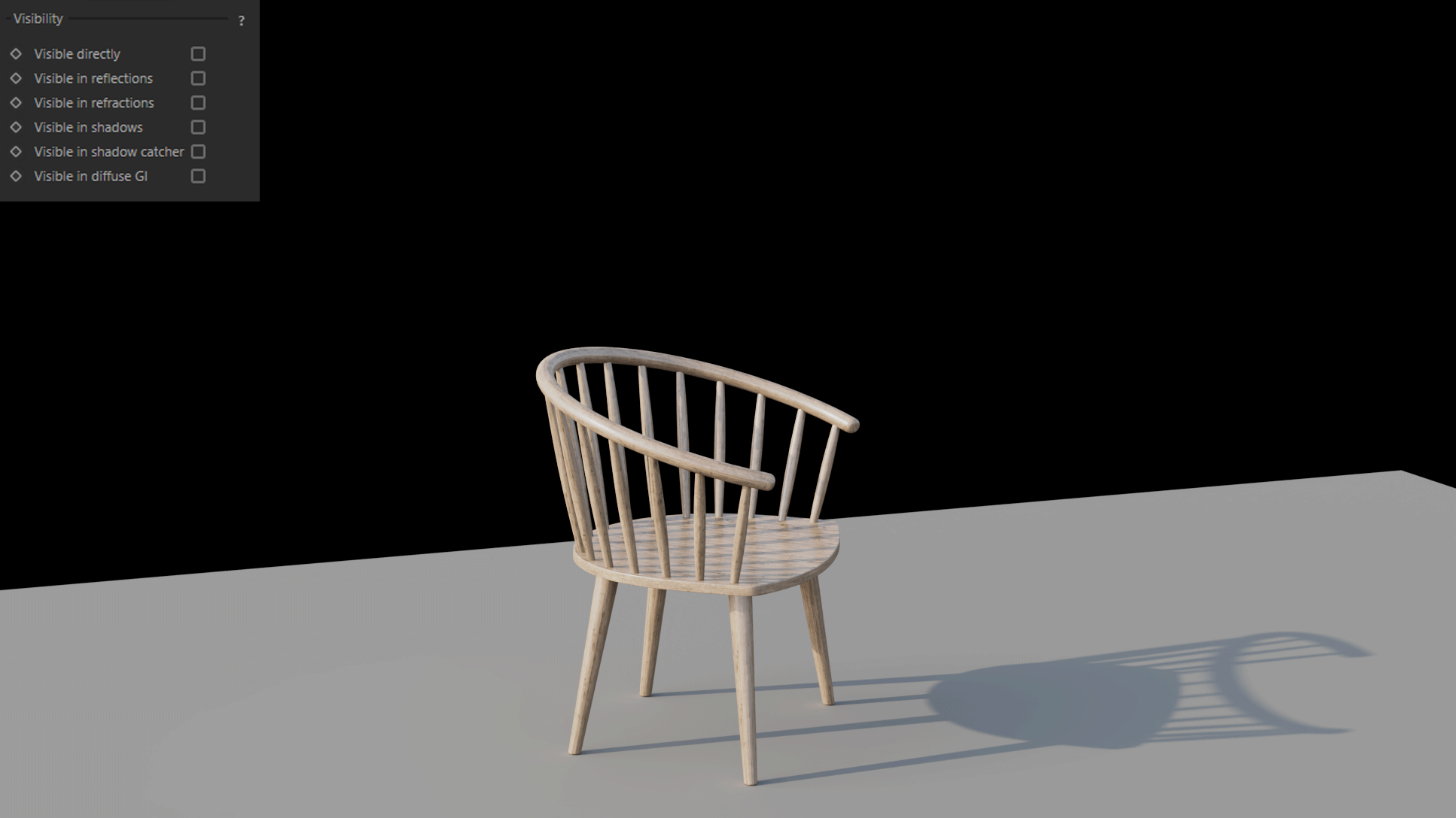

To use splats as regular objects in your scene:
  • Turn off Visible in shadowcatcher, unless you wish to capture the shadows of the Gaussian Splat object using the Shadowcatcher material
  • Turn on Visible in shadows so the splats can cast shadows on other objects
  • Adjust Color tint if you need to match your scene's color mood
Important: Gaussian splats have fixed lighting baked into them. They won't react to lights in your scene. Keep this in mind when planning your lighting.
Making your renders faster
The Stochastic sampling option controls speed vs quality:
Turn on stochastic sampling when:
  • You're doing test renders
  • You need quick previews
  • Some noise is acceptable
The Quality slider works like this:
  • Lower values = More noise but faster renders
  • Higher values = Less noise but slower renders
For final renders, you can turn off stochastic sampling completely. This removes all noise but takes much longer to render.

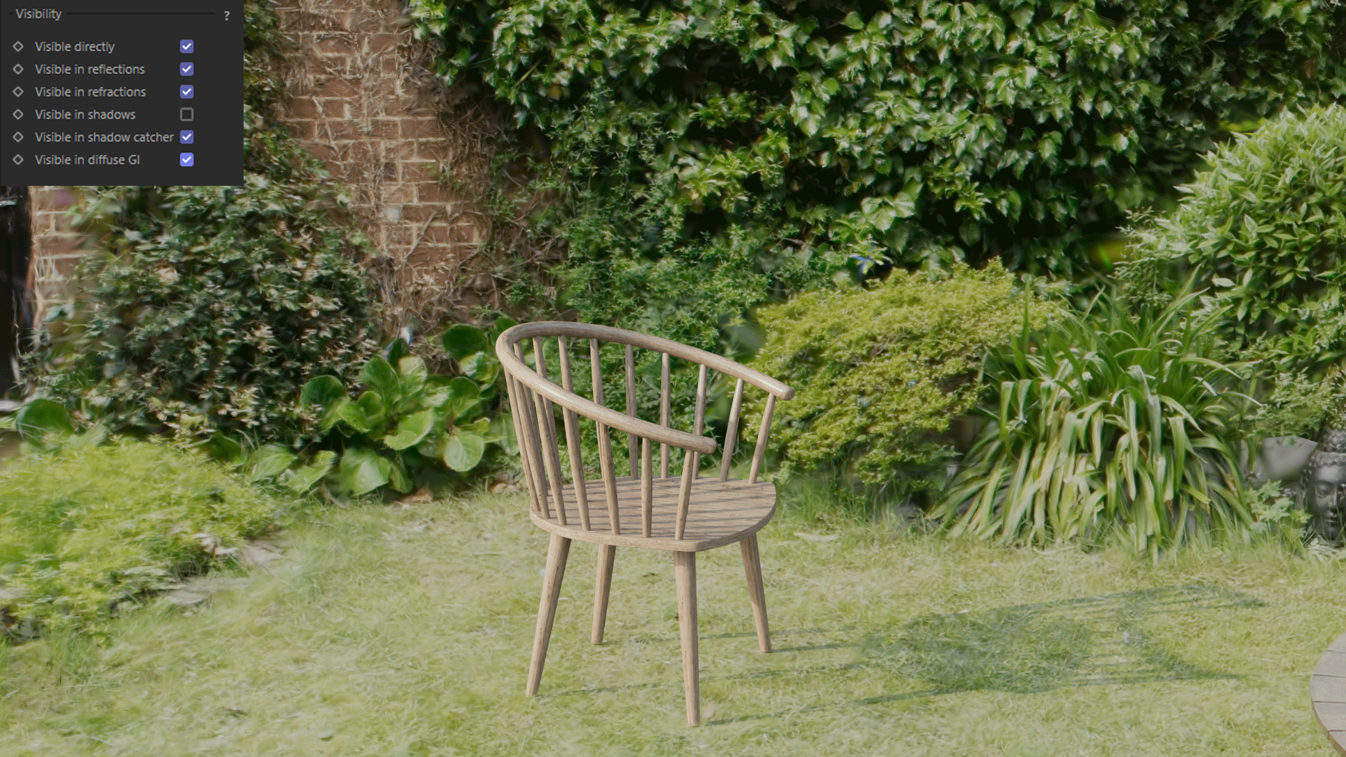

Visibility settings
Control where your splats appear with these options:
  • Visible Directly: Shows splats in the camera view
  • Visible in reflections: Shows splats in mirrors and shiny surfaces
  • Visible in refractions: Shows splats through glass and transparent objects
  • Visible in shadow catcher: Makes splats visible when behind objects with Shadowcatcher material
  • Visible in diffuse GI: Lets the splat cast indirect (bounced) light onto other objects in your scene.
