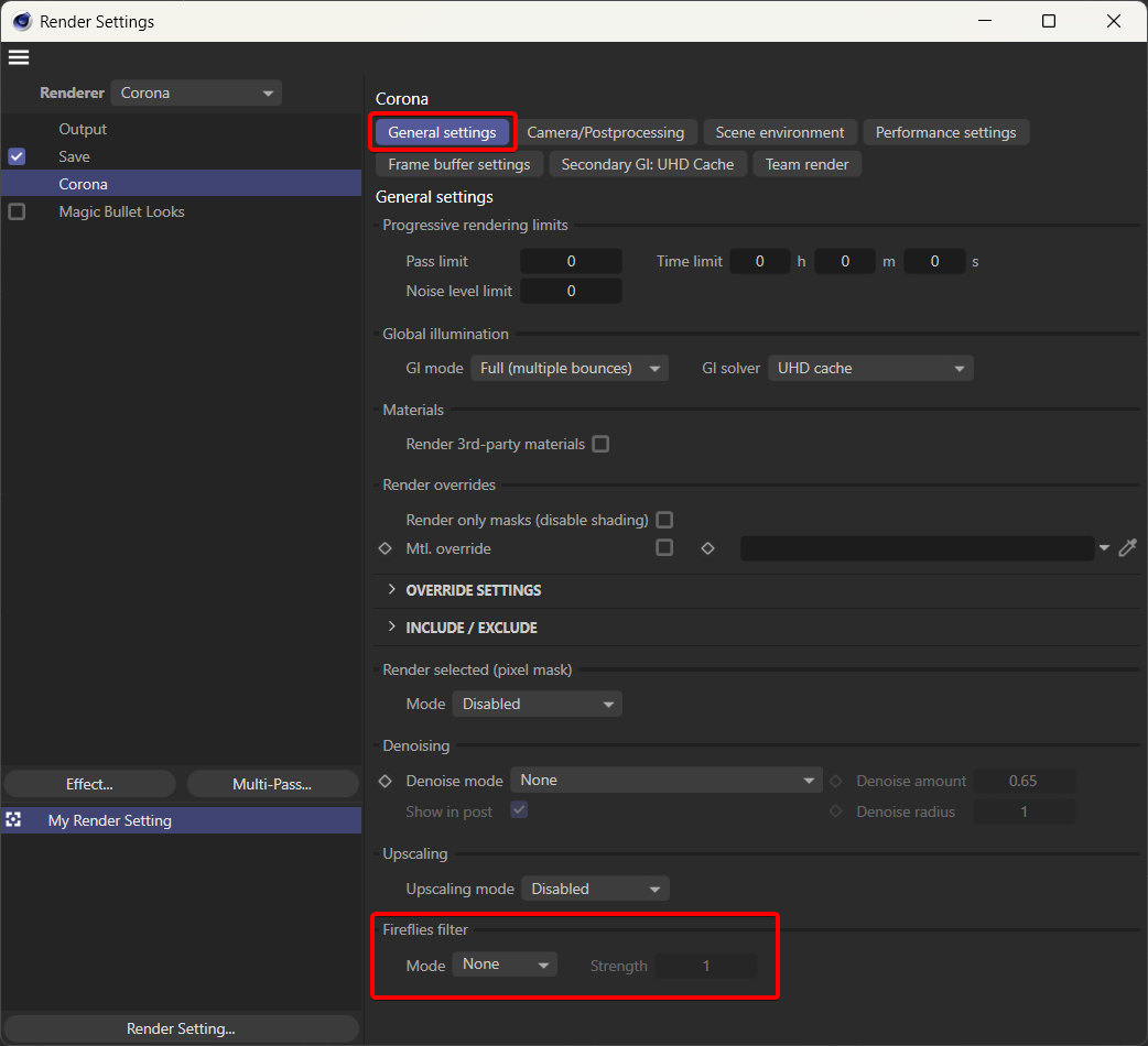

You can find the option under Render Settings > Corona > General settings > Fireflies filter:
Note: using high strength values can make the whole image appear darker.
