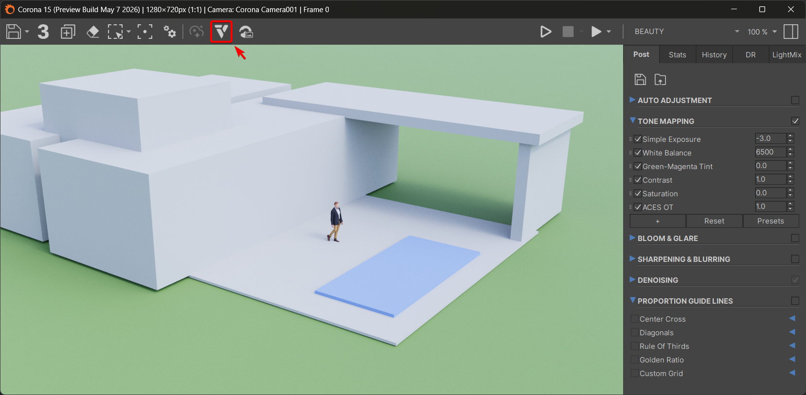

Where to find it?
You can find the Veras button in the top toolbar of the Corona VFB:
How to Use Veras with Corona
You don't need to wait for your final render to start playing with AI. Here is the typical workflow:
  1. Start a Render: You can trigger Veras during Interactive Rendering, while a production render is running, or after it has finished.
  2. Launch Veras: Click the Veras icon in the VFB. This will automatically capture the current VFB contents and open the Veras interface.
