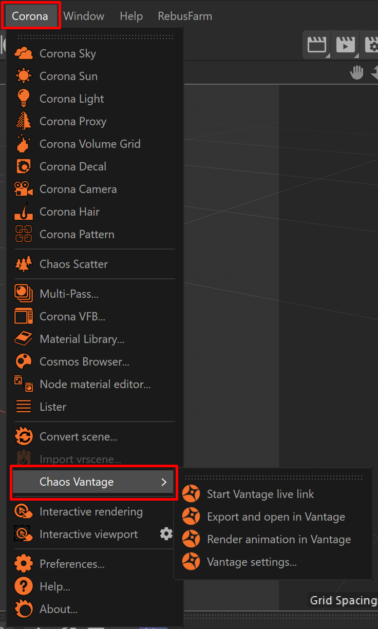

  2. (Optional) Go to the top menu: Corona > Chaos Vantage > Start Vantage Live Link to preview your animation in real time. You can skip this and jump straight to Step 3 if you're ready to render your animation.
    Note: This will launch Chaos Vantage and show your Cinema 4D scene live. If the timeline has animation, scrubbing it in C4D will show it in real-time in Vantage.

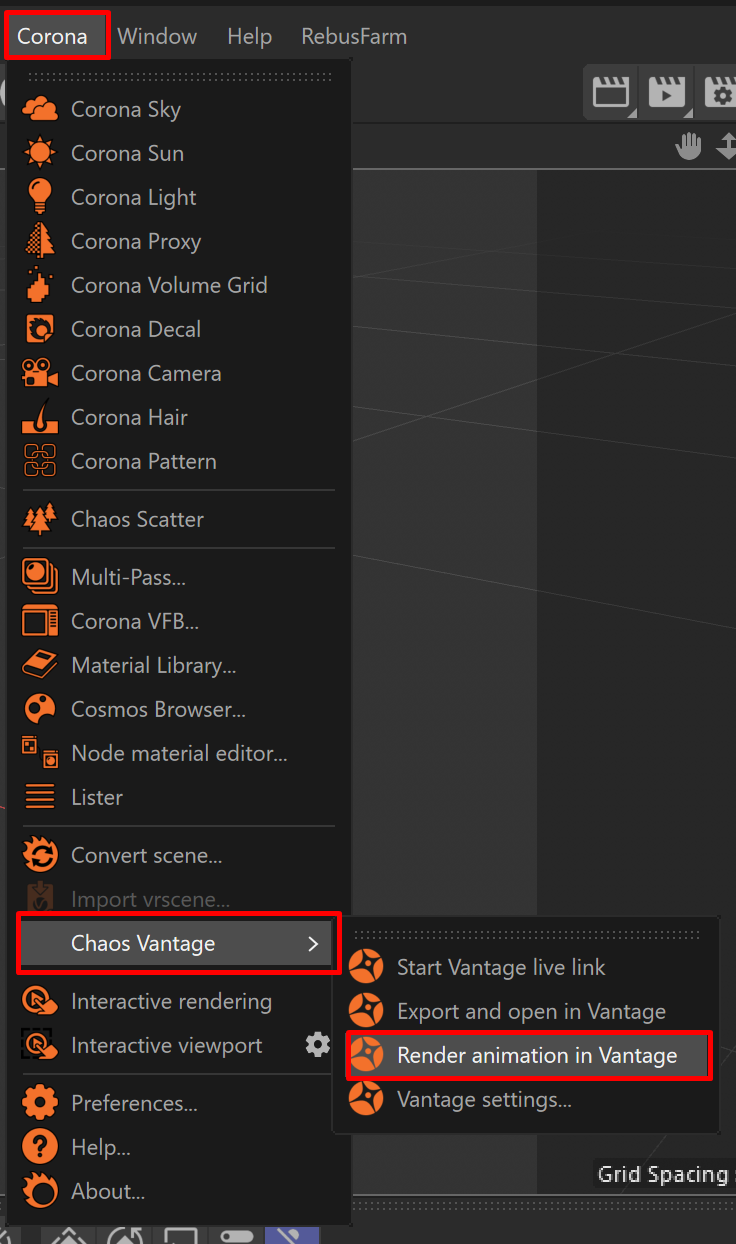

Step 3: Render Animation in Vantage
  • In the same menu, go to: Corona > Chaos Vantage > Render animation in Vantage

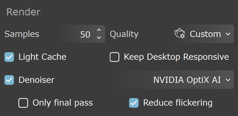

Step 4: Final Render Settings in Vantage

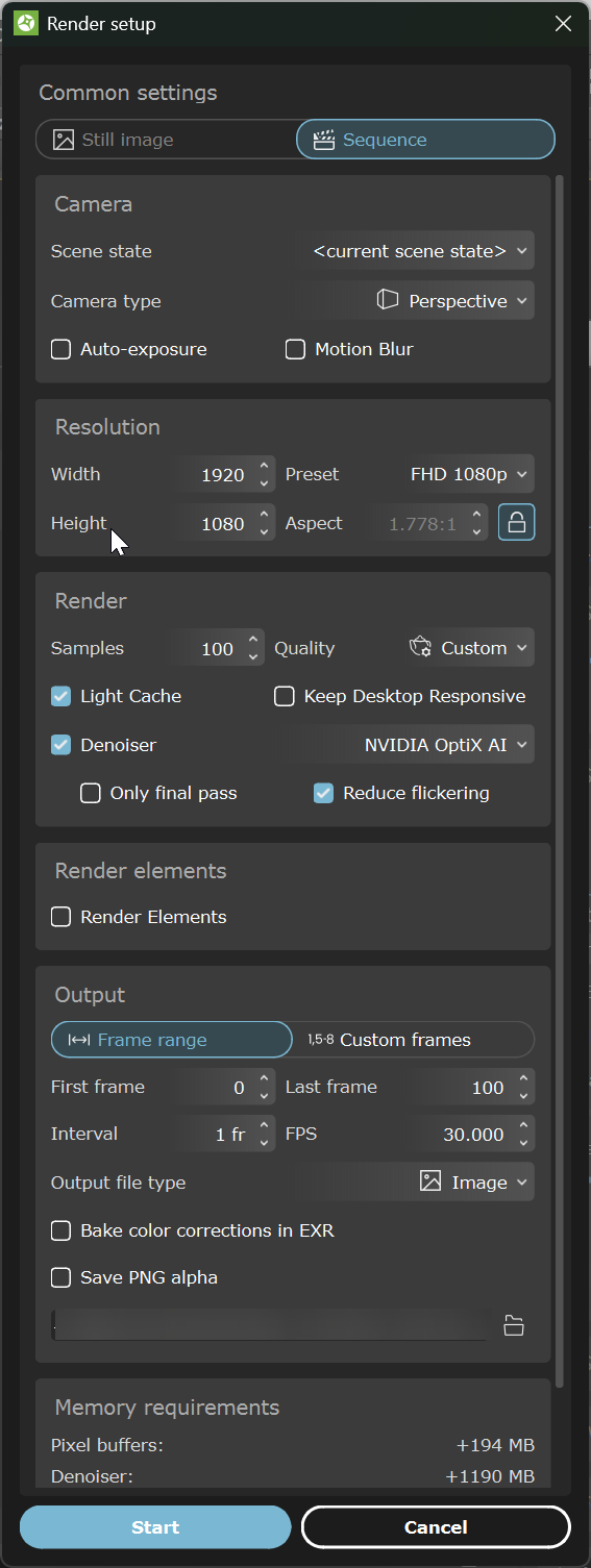

In the Vantage render window:

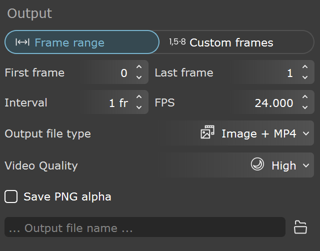

  1. Make sure “Sequence” is selected (not still image).

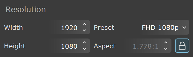

  2. Set:

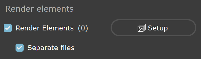

  3. Optional: Enable Render Elements and pick what you want.
  4. Hit the Start button to begin rendering the animation.
  5. That’s it! Vantage will now render your animation sequence.
