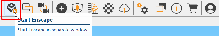

1. Open Your Scene in Enscape
Open your project using your preferred CAD/BIM software (like Revit, SketchUp, Rhino, etc.) and launch Enscape from the toolbar.

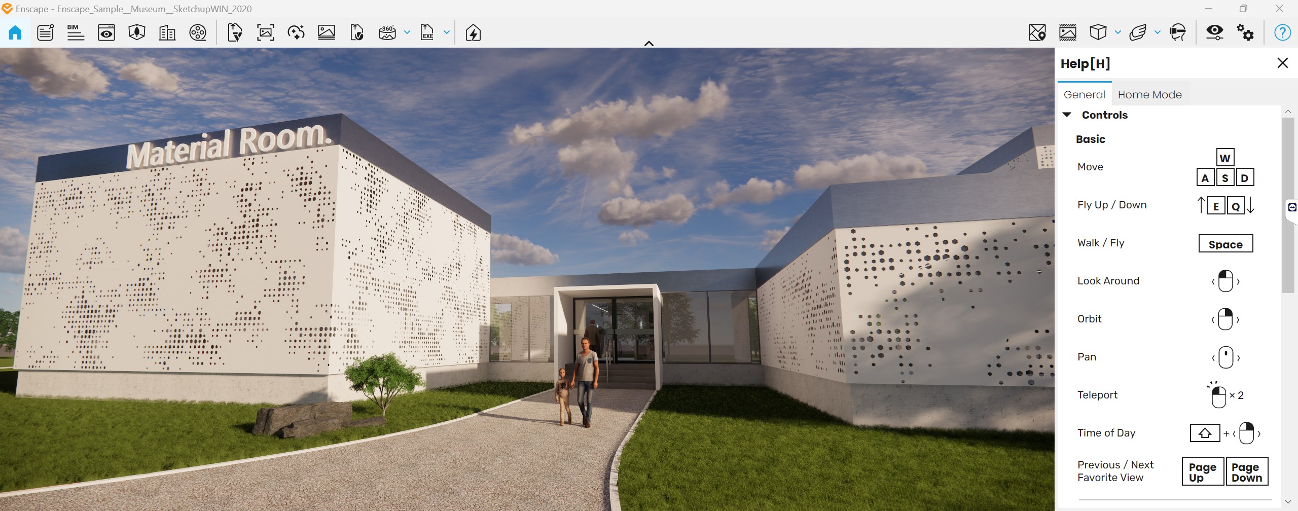

2. Set Up the Scene in Enscape
Tweak your materials, lighting, and camera views inside Enscape until you're happy with the setup.

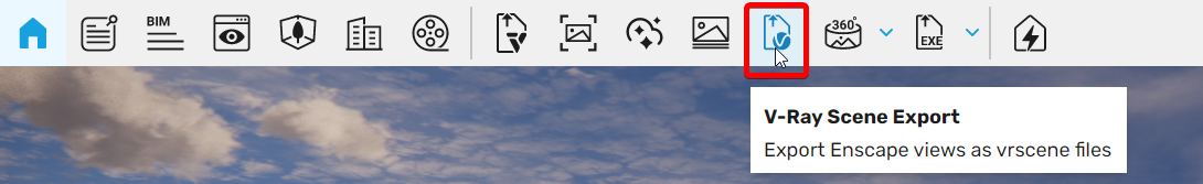

3. Export as V-Ray Scene
Click the “V-Ray Scene Export” button in the Enscape toolbar.

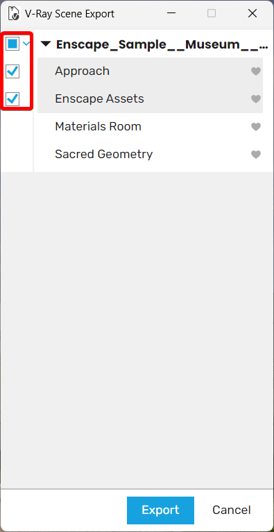

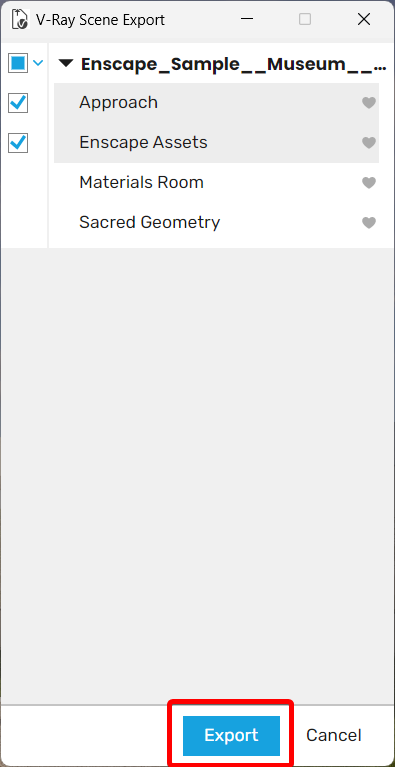

4. Select Views to Export
A window will pop up showing available camera views. Select the ones you want to export and click Export.

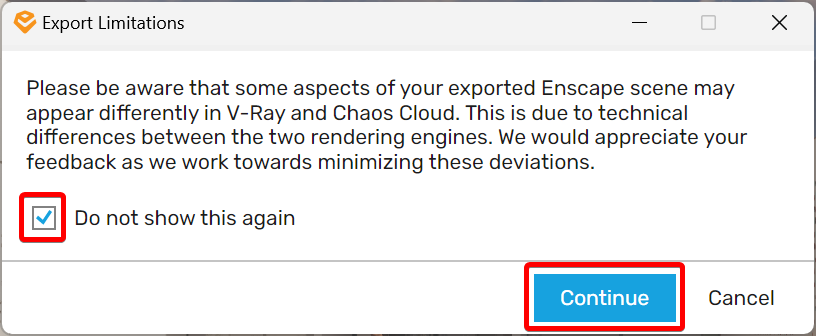

5. Confirm Warnings
A message might show up letting you know that render results in Corona may look slightly different due to engine differences. Click Continue.

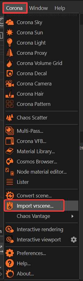

8. Open Cinema 4D and Access the Corona Menu
In Cinema 4D, click on the Corona menu in the main menu bar. From the dropdown menu, click on Import vrscene.

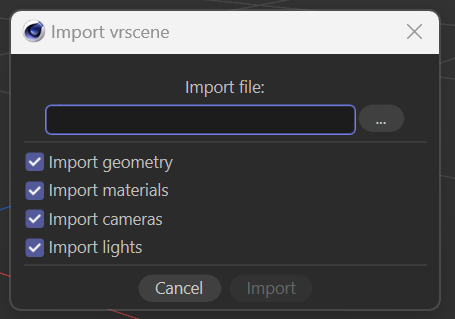

9. Browse for the .vrscene File
The Import vrscene window will appear. Click the Browse button next to "Import file" and navigate to the .vrscene file you exported from Enscape.

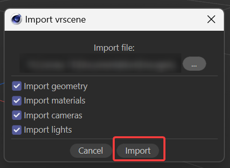

10. Click Import
Click the Import button at the bottom of the dialog to start the import process.

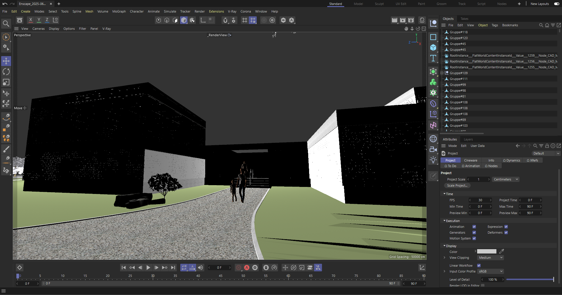

Final Result
Once it finishes, you’ll see your full Enscape scene inside C4D, ready to be rendered with Chaos Corona!
