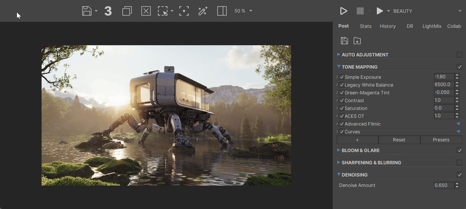

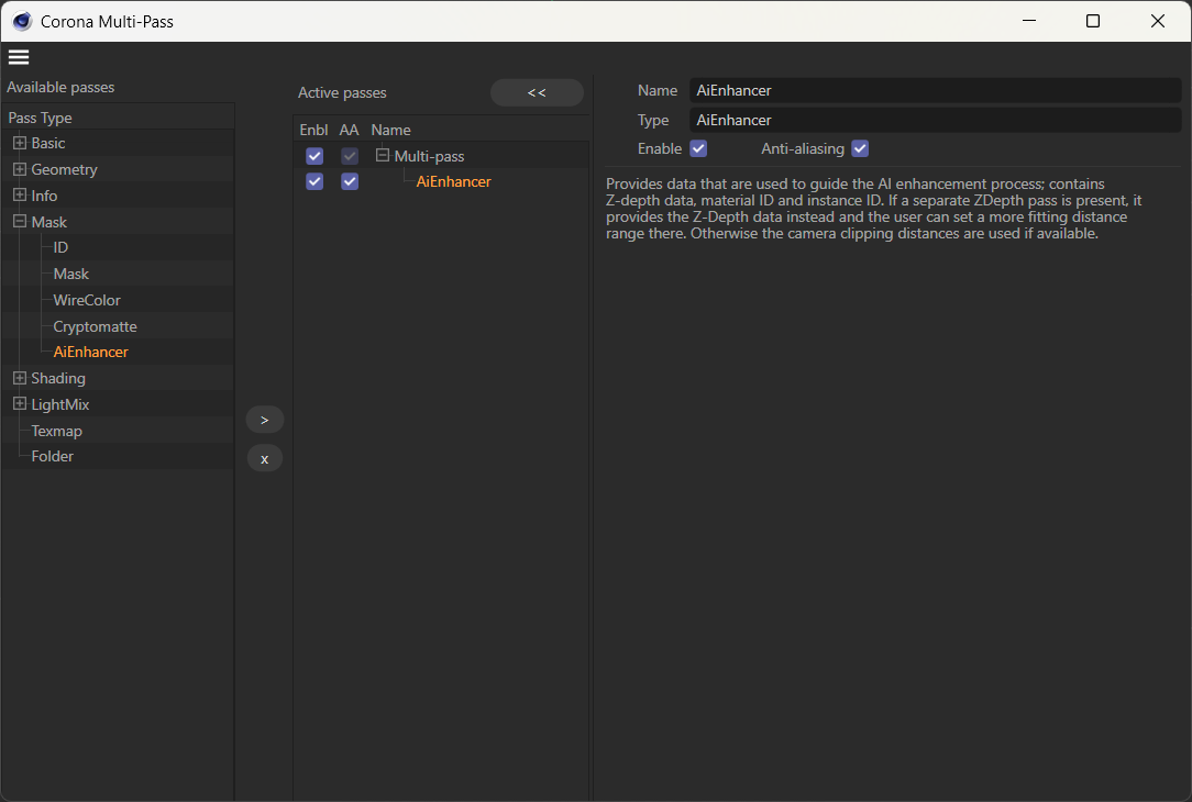

Step 1: Add the AiEnhancer Render Pass
To enable the AI Enhancer functionality, you need to make sure the AiEnhancer render pass is added to your scene. This is a crucial step, as the render pass provides data that are used to guide AI enhancement process. It contains Z-Depth data, material ID, and Instance ID.
Note: If the ZDepth pass is present, it provides the Z-Depth data instead. The user can set a more fitting distance range there. Otherwise, the camera clipping distances are used if available.
Step 2: Upload the Image with AI Enhancer Data
Once your image is rendered with the AiEnhancer pass included, the next step is to upload the image to Chaos Cloud Collaboration. Complete the upload as shown below:

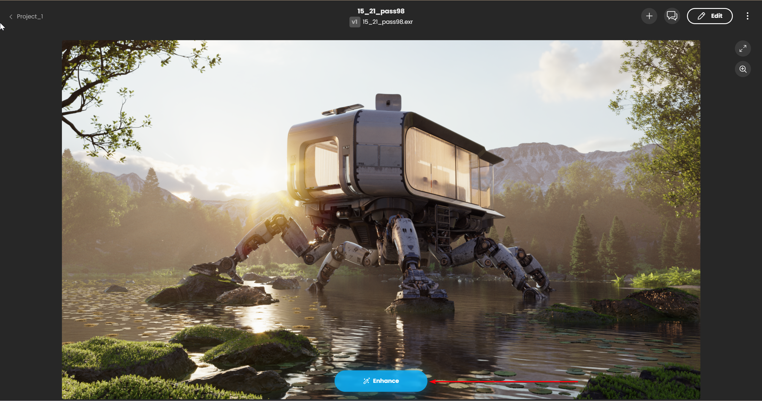

Step 3: Enhance the Image in Cloud Collaboration
After uploading your rendered image to Chaos Cloud Collaboration, you can easily apply the AI Enhancer to improve its visual quality.
To do this:
  1. Navigate to the project where you uploaded the image.
  2. Open the image you want to enhance.
  3. Click the "Enhance" button.

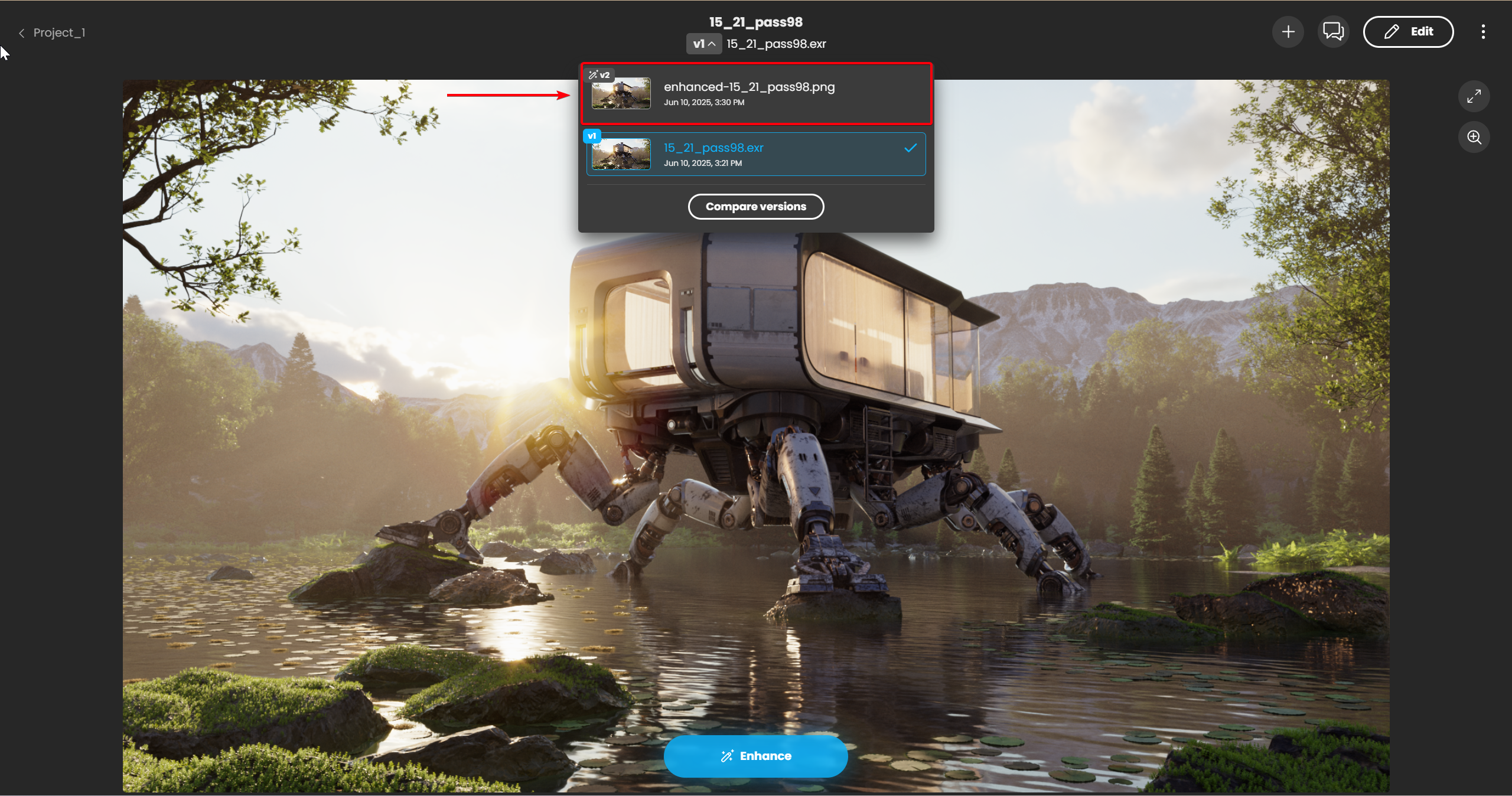

Step 4: Wait for the Enhancement to Complete
Once you click Enhance, the AI processing may take some time depending on the image resolution and data complexity. When the process is complete, the enhanced version of your image will be automatically saved in Chaos Cloud Collaboration. This new version will appear alongside your original image, making it easy to download the improved result.

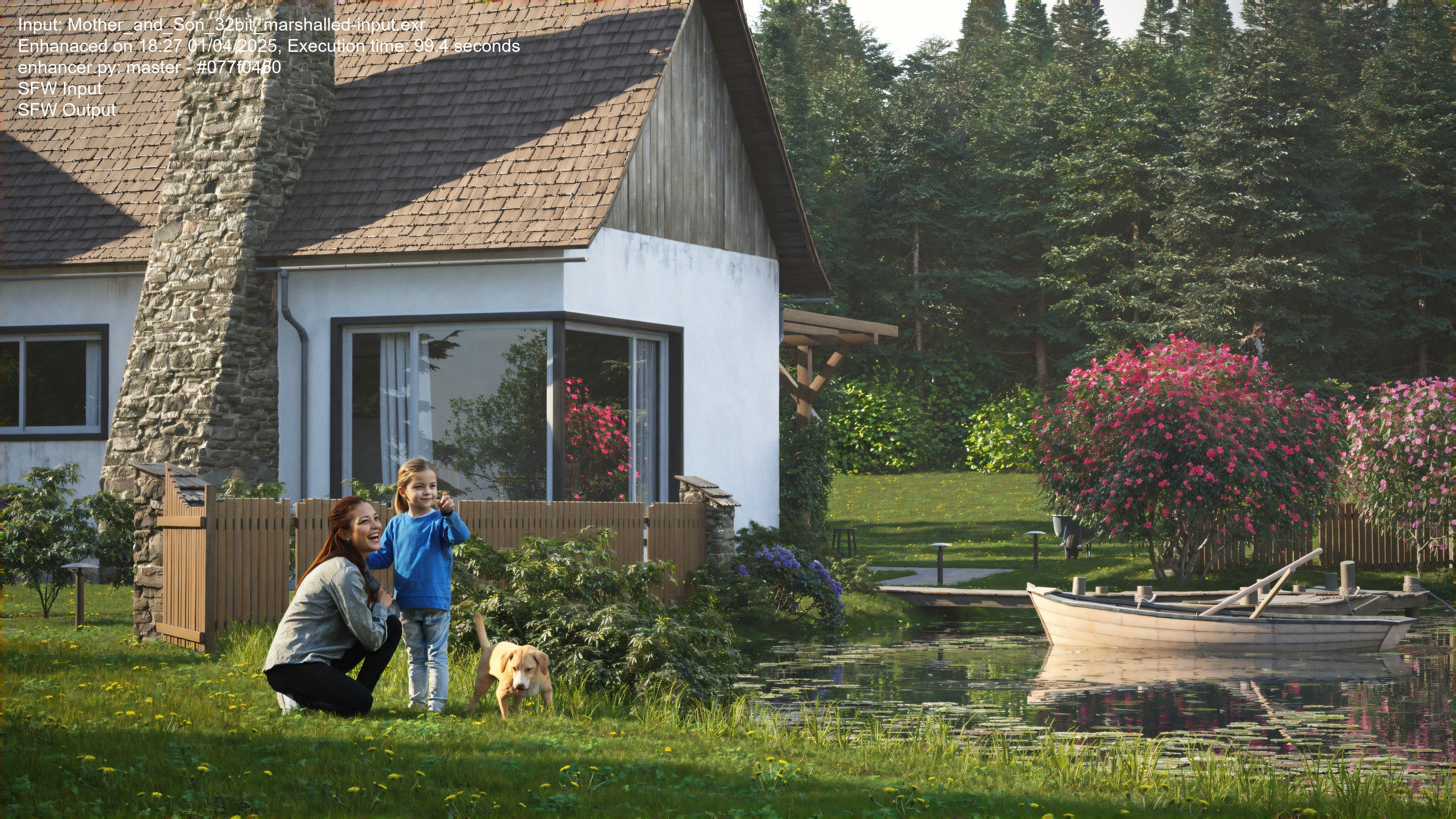

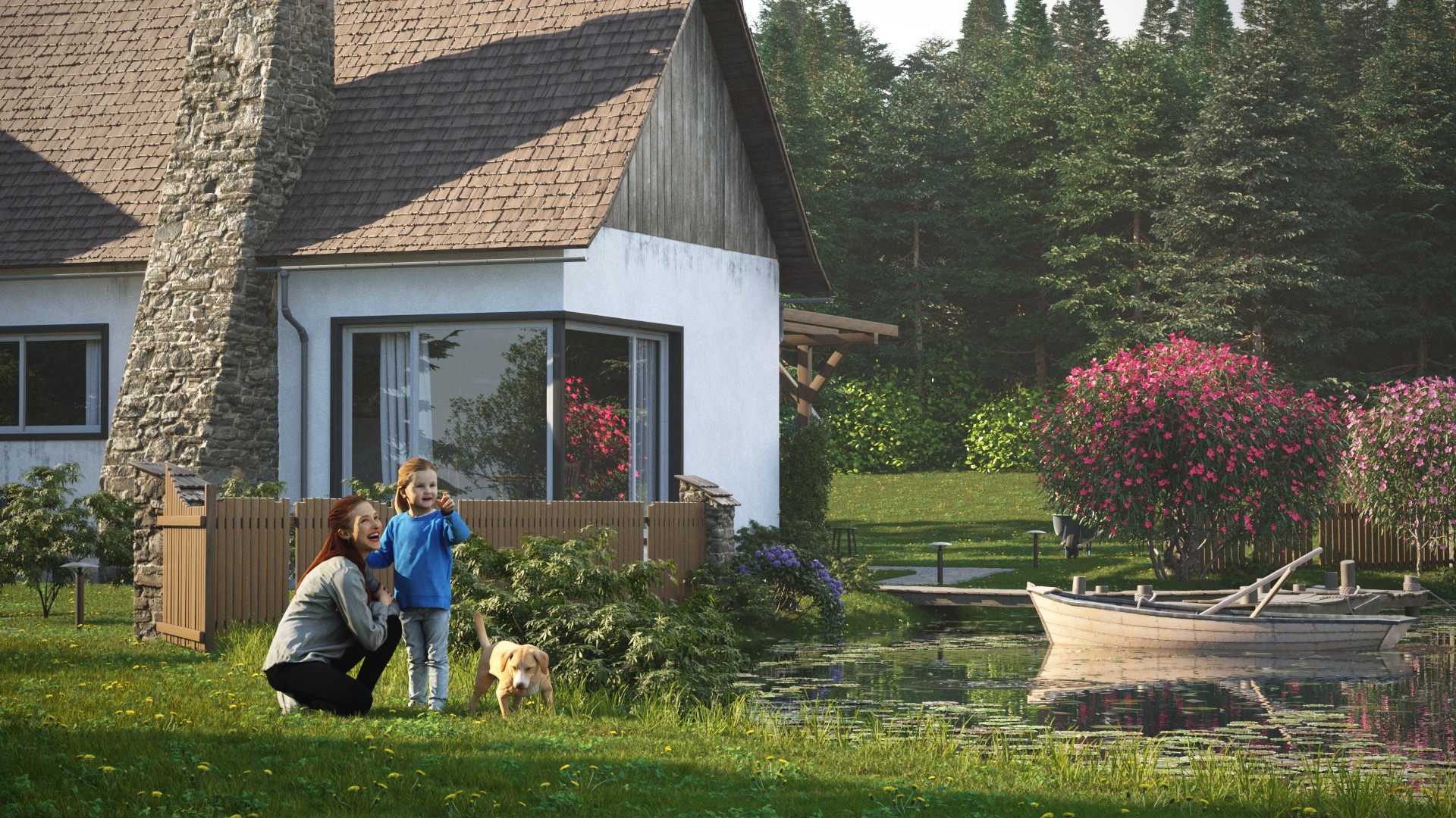

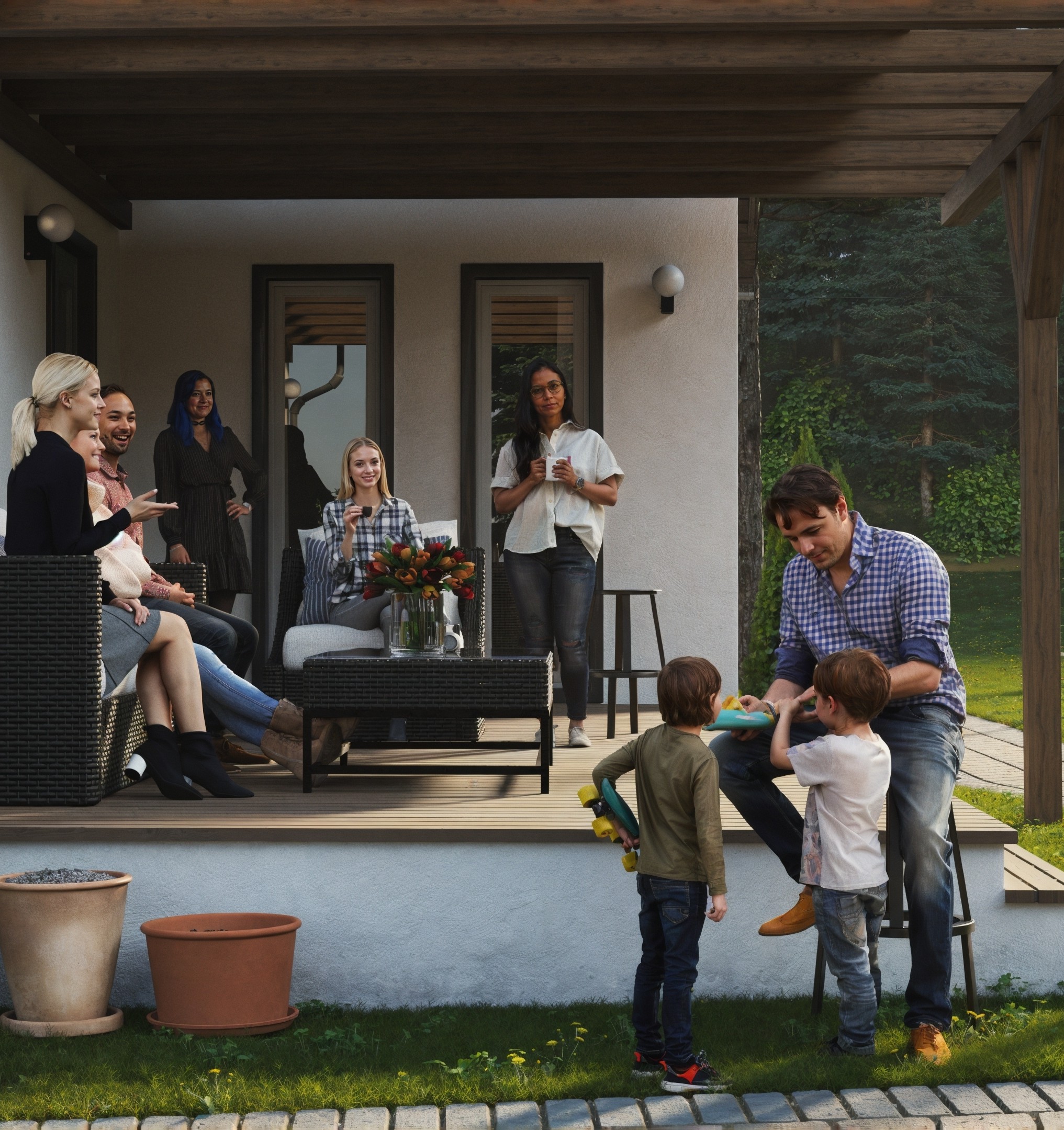

These before-and-after examples demonstrate how the AI Enhancer elevates the realism, clarity, and visual impact of 3D people used in scenes — making them more lifelike, better integrated, and visually polished.
Before (click to enlarge)
After (click to enlarge)
