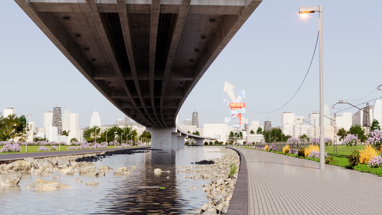

  1. Go to the Corona menu and pick Corona Full Sky. This adds a Corona Sky, Corona Sun, and Corona Moon, however the default is a daylight configuration.

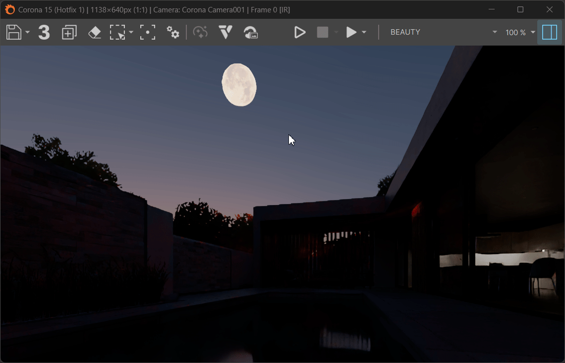

  3. Select the Corona Moon and disable the "Set position from sky" option in its attributes. Then adjust the Moon's azimuth and elevation so that the camera can see it. Interactive rendering is very useful for adjusting the Moon's position.
    Tip: to specify the exact position of the the moon in the sky during interactive rendering, with the "Pick" button active, right click in the sky and select "Place moon here":

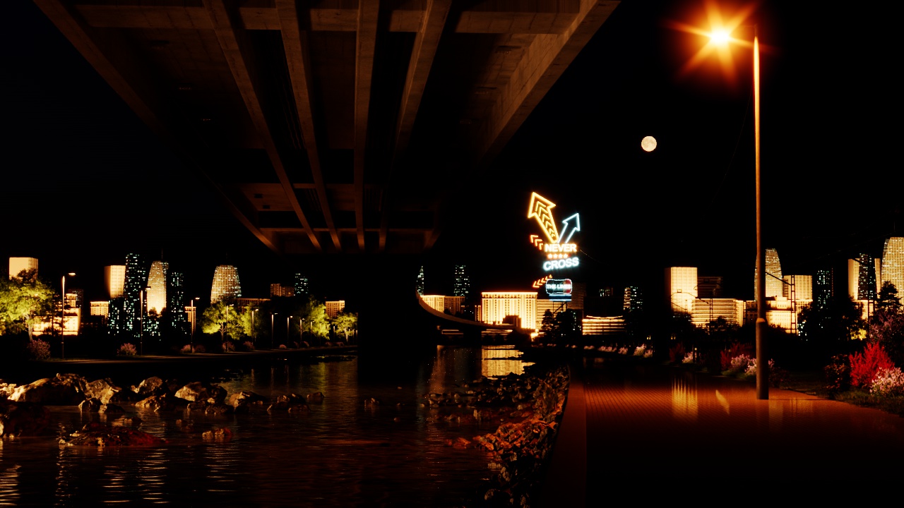

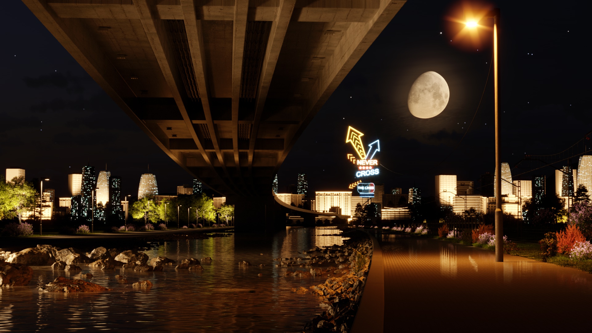

  4. In the Corona Sky attributes, enable stars. Optionally, you can also enable clouds.
  5. Adjust the settings of the Corona Sky and the Corona Moon to your taste. For example, you can increase the size of the moon or decrease its disk brightness.
Note: Balancing scene lights, the moon, and the stars so they’re all visible without overexposed or underexposed areas can be challenging. However, it’s possible using the available non-physical settings.
Start by setting the overall exposure so your scene lights look correct. Then adjust the star intensity until the stars are clearly visible. Finally, fine-tune the moon disk intensity.
