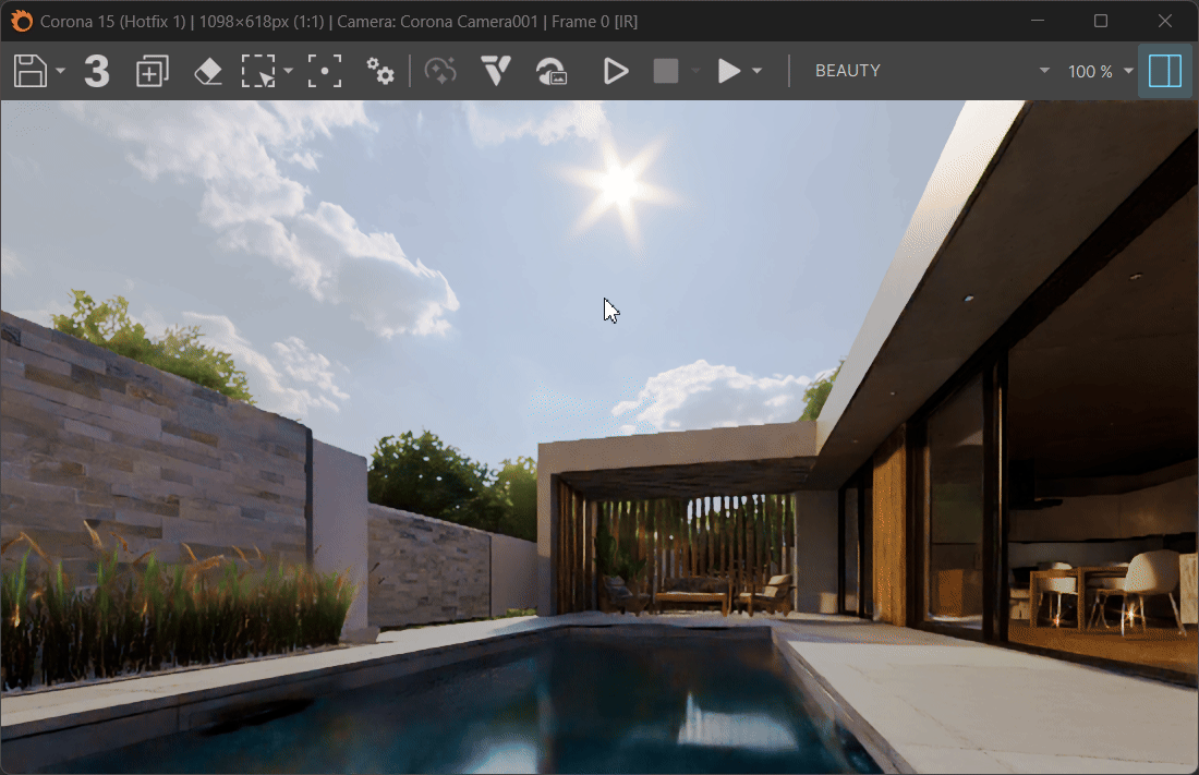

How do I align Corona Sun with my HDR background in Corona for 3ds Max?
The easiest way to align Corona Sun with the sun embedded in the HDRI environment is using the "Pick" mode of the Corona VFB. To specify the exact position of the sun in the sky, with the "Pick" button active, right click in the sky and select "Place sun/moon here". This way, you can place your Corona Sun exactly over the HDRI sun:
