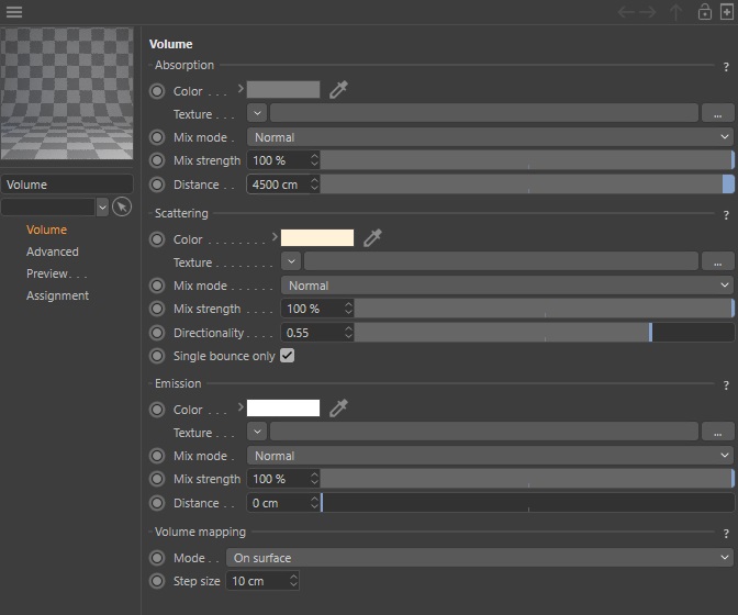

Image 1, Baseline
This will be used as our baseline, and then one parameter at a time will be adjusted from these settings to show the effect. The most important value to set for the initial setup is the Absorption Distance. The exact value you need to use for this will depend on the size and scale of your scene.
Image 2, Absorption Distance
Lowering the absorption distance makes the volumetric effect absorb light more quickly (that is, more light is absorbed even when a light ray travels a lower distance through the volume), resulting in a darker environment.

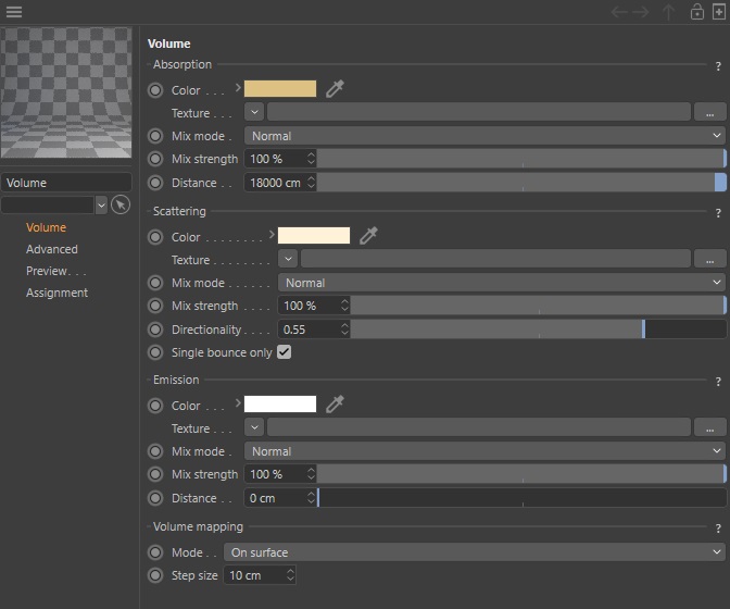

Image 3, Absorption Color
Using a brighter color for the absorption color means the volumetric effect absorbs less light, resulting in a brighter environment. A slight orange tint was also added to the absorption color.

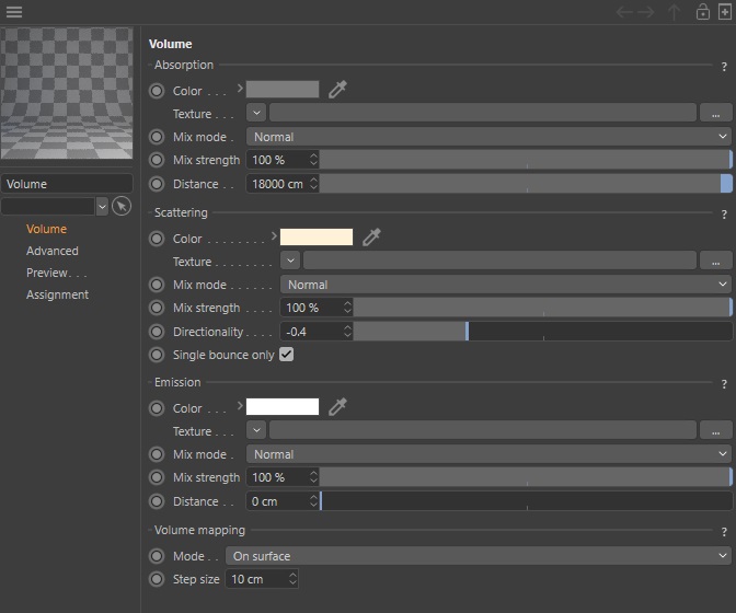

Image 4, Scattering Directionality
Lowering the directionality of the scattering means light is scattered less along the direction of travel for the light, and more back toward the light. This gives a softer, less well defined look to the scattering.

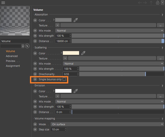

Image 5, Disabling Single Bounce Only
Turning off "Single bounce only" allows light rays to be scattered (and absorbed) more than once. Depending on your scene, this can increase realism, and the trade-off is that it will give longer render times. In many cases the effect may not be particularly noticeable and "Single bounce only" can be used without any perceived loss of realism.
