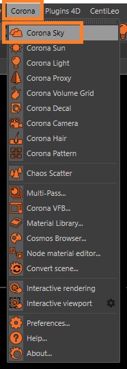

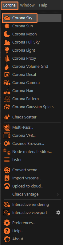

  • Add a Corona Sky object to your scene (Corona > Corona Sky):

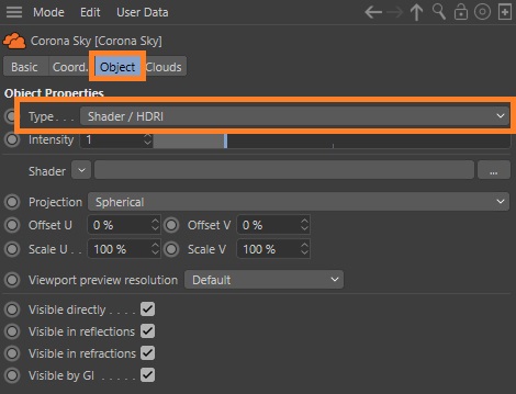

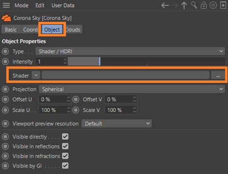

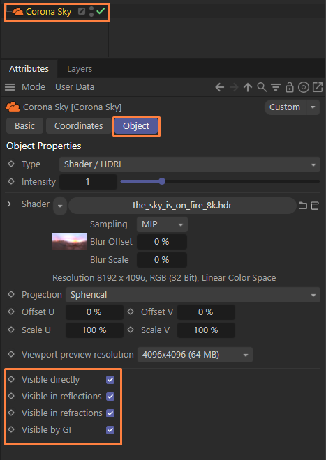

  • Select the Sky object and change the "Type" to Shader/HDRI:

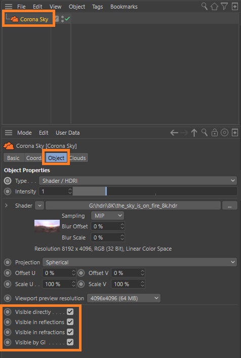

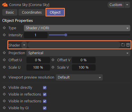

  • Load the HDRI of your choice into the shader slot of the Corona Sky object:

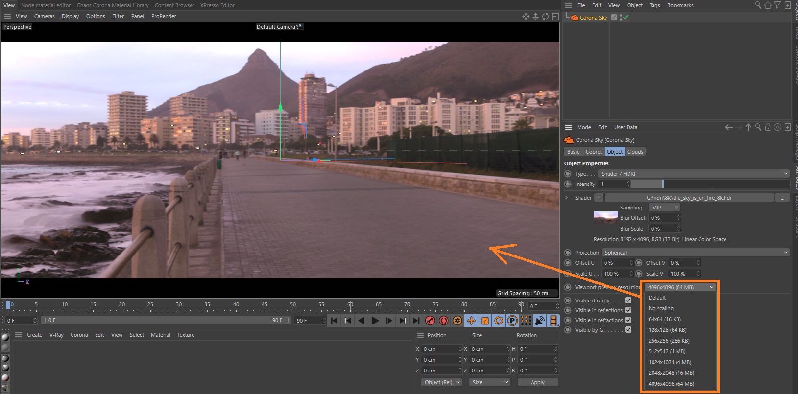

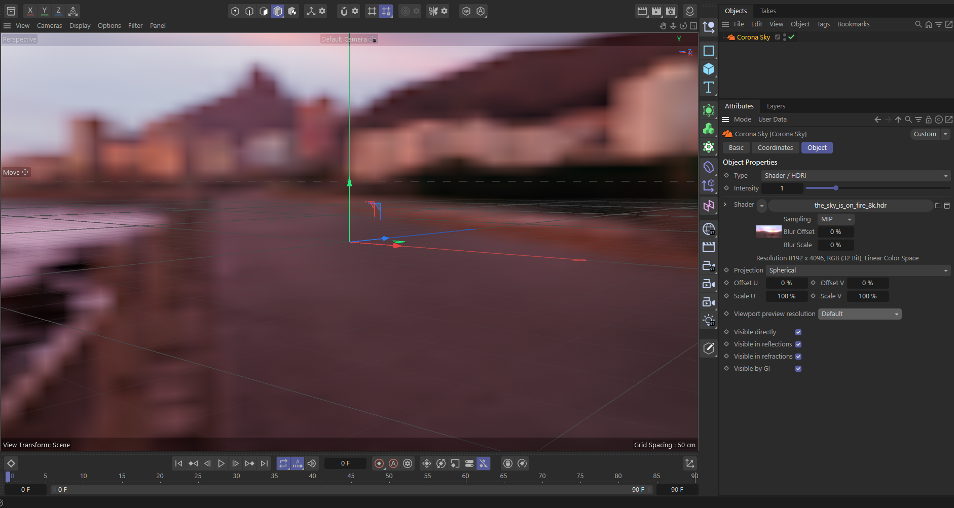

  • A low-resolution preview should be visible in the viewport display:

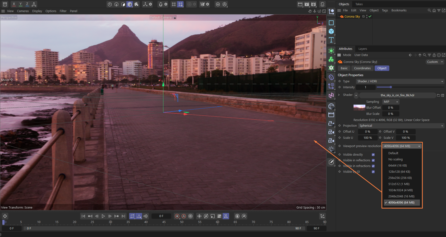

  • The viewport resolution can be increased from "Default" to a higher resolution you're happy working with:

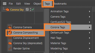

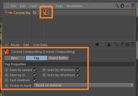

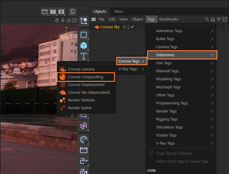

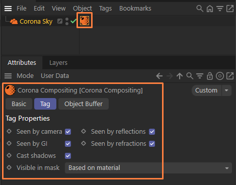

  • To make the environment visible only to specific ray types (direct visibility, GI, reflections, refraction), you can add Corona Compositing tag to the Corona Sky object (Tags > Extensions > Corona Tags > Corona Compositing):
  • Alternatively, visibility options can also be found within the Corona Sky object itself:

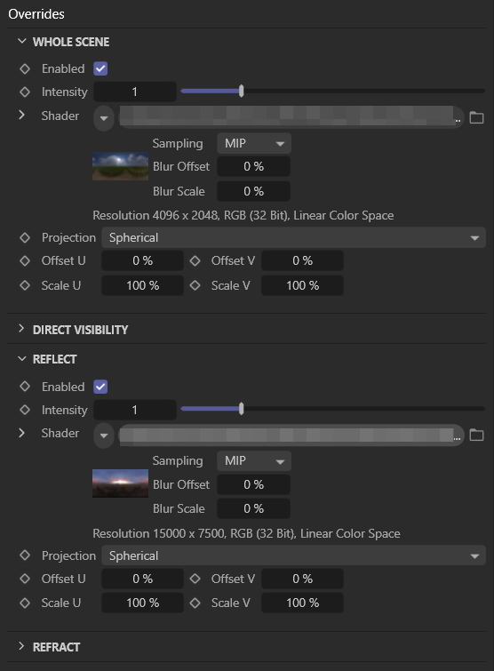

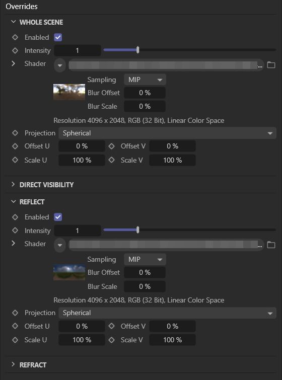

Per-Camera Environment Overrides
You can override the environment map(s) per-camera:
The above examples come from a single scene. Left - a camera using a forest HDRI as the scene environment with a reflection override enabled so that there are no tree reflections in the water. Right - another camera using a daylight HDRI as the scene environment and an evening HDRI as the reflection override.
