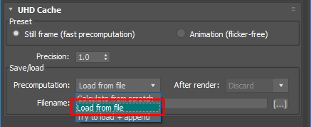

2. Load from file - this will load a previously saved cache file specified in the "Filename" field. No precomputation will be done. If the file is not found - a new one will be computed from scratch, and a notification will appear.
Note: when rendering a sequence, the single cache file will be loaded and used for the whole sequence. The cache file may contain information about only a single frame (if Calculate from scratch + Save to file combination was used) or it may contain information about multiple frames (if Try to load + append option is used).

- Set Precomputation to "Calculate from scratch" and After render to "Save to file"
- Specify the path to save your cache file
- Set your rendering to 1 second only (see: How to set limit for rendering?)
- Set your rendering to render only 1 frame (not a sequence)
- Render - this will render your image for only 1 second so almost no actual rendering will be done, but the cache file will be calculated and saved
- Set Precomputation to "Load from file"

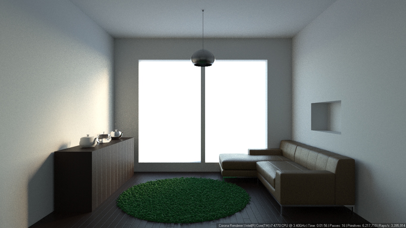

1. Image rendered with Path Tracing as primary and UHD Cache as secondary solver.
16 passes
Render time: 01:56 - notice the image quality in comparison to other examples, especially in the areas where GI is dominant
