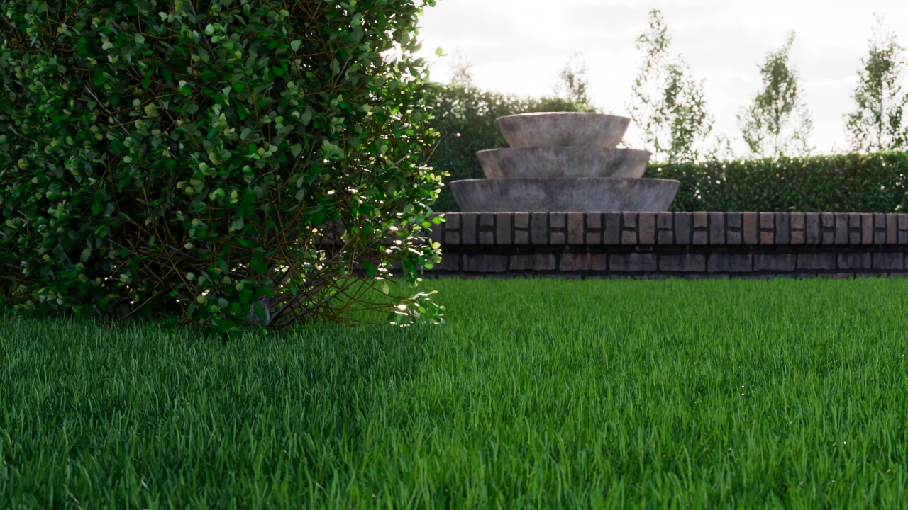

Example grass material:
1 - "Thin shell (no inside)" option enabled. You can control translucency only when this option is enabled.
2 - Roughness set to a reasonable value. The reflections aren't very blurry, but also not mirror-sharp.
3 - Translucency Fraction set to 0.3. Too low values make the translucency effect too weak and too high values can make the material appear too bright.
The result of using the above material for the grass:
Thanks to translucency, the sunlight hitting grass blades from the back passes through them, just like in real life.
For comparison, here is the same scene rendered with translucency disabled in the grass material:
With translucency disabled, the sunlight is almost invisible making the image unrealistic.
