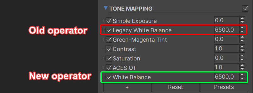

Note: Starting from Corona 12 Update 1, the White Balance operator has been deprecated and now called "Legacy White Balance." The new White Balance operator uses Bradford's chromatic adaptation formula, which makes it more accurate and in-line with industry standard.

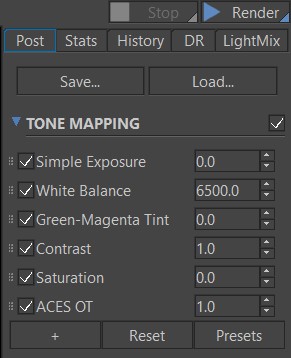

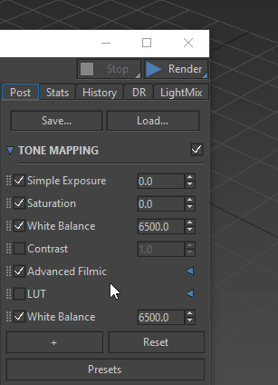

The Tone Mapping available in Corona 8 and newer comes with stackable operators which are applied from top to bottom.
Some operators, like Reinhard Highlight compression (Highlight compression), Filmic mapping (Filmic highlights, Filmic shadows) were previously supported, and new operators are introduced as well.
Default Tone Mapping operators

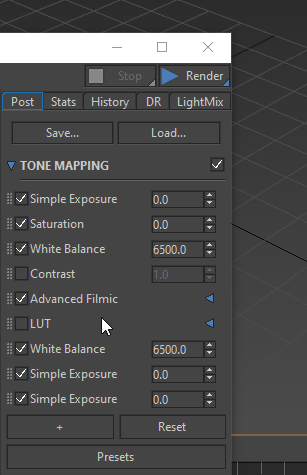

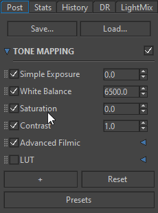

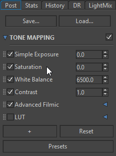

The operators can be moved higher or lower by dragging and placing them. The blue line indicates where an operator will be placed:
The operators can be switched on and off:
New operators can be added by clicking on +. You can add the same operator multiple times:
Operators can be removed by right-clicking on them and selecting "Delete":
Ready-made presets can be picked from "Presets".
Note that this will remove the previous setup. Currently no undo/redo is available for Tone Mapping:

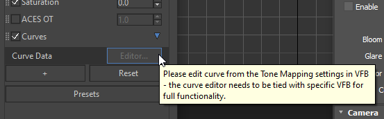

Note: Curves operator's editor is only available within the Corona VFB. It is greyed out in Camera Tone Mapping override and for Global Tone Mapping, as this operator needs frame buffer input to work. See also the tooltip:

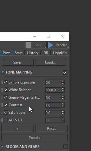

ACES OT operator
One of the new operators - ACES OT (Output transform) - is in the tone mapping stack and enabled by default.
Examples of ACES OT on/off :
ACES OT enabled
ACES OT disabled
The full-size comparison here.
Note that highlights and color information in them is better mapped with ACES OT enabled and the overall image balance is better.
You may also need to adjust the exposure and tones after enabling ACES OT to compensate for them in some cases.
