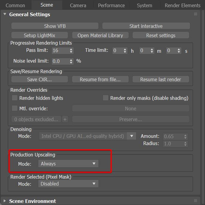

To use Production Upscaling in Corona for 3ds Max, go to Render Setup > Scene Tab > Production Upscaling
Note: enabling Upscaling automatically enables NVIDIA AI Denoising.

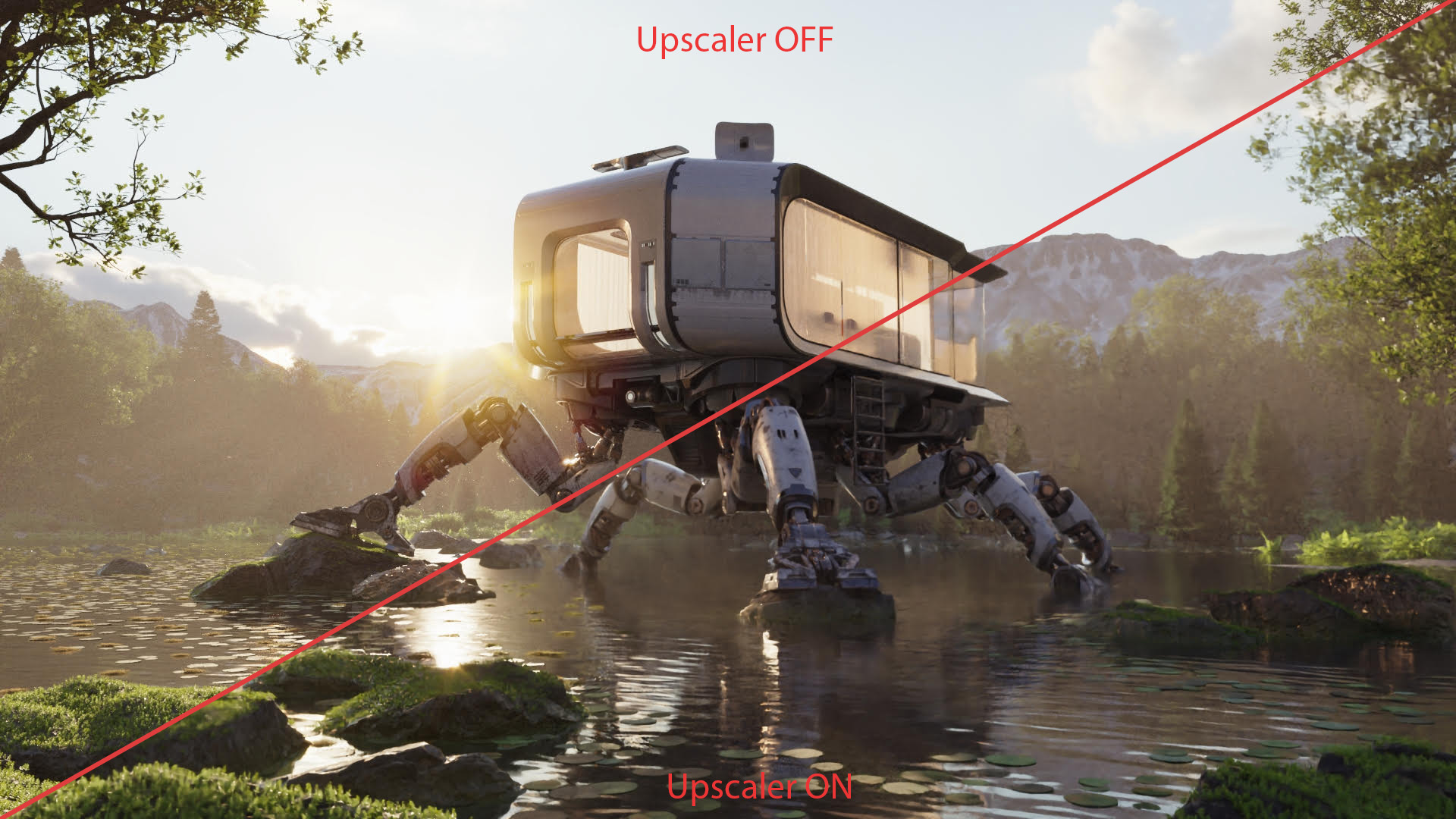

Click to enlarge or check the image comparer.
When Upscaling is enabled, the overall image quality remains high, and details remain clearly visible. However, some details, such as the grass in the bottom-left corner and the tree in the upper-right corner appear slightly less sharp compared to the render without upscaling.
Despite this minor loss in sharpness, the rendering time is significantly reduced. With Upscaling ON, the render time is 3 minutes 35 seconds, while with Upscaler OFF, it takes 11 minutes 59 seconds, both at 20 passes. This demonstrates a big improvement in speed and keeps good image quality.
